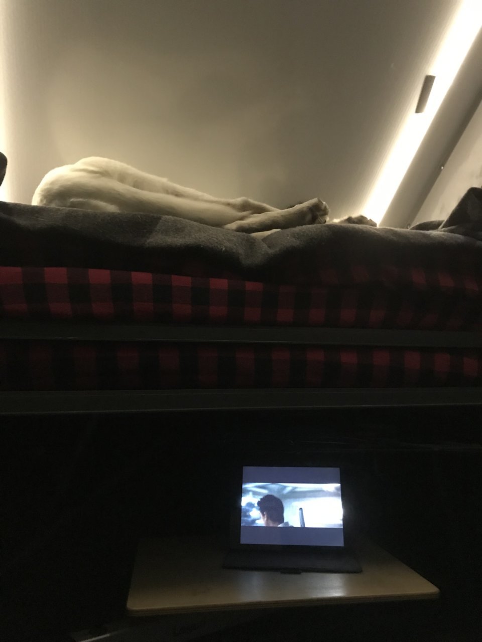

    This would actually be nice for us.
    We can sleep in the top and let the dog sleep down below in the bed of the truck.
    If we did that now he gets a little freaked out if he can’t see us. Mr. Protector likes to see his sheep.

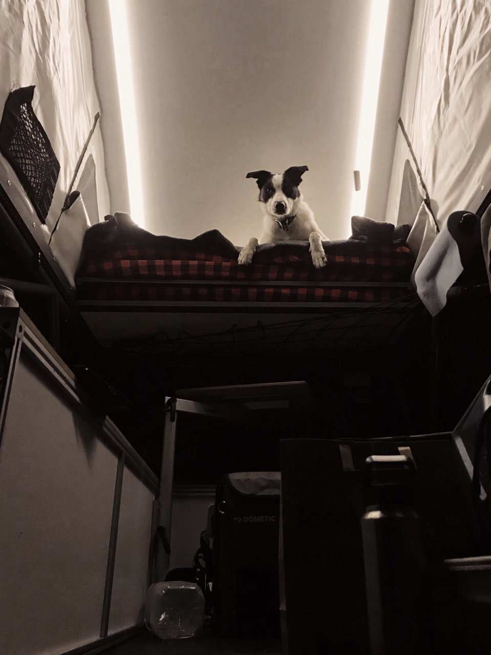

    You have to love the herding breeds.

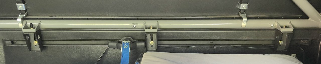

    I saw this the other day and wanted to say thank you very much for posting this. I had installed a set of Caliraised bed molle system and was worried that it might interfere with my GFC installation. With the measurements you posted I found out that there was going to be a problem, but with a little modification of the mounting of the molle, I could remedy the situation. Thanks again.

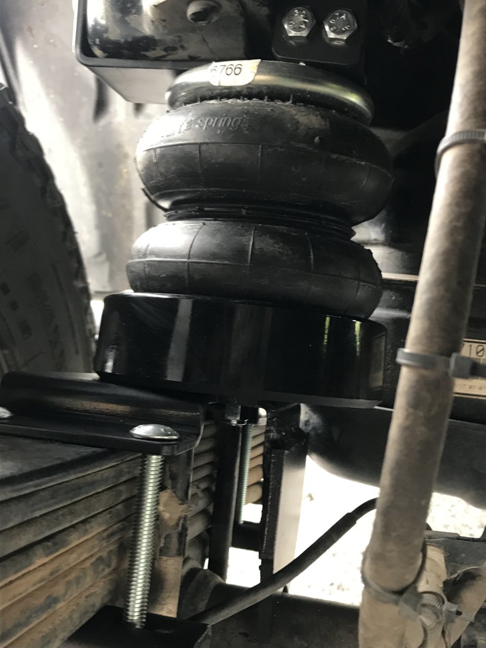

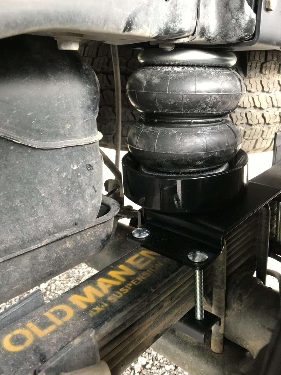

    I just bagged my truck this past weekend. Firestone Ride Rites...
    Install was super easy (much easier if you use your factory leaf packs!!!) i had to weld in an extension to mine in order for the brace to reach the axle (since my leaf pack is MUCH thicker) that said I really like them. Not sure they’re needed with just a GFC but weight adds up fast. FWIW mine is being designed around my new setup that’s in excess of 1000lbs hence the need for bags.
    I did the DayStar Cradles while i was in there too....
    Schreader valves on the back bumper
    Bags rest in DayStar Cradles for flex
    Welded on extension bracing.

    Nice write up on the Firestone Ride Rites. Great pictures too. When do you get the new rig?
