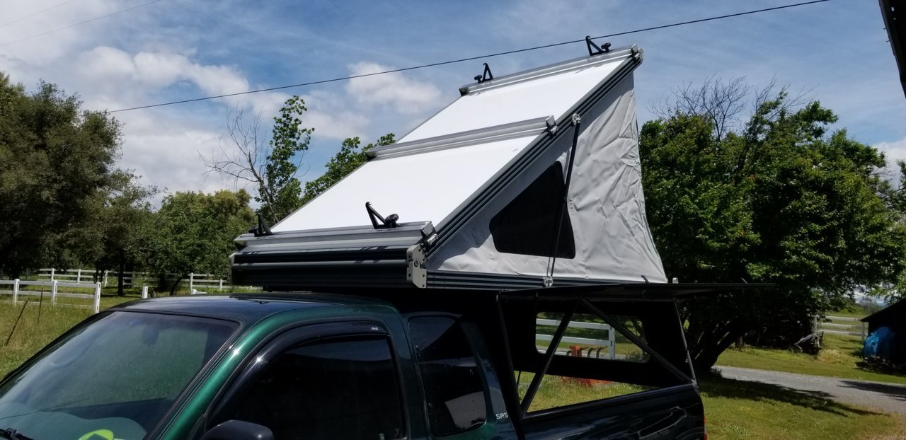

    I wonder if they will work with the bowed out extrusion on the roof? My roof varies in width quite a bit from the front of the camper to the middle.

    They may help pull it back into alignment!

    I didn't know if my roof was consistent when I installed my beef bars. I put on 2 bars first, one near the front and one near the rear. They were a pretty perfect snug fit. When I went to put on the middle bar the extrusion was about 1/8" wider so I disassembled the bar and first attached the bracket to the extrusion then loosely mounted the bar bracket which allowed me to slip in the bar. Then tightened all the screws to get it to suck in. If that all makes sense. 20190522_133151.jpg

    When I built my rack I had about a 3/4" difference from the front to the middle of the roof.
