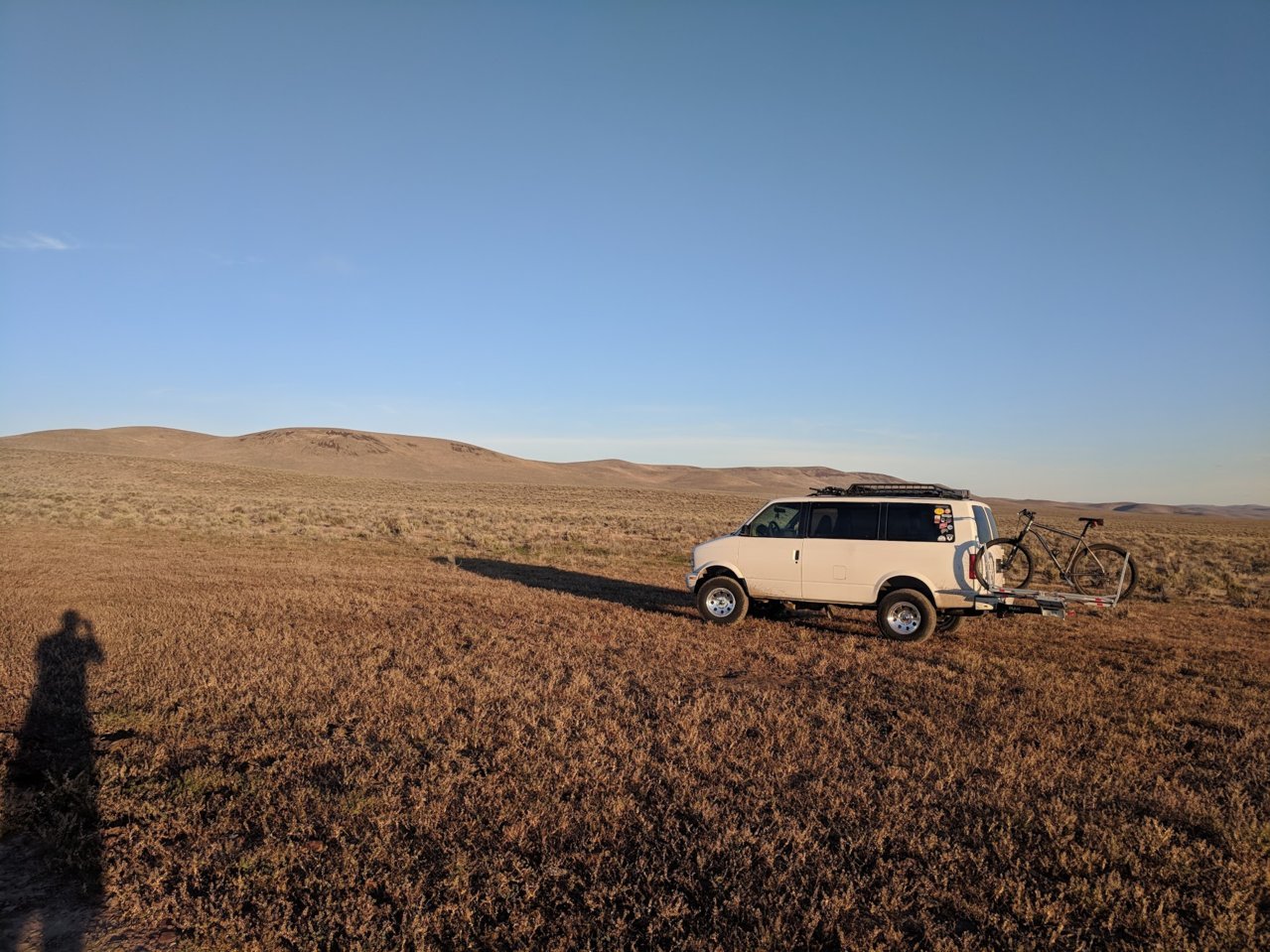

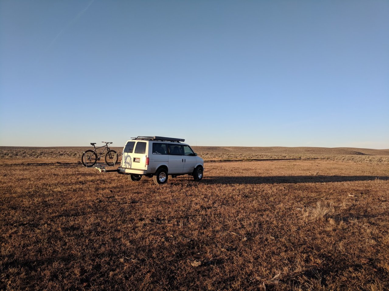

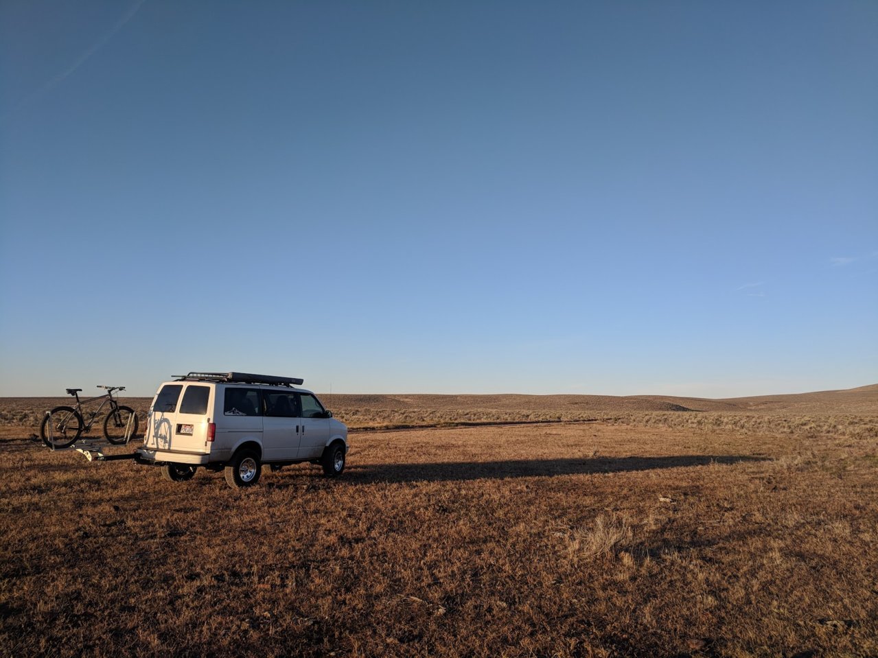

    Here are some shots I already have from when it was on my old van. DYdc1C7MCA3510YlniNHkU_-y8Wdk9igBwUZ6yg__9e93e5c8fc2d232203a322c8175213a690c51e0a.jpg 5nAK4Gqz-mf6O3N12spxVliGNJOjhk5Gofp57r5F_4fe3360651472fec7edd5d469d16efdd3f636dae.jpg
    If there's something else specific you'd like to see, let me know and I can go get some shots of it on the truck.

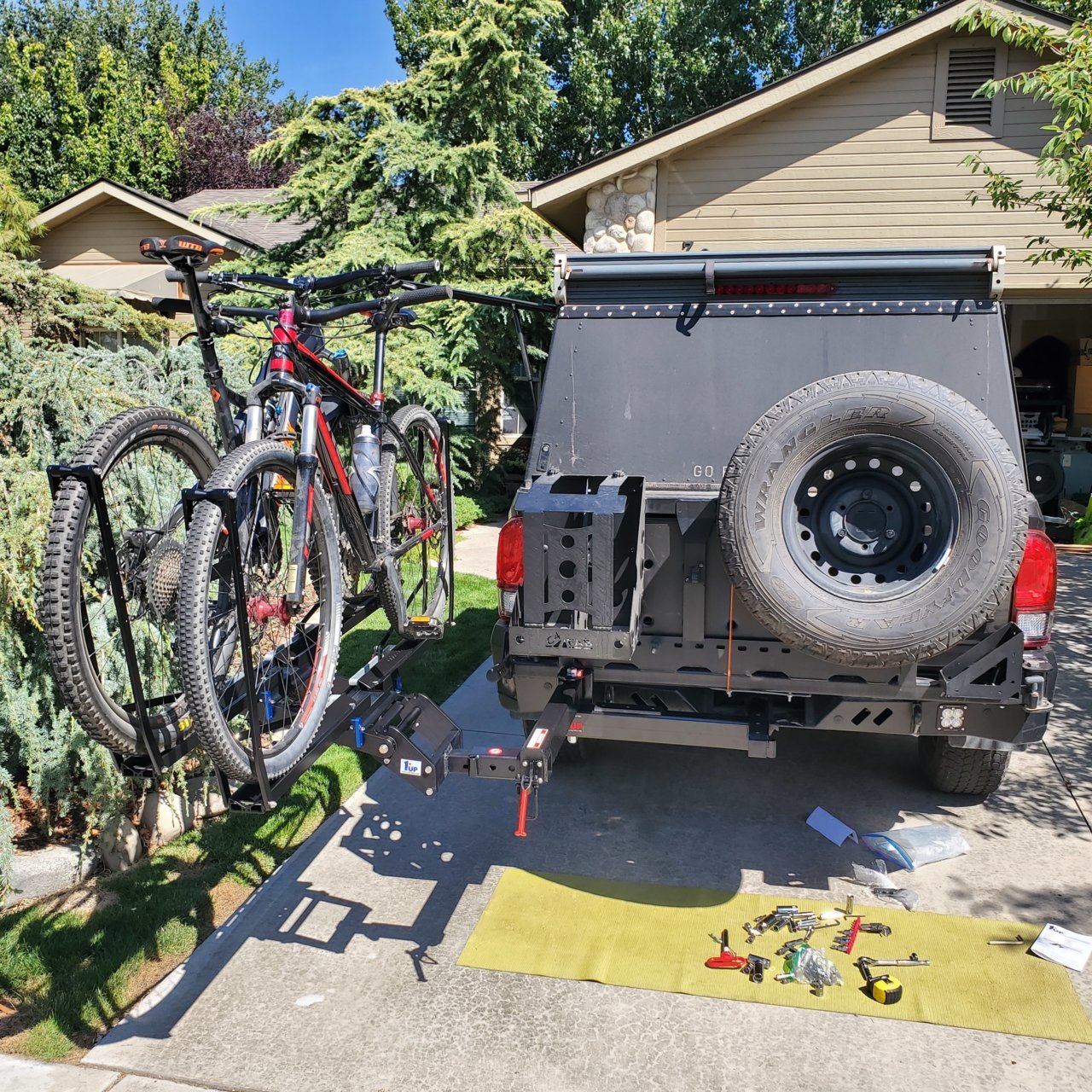

    I have a swing out and was planning to do the same as you, with having the bike rack swing to the driver side. Everything fit together nicely until I tried to open the tire/jerry can swingout. The rakattach sat high enough to prevent the swingout from opening. I'm waiting for Amazon to deliver a hitch lower (4 inches) to allow the swingout to open.

    Both valid points that I considered. I went with the drop hitch purely because I didn't want to have to find a shop to do it, wait for the shop, and then touch up the powder coat. My solution was as simple as 30 seconds on Amazon and a 2 day wait. I also didn't want to put another 125 lbs of weight on the tire swingout (2 bikes and rack).

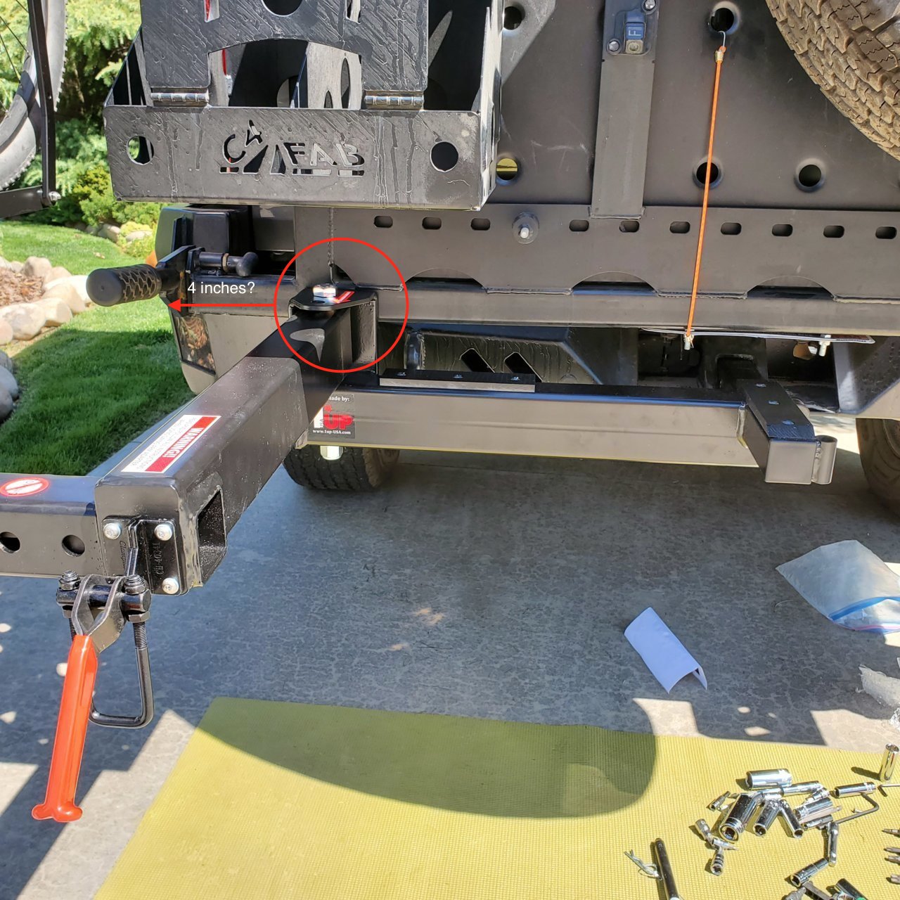

    I get that, but I assumed it was just hitting at the upper portion of the Rakattach pivot. So if it moved out a bit then maybe your swing out would clear around the pivot and above the lower, stationary portion of the Rakattach. Does this picture explain what I'm thinking?
    Obviously you have looked at/thought about your setup plenty, so I'll stop trying to fix things over the internet...

    Gotcha, didn't understand your original thought until after I posted, but I looked into that solution before ordering the drop hitch. It's more than 4 inches, about 8 to 10 if I recall. No worries, always up for suggestions and improvements.
    One reason I ordered the rackattach and 1up was because they have a 60 day return policy which means I have about 40 more days to solve my problem. Hopefully it will be solved tomorrow when my package arrives.
