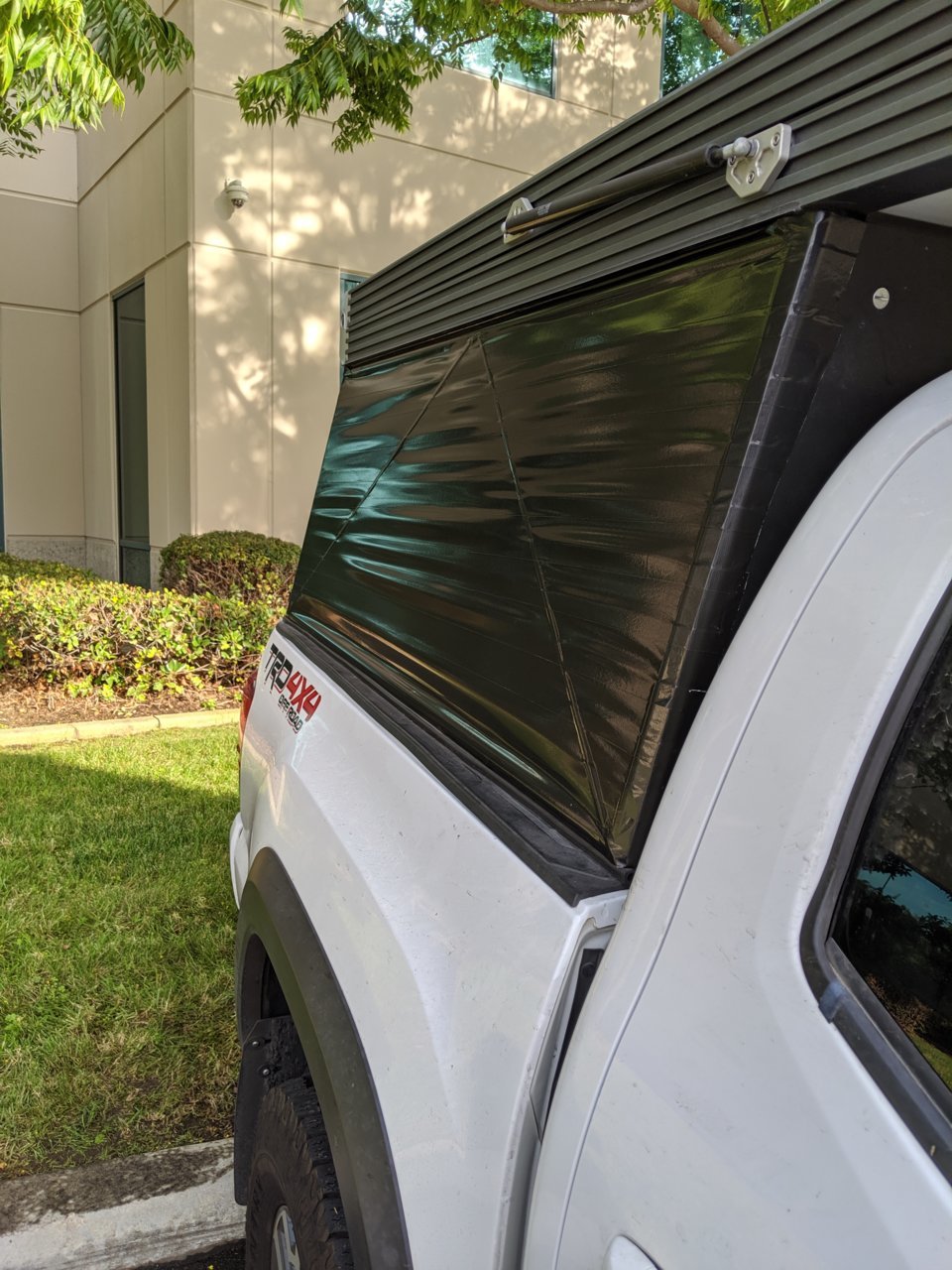

    When mine failed there was no warning and with such quickness it nearly hit me.
    I keep duct tape in the truck now just for this.
    I basically consider the hinges a wear item now. I'm just waiting to have to do it again. I give it a year.

    100% agree. I was not trying to blame temperature or customers but point out the flaw in material vs design as I see it (I am not an ME). It must be fixed.
    Potentially useful info for anyone else that has this happen, here is my field repair:
    1. Remove gas struts from door and frame. This was a pain with the wrenches I had. Place door in position, latch shut.
    2. Duct tape door in place front and rear. Ensure wind can’t get in from the front to peel it back while driving.
    3. Take 2 ratchet straps. Using the holes in the door where the gas struts used to attach, run a ratchet strap through. This holes may have sharp edges, line with copious amounts of duct tape.
    4. Attach the ratchet straps on the opposite bedrails somewhere.
    5. Ratchet tight.
    The door is secured from the inside and tight to the frame.
    Let’s be real, this has happened to many of us, it will happen to someone else.
    Edit: the field repair I did avoids the plastic panel like @pilosopo posted above.

    Plastic panel?
    That's pure duct tape, haha.
    I felt it best to not try and use the panel itself in the repair as the hinge dictates the vertical position of the panel on the frame. So without the hinge gravity pulls it down and the latches are useless. They're not really clamping onto the tube, just kinda pulling the panel towards the frame. On mine anyway.
    I was too worried about loosing the panel at some point, like after a bump on the freeway, and possibly hurting someone so I just left it off till I was able to do the hinge replacement.
    The duct tape sealed the opening because I drove with it open for one day and then worried about losing the rear hatch panel from wind hitting it causing a hinge failure. The amount of wind noise created from air rushing into the open side panel was alarming to me.

    :lalala:Hinges should not be a 12 month wear item. That is ridiculous.
    I definitely agree that driving with one panel missing is a bad idea unless you cover the opening one way or another.
    I just put up pics of my field repair in the tips and tricks thread. It held solid.

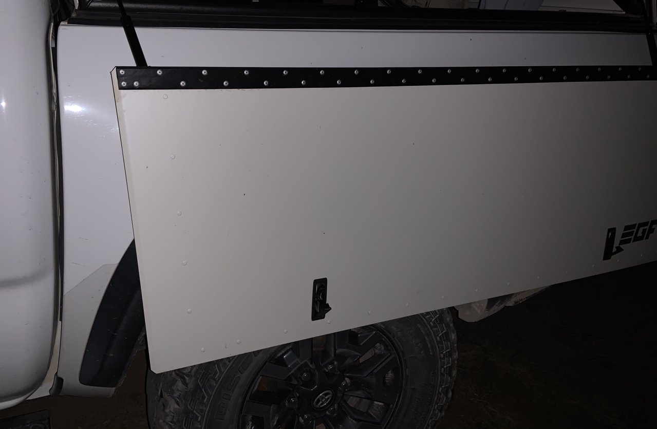

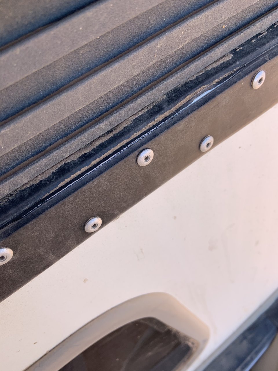

    Those gas struts are crazy strong for how light the panel is.
    Side panel complete hinge failure pic and rear panel partial hinge failure pic.
    Hobbs and mac_2_nite like this.

    Now that yours have failed don't you agree?
    The side that failed in mine was the least used side too.
    I'm sure it's a combination of uv, environmental factors and usage.
    Also, agree that the gas struts are crazy strong for the weight of the panel. I think they contribute some to the premature failure as they constantly out load on the hinges whether open or closed.
  7. Oct 26, 2019 at 8:50 PM

    I wonder if there are some significant manufacturing problems with the provider of the hinges. Mine have had no problems being used daily in subzero temperatures and sat outside in 24 hour sunlight with no UV damage.

    After having every hinge fail, I luckily got my GFC picked up and taken back up there on their trailer. It’s absolutely maddening to see all their production hub bub, IG contests, and pictures of others using theirs when mine has been deadlined for months. And they still say it’s user error, or blame sealant.
    The struts are for sure too strong, I’ve already researched replacements and will test them when I get the thing back someday. One more hinge failure and I’ll probably leave it on the 15 fwy on the way home
