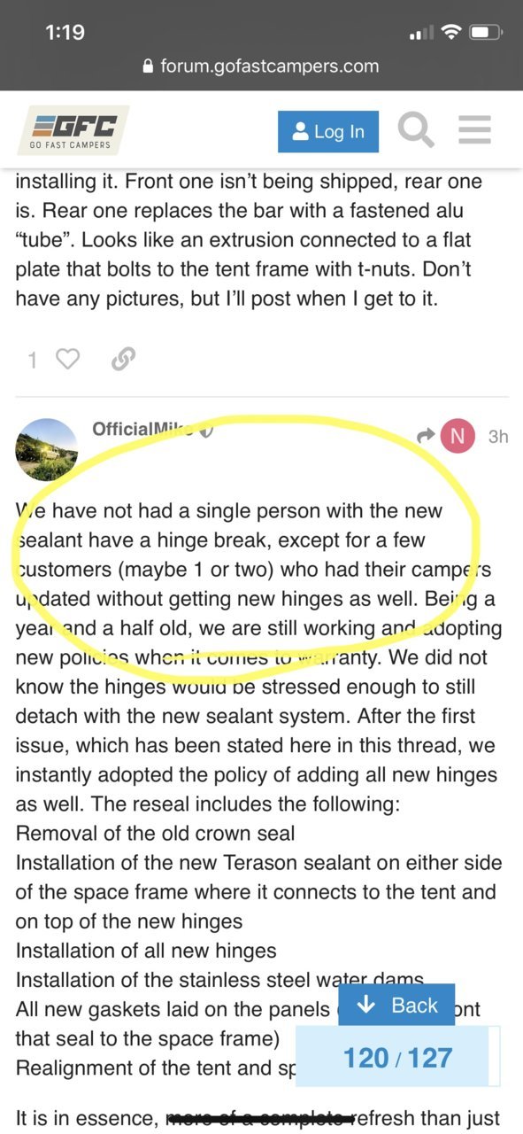

    As an outsider looking in, can someone help me understand what this means?

    My take on it is they’re saying the old bulb seal method stressed the hinges so that even once the camper was resealed they were weak and broke and that campers produced with new sealant haven’t had any breaks and original but resealed campers that were given new hinges at the same time haven’t had any breaks.

    Probably referring to the “not a single failure with the new sealant..”
    Then “except for one or two.”
    Can’t be both.
    IMO, more GFC nonsense trying to dispel the realities of their design and construction issues. Every point along the way they have downplayed every failure and claimed it was a handful. We know it isn’t, and never was.
    They get away with it, and they know it. Fast forward to the next big fail and rinse, repeat.

    Is reading that hard?
    Not trying to defend what he's claiming, but it seems pretty clearly stated to me.
    Camper came from factory with sealant - no broken hinges
    Sealant was added after the fact without a hinge replacement - a couple broken hinges

    100% agree that is what they said.
    I am still suspicious of the plastic hinges. They still were working before resealing.
    Time will tell. Six months ago no one had broken an original sealed hinge yet either. In a year we will know how the new seals and hinges perform.
    As an early adopter, I was willing to accept a functional but less refined design. I was not willing to accept catastrophic failure of critical components in <14 months of use. I consider the hinges critical components and the failures catastrophic.
