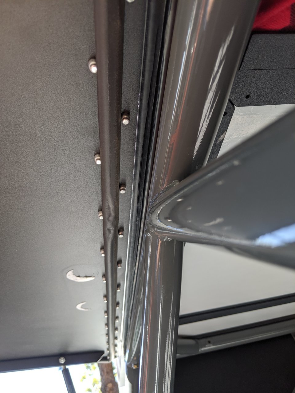

    Maybe the problem is the interface between the hinge and the round pipe frame. The interface with the extrusion is flat, which is good, however the other side of the hinge sits on the pipe. The roundness of the pipe creates a point loading on the flat and flexible hinge. The sealing helps with this point loading to some extent but it's not the optimum interface and its somewhat flexible too. Over time this creates stress in the hinge and its ~1 mm thick folding fulcrum.
    I'm not sure how the hinge is secured. The bolts that connect the extrusion to the frame must go through the hinge. Perhaps the hinge needs more of a continuous connection than those 4 ~5/16" bolts. Maybe the hinge is moving around just a little bit and over time creates cumulative stress. Maybe those relatively large holes in the hinge creates some weakness.
