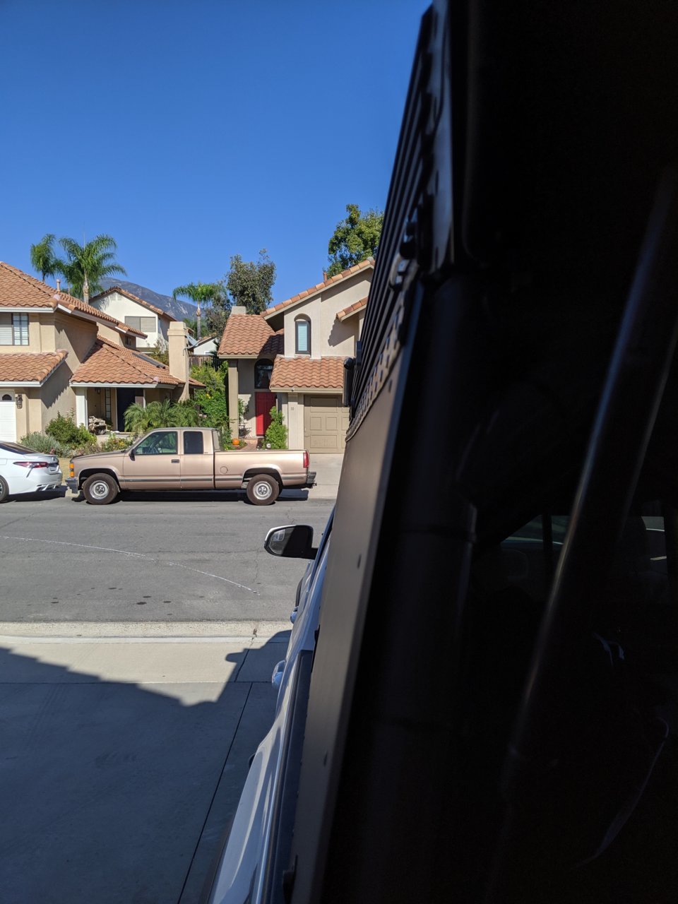

    But, it's definite that my panel has taken on some curvature while being installed. Probably a sign of struts that are too strong?

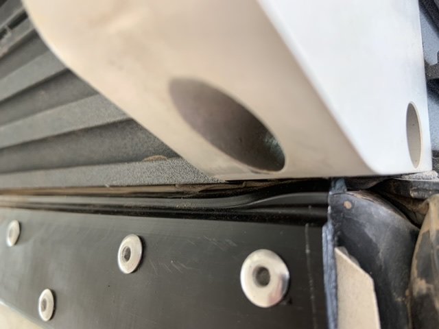

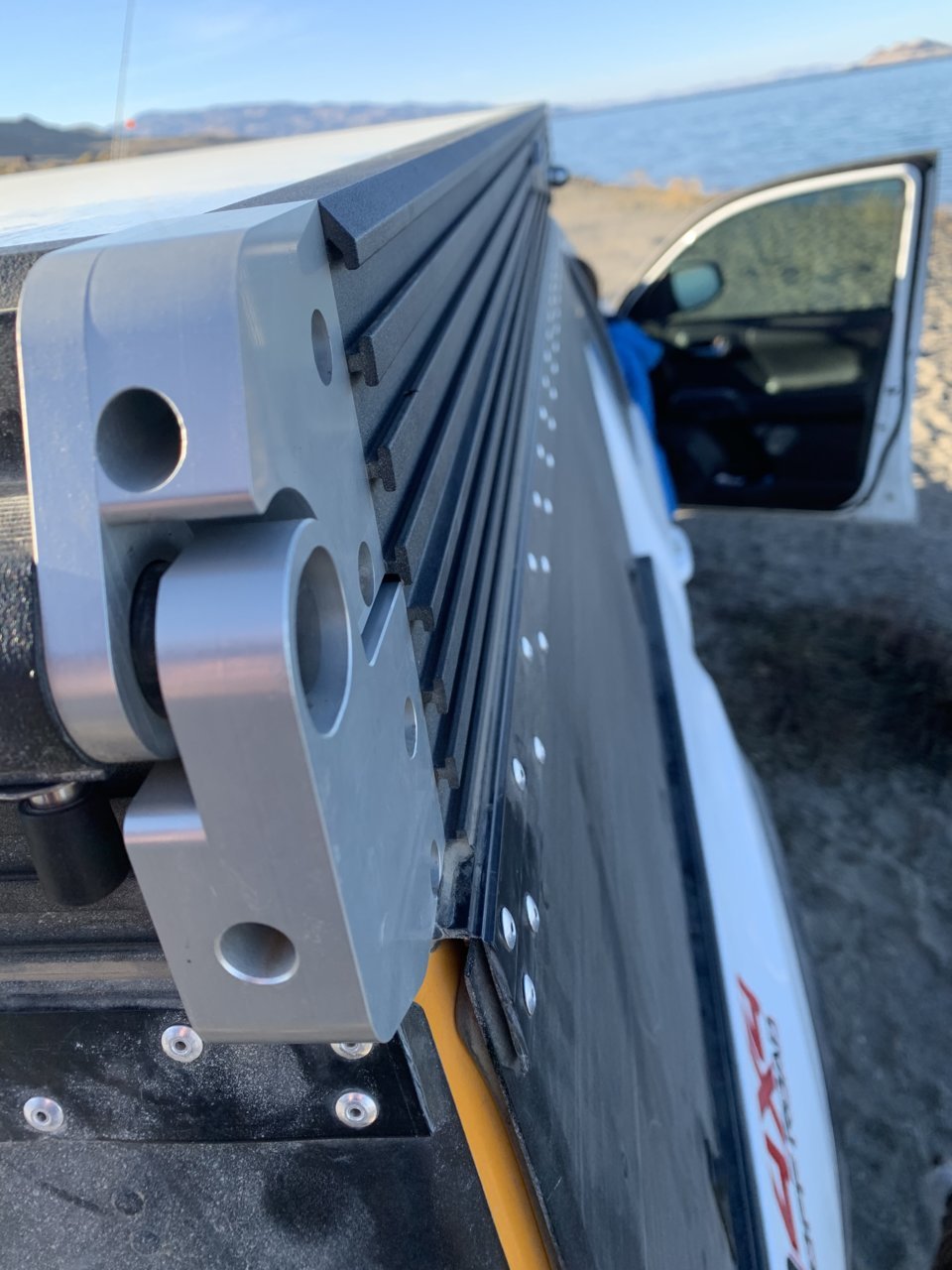

    Here is a picture of a brand new rear hinge sitting “flat” on the space frame. The edge is raised because of the welds where the three tubes come together at the corner. I cut all the bulb seal away to try and prevent this. It was like this before as well. I don’t want to take stuff apart again. I might to cut away the hinge portion that sits on the weld.
    I don’t expect this to last. I don’t see how a new sealing job fixes it.
    I looked at galley hinges online. I didn’t find any with the required range of motion due to the weird shapes that keep them waterproof.
    Name another camper held together by ratchet straps and duct tape, I’ll wait :smack:

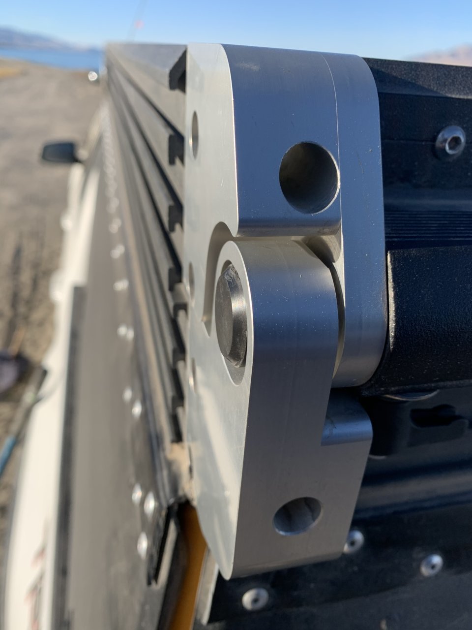

    Hopefully this will be of some value to those looking to replace their hinges with perhaps something different.
    I honestly don’t know the name of this particular hinge but this is what’s used on my new camper. It is extruded and bolting into place and looks very straightforward to replace.
    I’ve never heard of any failures of these hinges, granted there is maybe 10% of the volume of these as compared to GFC and they’re distributed around the world.
    Bottom line they are still plastic and seem very robust. Only thing is they are 100% mounted square and the way they are built they’re boxed in so no UV light effects them on a normal basis. Finally the struts on this new one only open 90 degrees so maybe that would help too.
    Anyway just putting it out there that GFC isn’t the only camper using a plastic type hinge and these are built for the African Bush rental vehicle market by a company with decades of experience. It’s still a viable choice if properly executed. Let’s hope there’s a better option that comes along and we get these all fixed up right!
