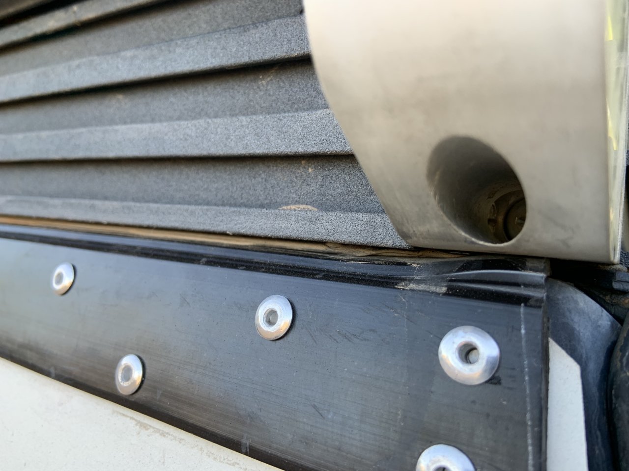

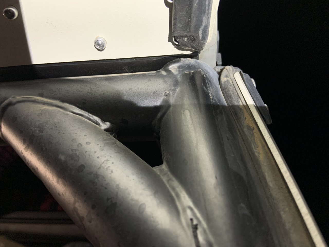

    The hinge saga continues.
    Early builds don’t just need a reseal, they might need the frame ground flat as well to provide a flat surface for the hinge. This is according to the gfc forum.
    :deadhorse:
    Here is what my rear hatch looks like with no foam seal under the corners. The hinge corners are lifted by the welds. Both corners are lifted simultaneously but I only attached pictures of one. No amount of sliding the hinge left or right will solve it.

    It’s really starting to seem like square tubing for the frame would have saved a lot of headaches over the round tubing.

    Original design was for canvas like a soft topper, so round tube made more sense. Hard panels were a decision made by majority vote when the CAD was released on TW.
    This may sound shocking, but it’s almost as if it wasn’t designed properly despite the “team of engineers.”
    Beginning with the frame, and disintegrating from there outward.
