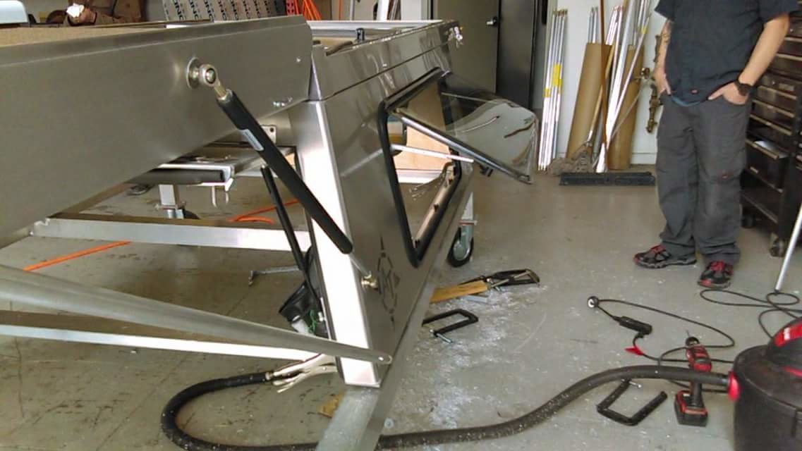

    That's so slick! I didn't even know such a thing existed. For large quantities of parts the time savings, and repeat-ability is going to be huge.
    Is welding the frames together going to be the slowest/longest step now? Or will it be tent sewing?

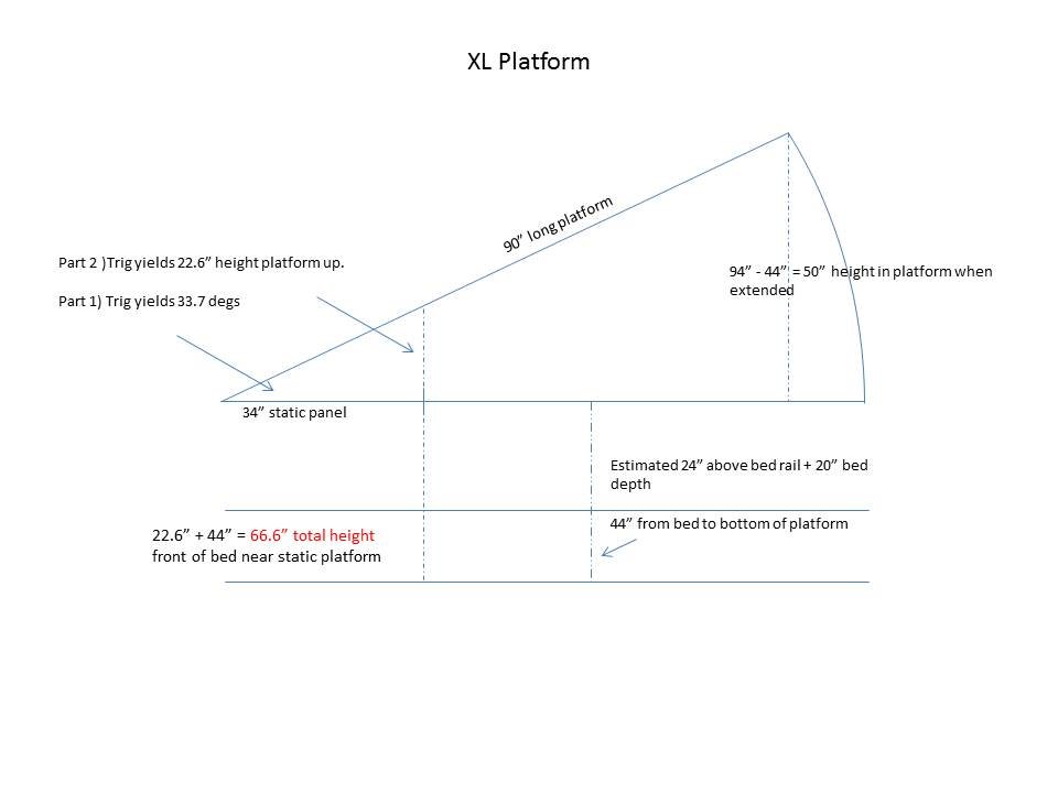

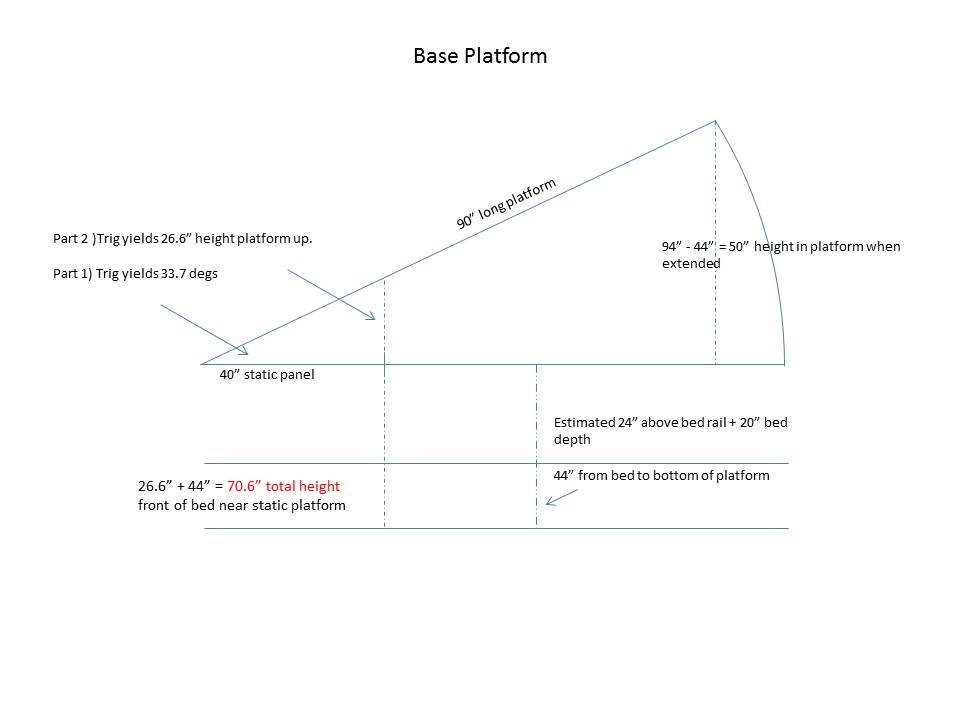

    Think you forgot sketch. I roughed the numbers a bit:
    90" platform length
    94" Max interior height (at peak)
    24" be rail to top of sleeping platform mattress (pivot point)
    20" bed rail to bed height (I called it bed depth)
    50" of removable opening (Base model)
    56" of removable opening (XL model)
    Really ugly without my CAD machine....but here you go. PS - I'm running on little sleep if I fudged the #s :fingerscrossed:

    Nope... told you i likely goofed. Redoing the numbers.... didn't really change

    Actually thinking about it, I bet the hinge is actually above the mattress, first drawings are likely more accurate... I'll delete prior post

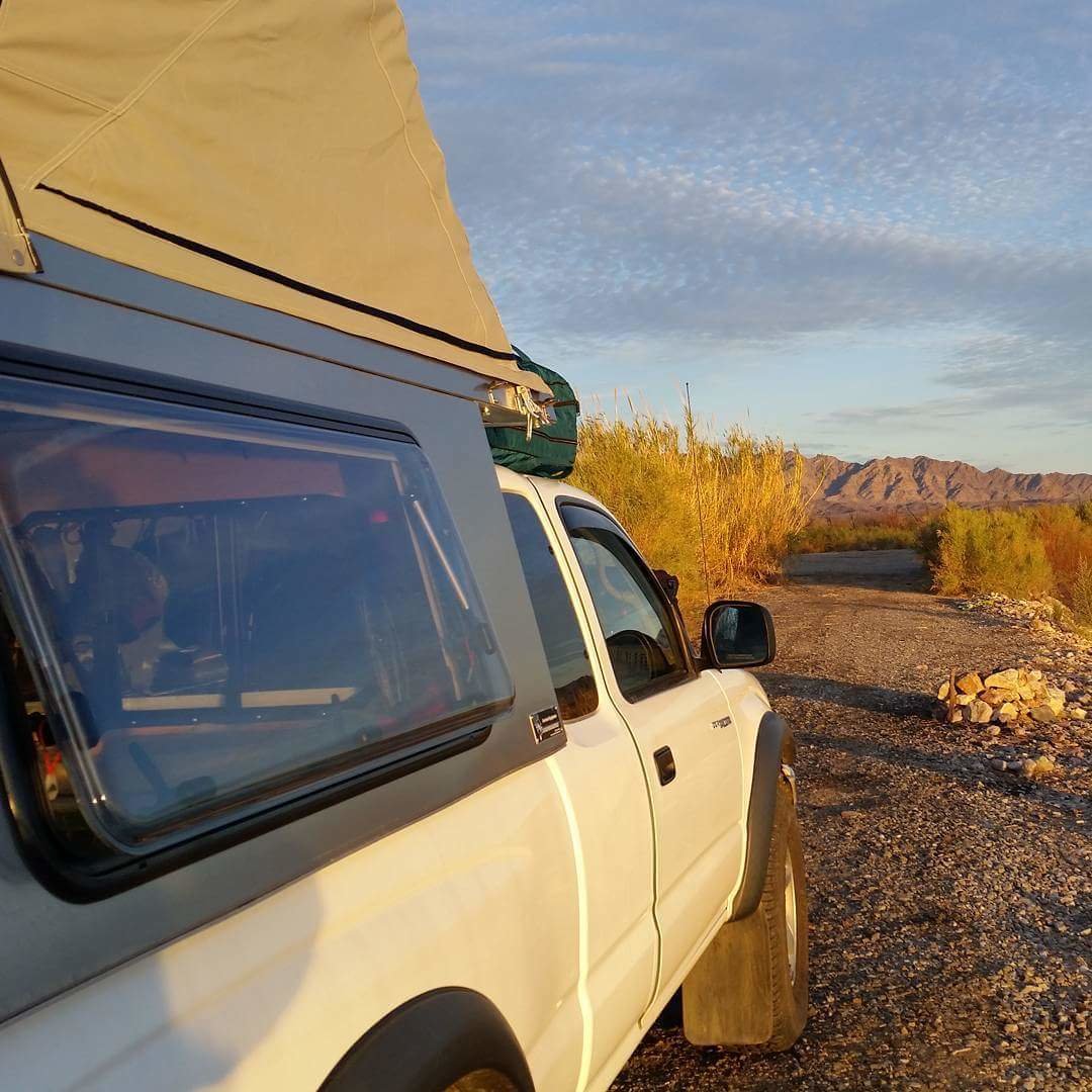

    This style window might be a suitable option for the sides. It doesn't look like too much intrudes beyond the side panels to interfere with the framing.
