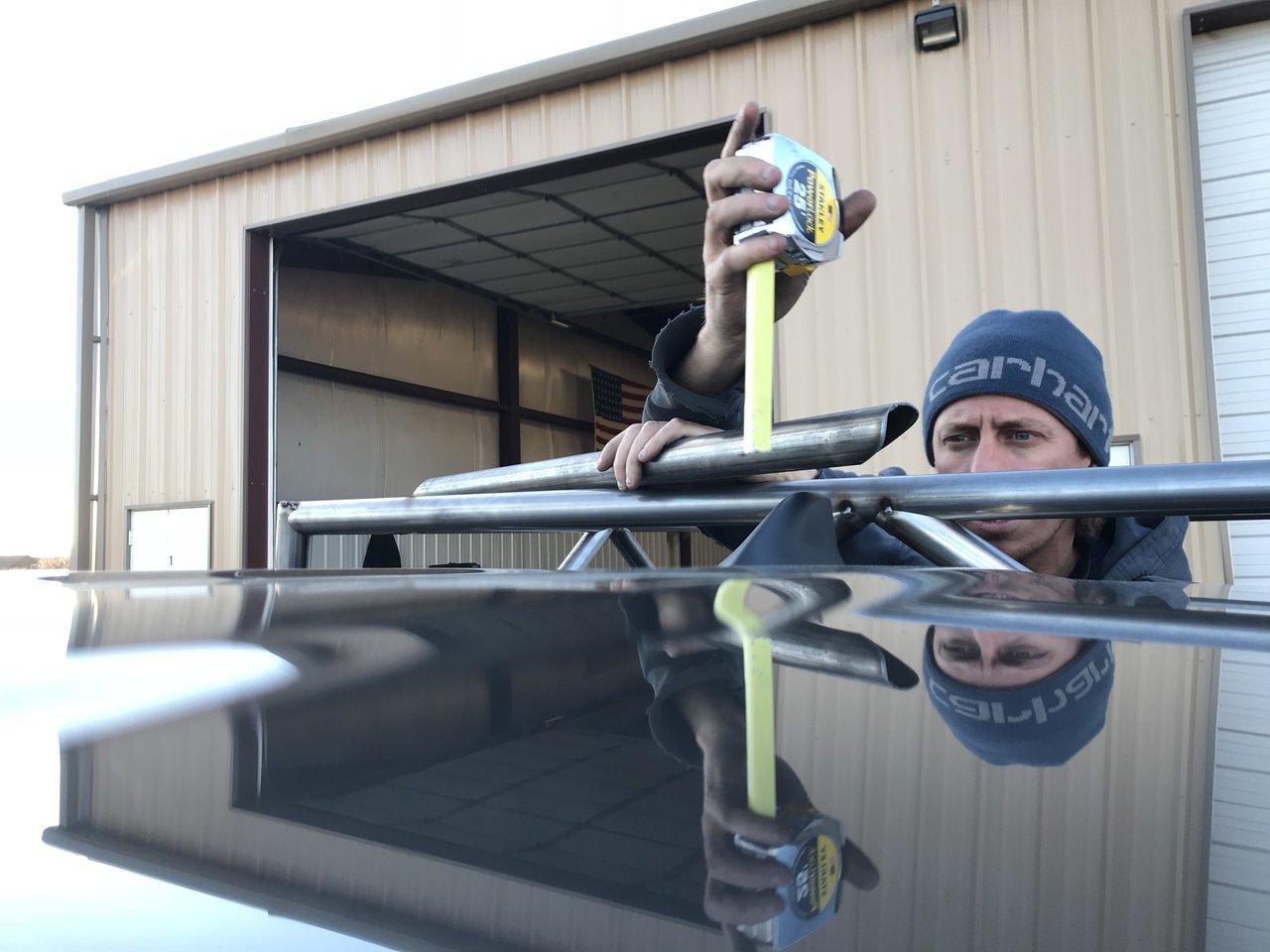

    Ever closer... and Wiley may or may not be sizing up a short bed

    I do hate it. Or more specifically, I hate the hole underneath it.

    The Colorado one is way worse, so at least theres that...

    It’s really not. I can get mine smaller than the fin with a stubby or relocate it so it’s just the base. Either way they all suck.

    Thats the solution I think we are going with, the stubby antennae. I just meant the factory one is worse.

    Would’ve been nice if they just stuck with the little puck style antenna on the roof like my 2011.

    Can the fin be replaced with the pre-fin version? On my 09 it is a much shorter rounded square piece.

    Might be that someone has commented already, but radio reception is usually from the horizon, while XM is usually from up above.

    Graeme or Wiley can correct me if I'm wrong, but from my emails with Graeme about my order he said they will be designing it around a stubby antennae. He never specified which version, but I would assume the Jr. is the version is what they will be using. I expressed my intention to keeping the design tight to the roof line. If you measure out a stubby plus the base at about a 60° angle you get about 2.5-3 inches from the roof line. That puts the potential design at roughly 3.5-4 inches from the roof to compensate for movement of the bed and camper. We'll have to see the final Taco design and then compare to the Rado one. They should be pretty similar in height. The Rado base is roughly 1-1/4" from the roof line. The only other idea I had to get around it is to machine out a notch where the antenna is, but that depends on the wall thickness of the camper and if that would make it a weak point for the camper as whole. Last thing you want is a crack to propagate there.

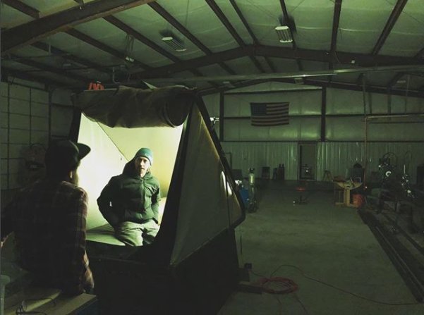

    keeping the overhead down... no heat, and only task lighting! LOL

    RE: COLORADO STUBBY ANTENNAE
    The current plan is to design around the stubby jr. It seems to be the best balance between getting the height optimized, price, radio reception and ease of install. All campers are specifically designed for the truck they are going on, so there is no universal fit/cab rake/overall height etc.
    I have a Stubby Jr. on order to install on a truck at the dealer, and I can pull measurements and keep you all up to date. Good to know the Colorado guys are watching. Its a neat platform, excited to see one of these together.
    If the stubby unit is an integral part of the GFC camper fit, we will probably go ahead and have some in inventory to ship with the camper unit so install/procurement is easy.

    We got a killer deal on some NOS russian surplus night vision goggles, definitely helps with the electric bill.

    Nah. I run cold. If it dips below 65 degrees I wear a jacket :)
