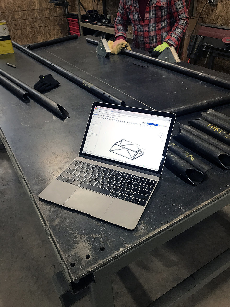

    22" for the 3rd gen. For the 2nd gen there may be differences in the lower frame shape. Once we have the lower details worked out for the 3rd gen we'll apply those to the other supported truck models.
    On a progress note, we got the tubes laser cut for the lower frame yesterday, so will have some update photos this weekend.

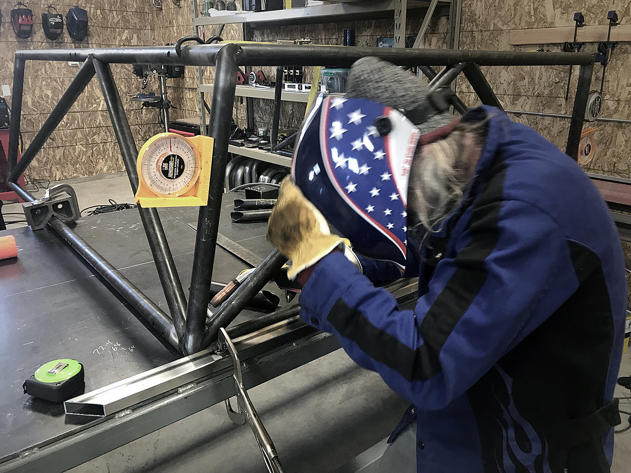

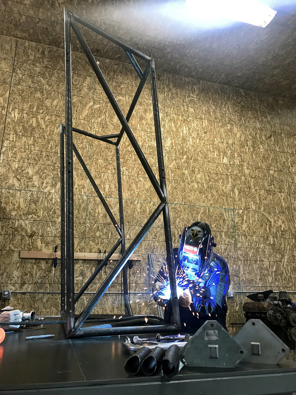

    Welded up a couple of Tacoma long bed lower frames today. Unlike the square tube on the test mule, these are 1.5" round DOM tubing and made to the final design specs. We'll be skinning these in bead-rolled .090" aluminum this coming week.
