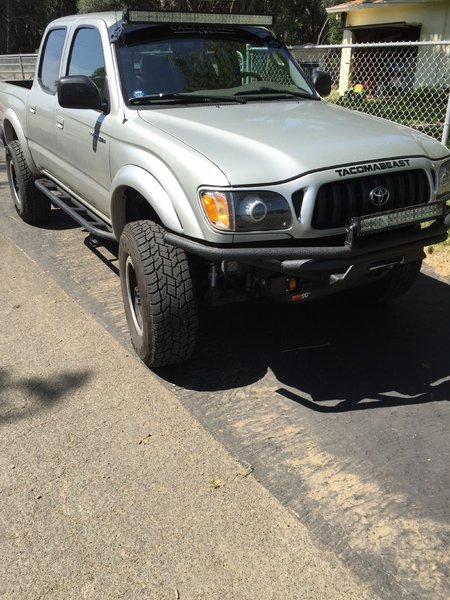

    Hey Taco as we know, blinkers are required and yes I cut some off, but very little and was not necessary. The TG winch did not fit very well at all, and had to cut into the grill to fit. The winch is another reason I had to place light bar where you see it. Perhaps one day I will rewire winch and place the light bar inside where it should be, although the light is amazing lol.

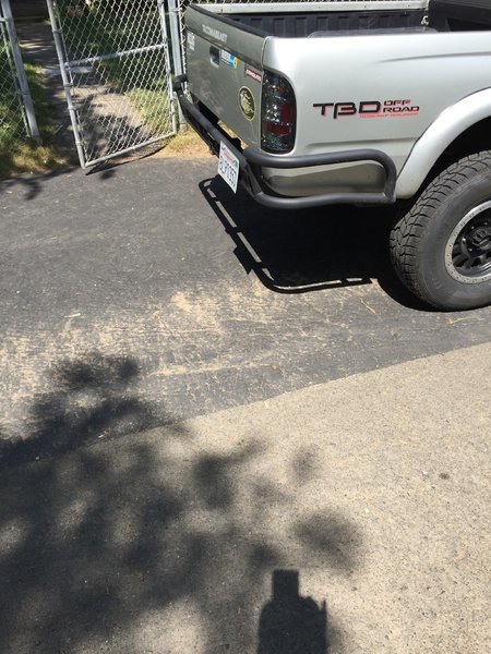

    Here are my TG sliders & TG rear bumper. I Raptor lined my front bumper but primed & painted the sliders & rear bumper.

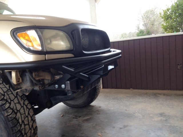

    Hi @Tacotruck7, this bumper is not the best choice if you think you might return your truck to stock form in the future. You don't HAVE to cut off any extra sheet metal or the stock bumper mounts if you don't want to, but it would look really bad:
    There would also be a big white washer fluid reservoir hanging down right there as well. I'm guessing this person has removed the reservoir and was in the process of deciding what to trim off when the photo was taken. There are also large chunks of plastic inner fender liner that need to be cut off. That ugliness right there is why I went through the trouble of cutting metal, re-routing wiring, relocating blinkers and finding a different washer reservoir that fit in the engine compartment.
