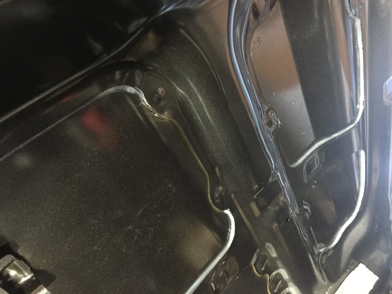

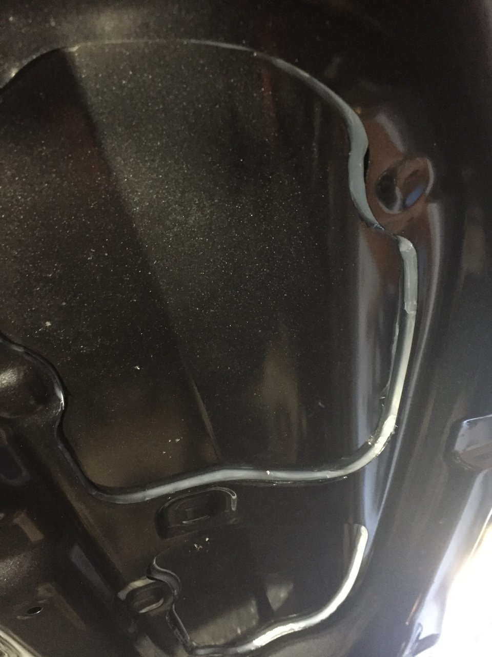

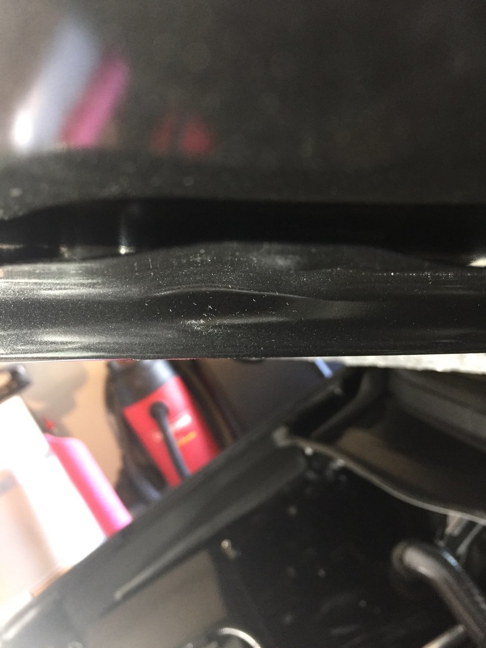

    8E0E148C-33AD-4FBC-985B-E9902F28FABB.jpg 77B7AA1C-6691-4F2E-A8BA-1F3163F5DF79.jpg 277D9AC2-F1D0-483C-BFFB-DAEE87426791.jpg Mine is a summer of 2017 build in Mexico. One 3 inch diameter blob of glue was on the right side of hood but left side blob was missing.
    My hood was fluttering on driver side while driving into wind at 40 mph.
    It was easily fixed with a $5.00 Tube of GE silicone I had in the garage. Good for over 400 degrees.
    Easier than going to dealer and better than doing a new hood or repaint.
    No more flutter. The silicone dries clear. No worries about hood bulging when using foam.
    Picture is during application half way done. I went over it a second time to fill in all gaps in hood bracing.
    Last picture is side of large center hood brace with missing glue blob location.
    My neighbor has a Taco built in Texas at end of Summer 2017. He has small 1 inch blobs of glue on his hood.
