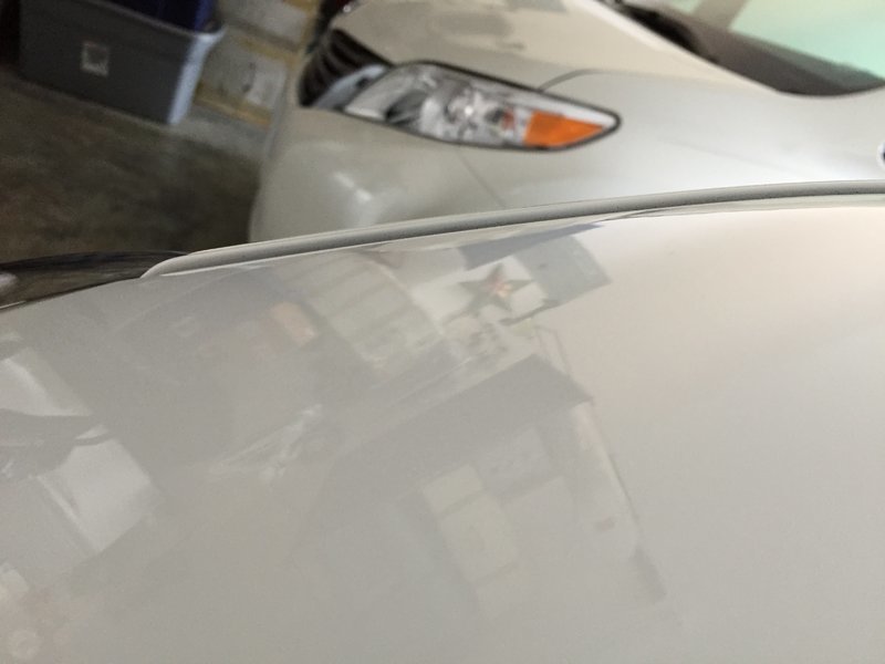

    Hi all, just curious if anyone else has noticed the hood of their 3rd gen sitting lower than the quarter panel edge? I hope I've explained that right...the edge of the panel is sitting 1/8"+ higher than the hood and it's driving me crazy. I've attached a pic as well.

    You can adjust the hood by rotating the round rubber bumpers underneath

    Adjust it with those rubber stops under your hood, just turn them to you get it close.

    Adjust the hood screw up 1/8"

    Well dang! You guys are awesome! That fixed her right up! Thanks for all the replys!!!!
