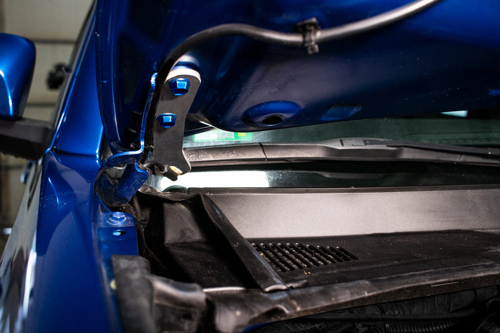

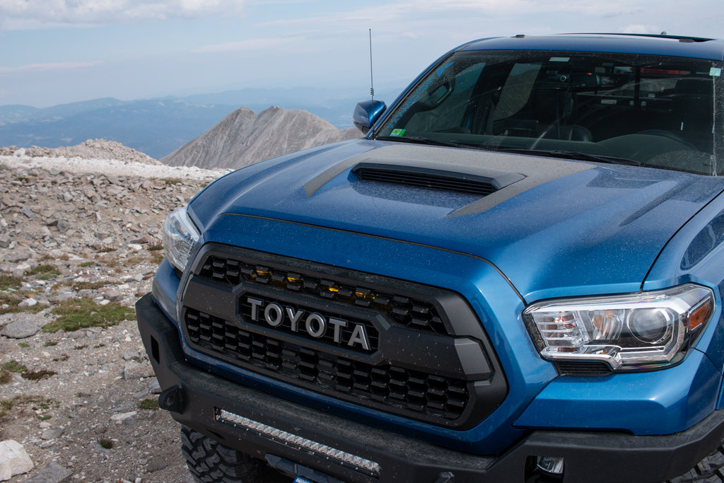

    I wanted a place to mount my 1/4 wave HAM antenna that didn't scream "HEY I'VE GOT A RADIO IN HERE." Since we don't have an external FM antenna, the hood seemed like a great place.
    After about a year, I'm still super happy with it, and enough people have asked that we decided to make it available. It's designed to use NMO style antennas which are available for all sorts of wavelengths, including CB.
    Free shipping to your door in the lower 48.
    https://www.victory4x4.com/product/VT3CB-BARE.html

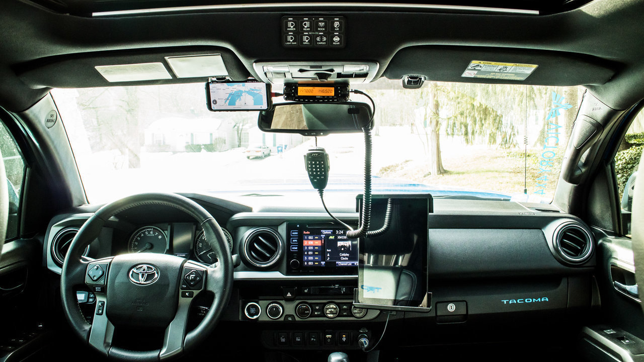

    Just in case you are curious, these are the parts in my com setup:
    TYT TH-9800 Quad Band Mobile Two Way Radio
    Victory 4x4 Antenna Mount
    PCTEL BMATM3-NC NMO connector
    Tram 140MHz-170MHz + 430MHz-470MHz Dual Band NMO Antenna

    Very cool. I'll probably go this route when my callsign gets issued. Welcome back, FCC!
    How is your phone mounted up there, just a suction cup on the windshield? I hadn't thought of mounting it up there.

    Magnet mount: https://www.scosche.com/magicmount-peeloffdash

    Serious Question. Will the Antenna survive a drive-thru carwash? if not i'll probably mount it in the bed behind the rear window.

    Yep, that's the one.
    Yeah, I go through an automatic all the time.
