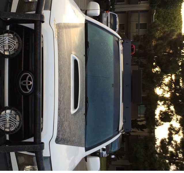

    All, in order to get a decal to yield straight edges after being stretched/heated/shrunk to conform to the contours of a scooped hood, the exterior lines would need to account for whatever distortion the process creates (ie. nearly impossible). To do the hood blackout mod on a TRD Sport, order your vinyl over-sized, then use knifeless tape to lay out the exact shape you want, install your vinyl over that, then use the tape to cut the outline from behind. Having DIY'd this myself, the one thing I'd say is buy premium vinyl and tape, and install the knifeless tape securely before using any install spray. Ideally, I'd keep the spray a good inch or two away from the tape so it doesn't inadvertently shift during the vinyl install.
