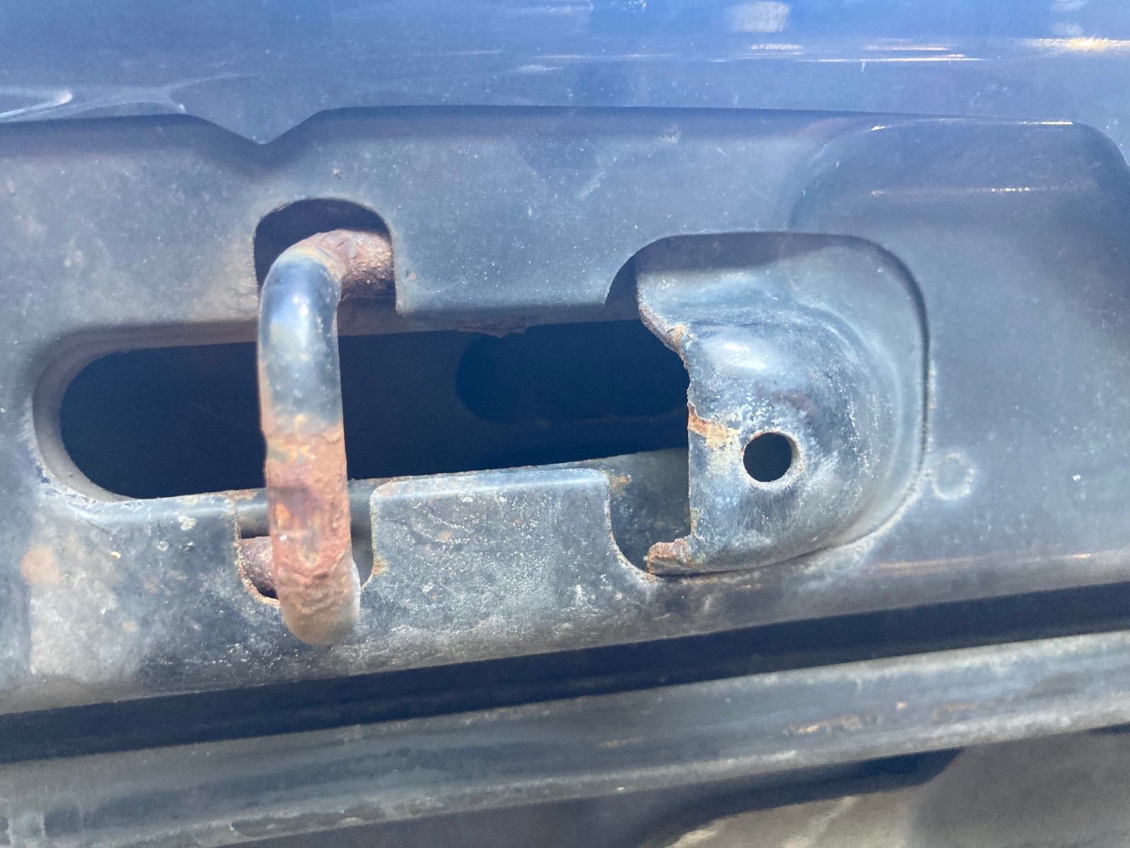

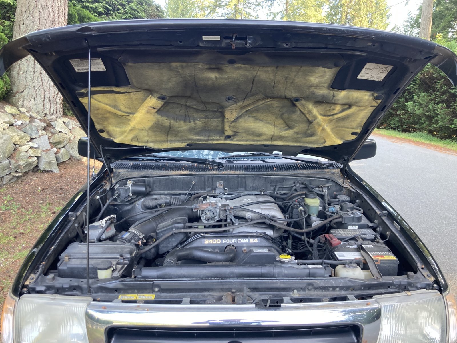

    When ever i have someone in my 98 Tacoma truck they say my hood is loose, especially when on the freeway. It is latched and never pops up or anything just has some play in it (1/4 inch?) goes up and down. I took a photo, is there supposed to be some rubber discs or something taking up the slack? I am not a mechanic or anything just wondered what it is missing. It should be solid I thought.

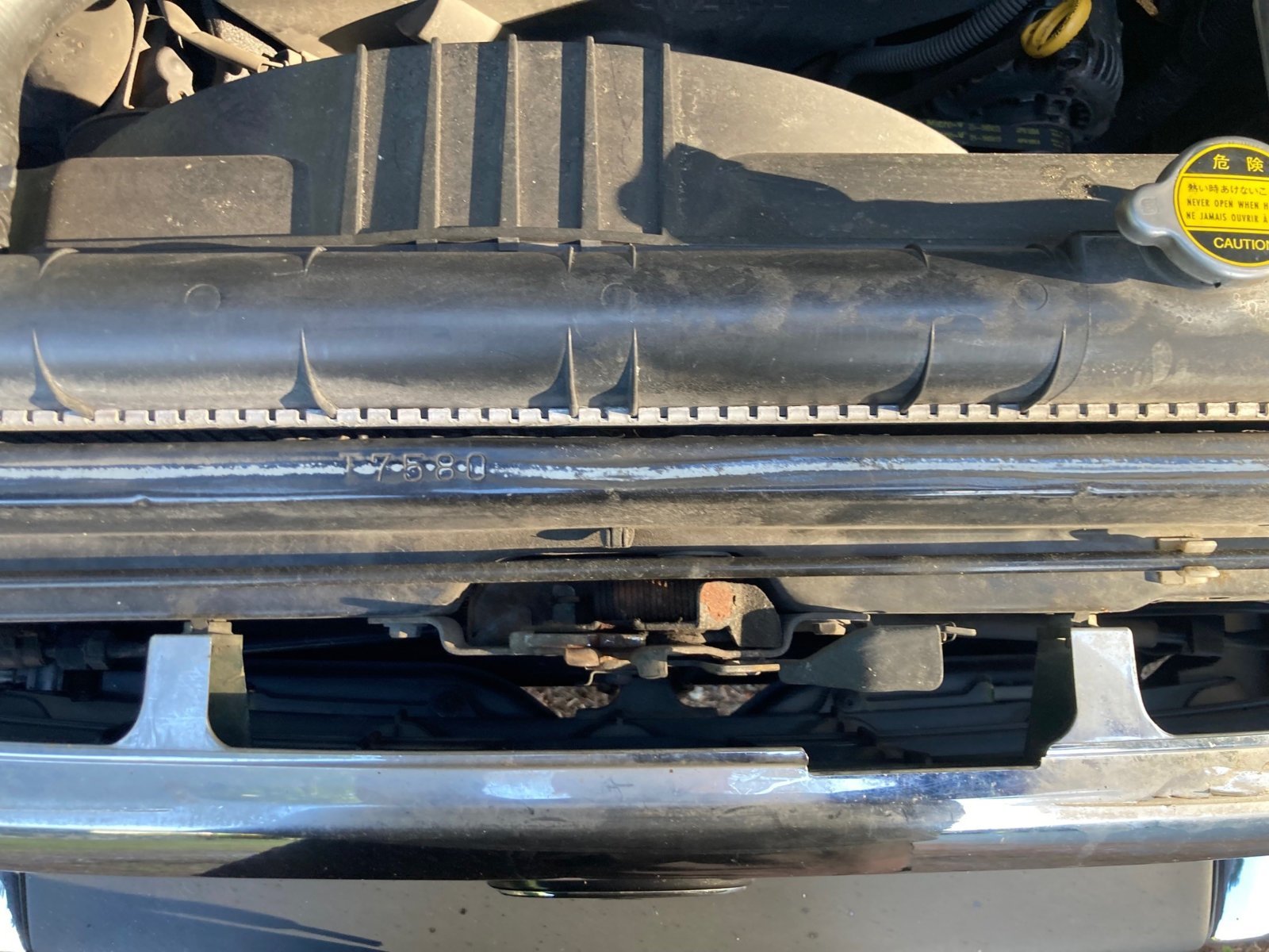

    1-adjust/lube latch
    2-sand some of that rust off the hood striker

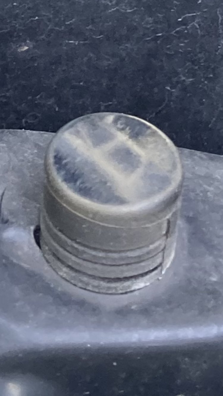

    3-use those adjustable grommets to hold hood properly (the circle in the thread pix^^^)

    Ah... I think I do not have those rubber circles or they are not adjustable or anywhere near the same height as those and that would take up the slack. I will look when I get home. Will also sand and rust paint on the latch. THANX

    How is the latch adjusted? It seems solid in place.

    3 bolts
    if your hood is bouncing.....
    need to loosen(not take off fully) the 3 bolts
    and tap the latch down a lil bit
    tighten 3 bolts and see if hood shuts snuggly
    this process might have to be done a few times to get perfect
    then use those rubber grommets for final adjustment
    hell
    you- might be able to make those adjustable grommets as high as possible and then hood wouldnt bounce
    i would recommend going thru the adjustment steps thou

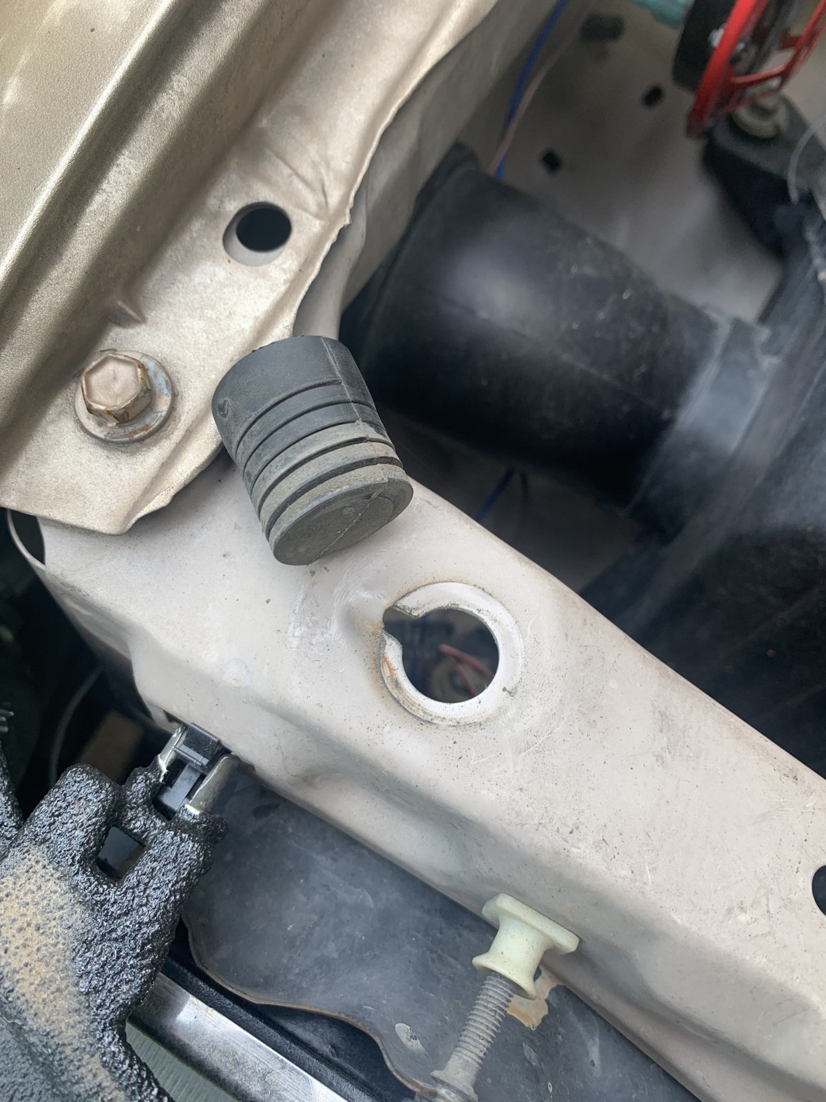

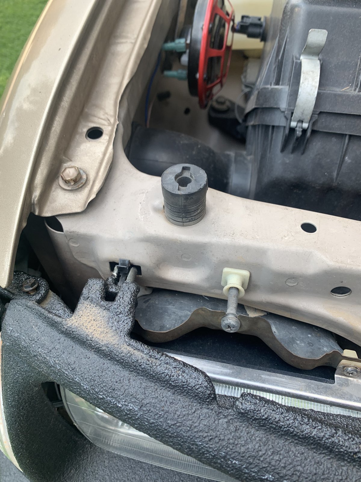

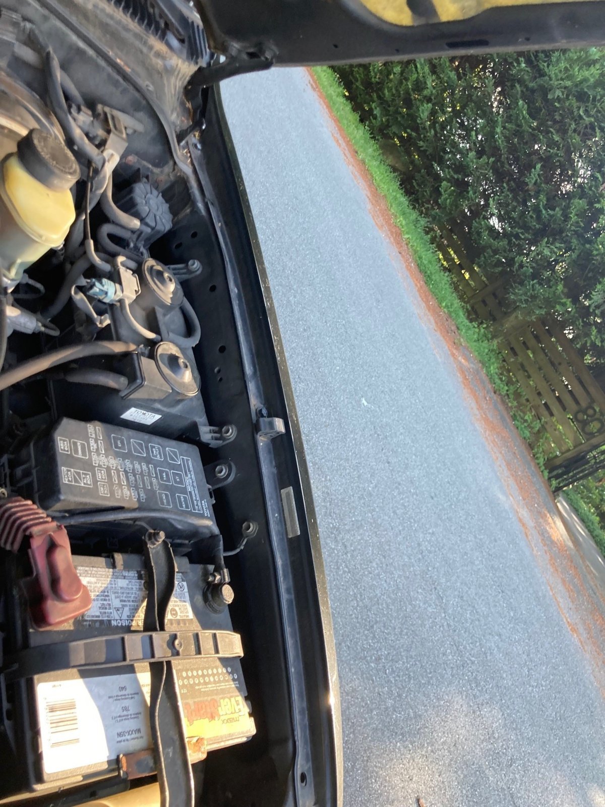

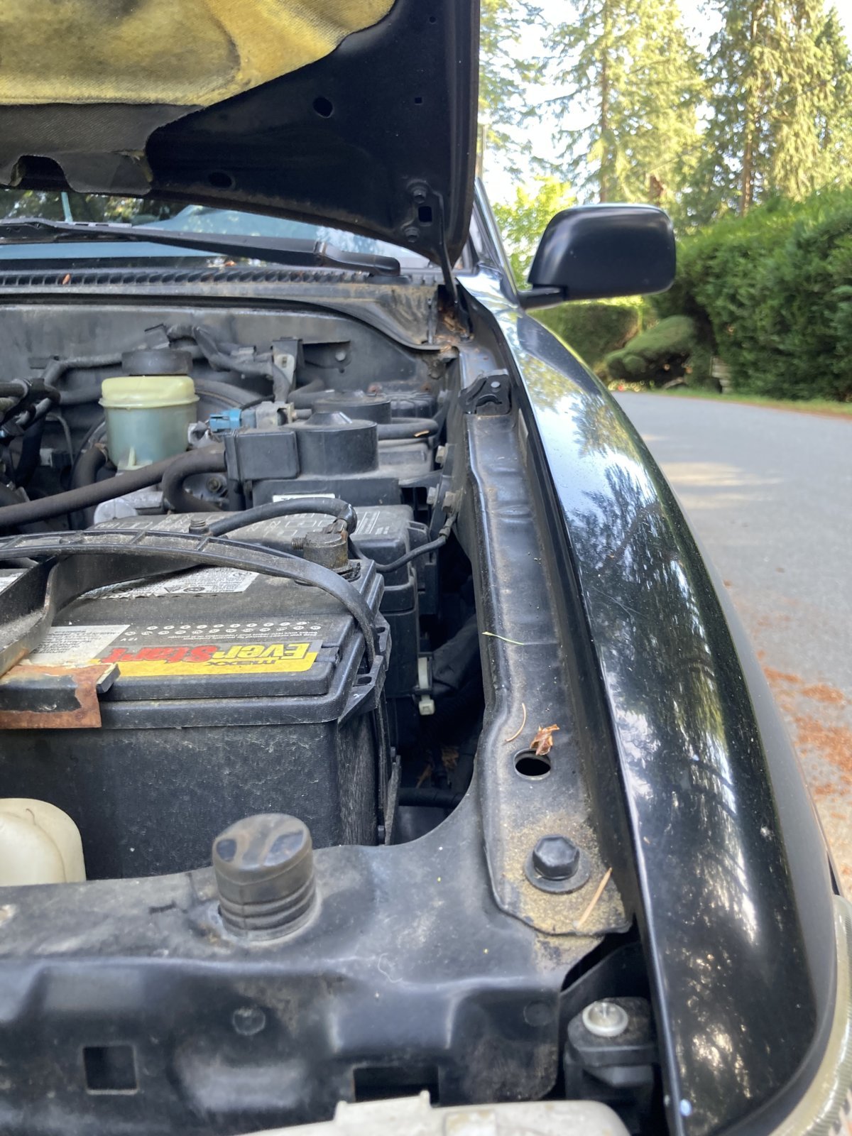

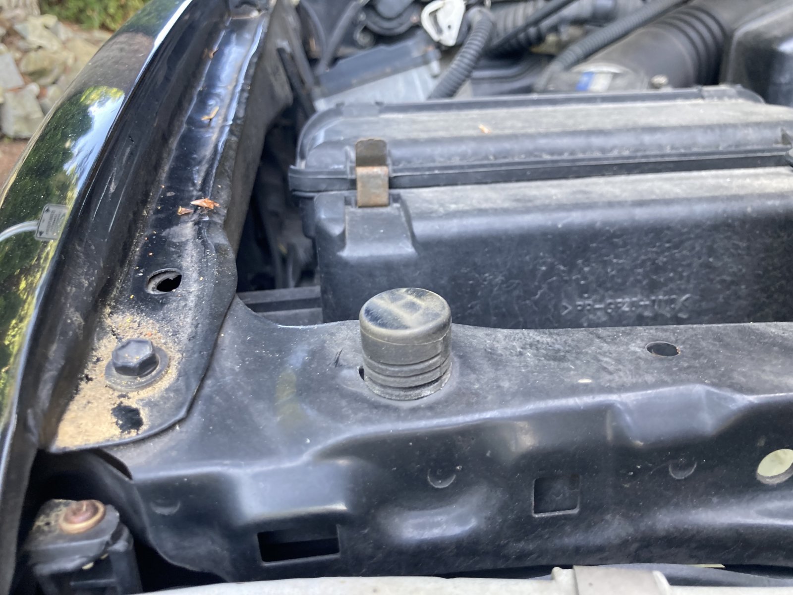

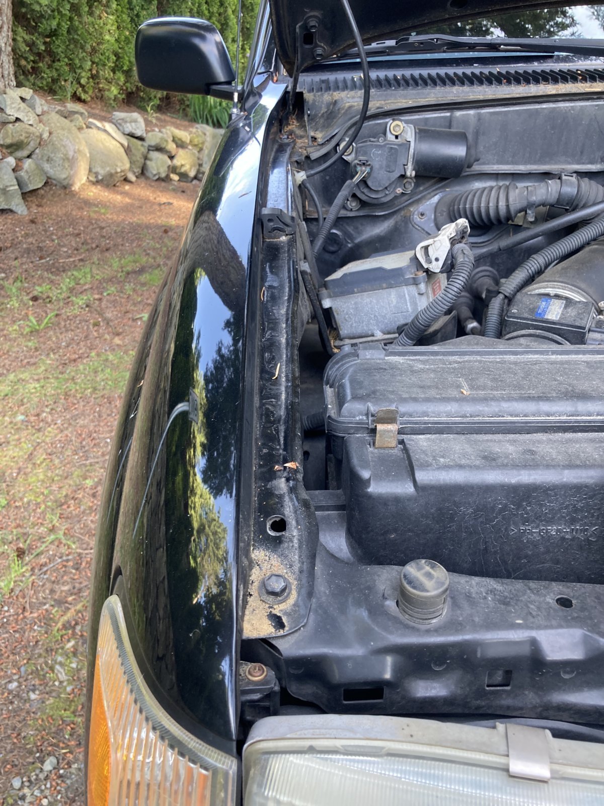

    So I looked and my rubber grommets in front corners are fixed so I guess I should either build em up or do the tightening of the latch. Which do the experts here think? Here are some more photos.

    Those aren't adjustable?
    You sure they aren't just frozen in place?
  9. Jun 10, 2024 at 6:21 PM
    bubbas
    bubbas [OP] Well-Known Member
    Oct 28, 2016
    #200918
    95
    Well I tried to unscrew and they just spin. I reached under and there is a nut underneath that is tight. How fine is the unscrew thread? Do you have to turn it a lot counter clockwise to raise? or maybe I do not know how to "adjust" please describe maybe I am missing something. I expected to turn counter clockwise a few turns and they would raise 1/8 inch or so, but the don't they just spin....

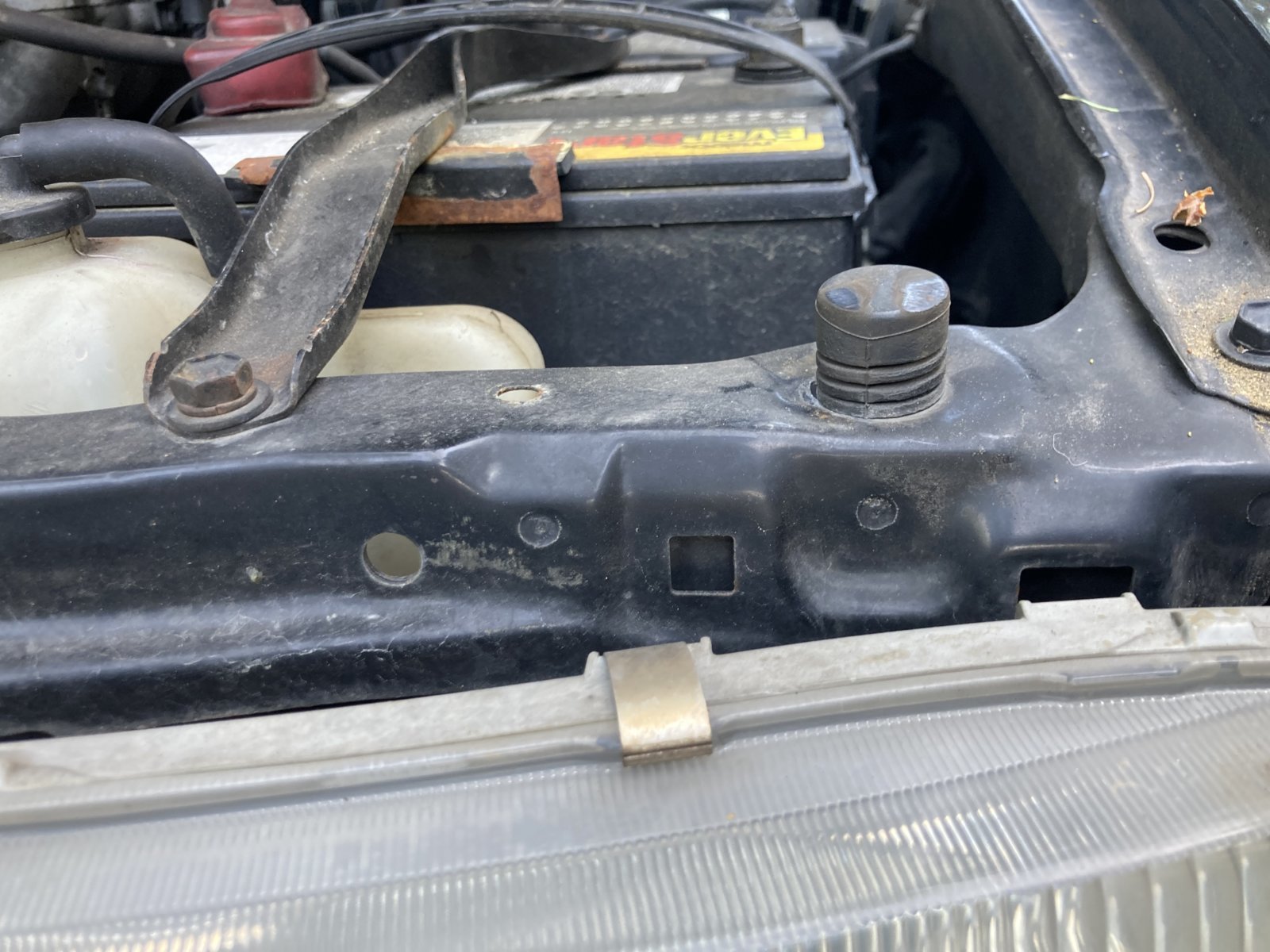

    This is it.

    yeah man thats it
    see the 'threads' in the rubber
    hit that thing with some lube/wd 40......that puppy will turn 110%

    Ok thx it turns, just doesn't rise, maybe the nut is also spinning underneath. Will try that and hold the nut and spin and spray first. Wish someone had a photo of one off.. with the how it threads.

    no nut or anything
    just HULK IT turing that rubber grommet......it will turn 110%
    will post a pix when i get home bro

    Here u go bubbas

    Ok yes feel very dumb all these years I was turning it I did not see the threads in the rubber. Yes they raised and yes no movement at all now. Had to lower one side as I made too much of a
    lift along hood seam and it
    looked funny. Haven't freeway driven yet but should be good. Some say they out a small piece of tubing in the mid point under hood along windshield also as the new ones have it. We will see. Should I steel wool and paint then lube/grease latch? what lube if so. thx
