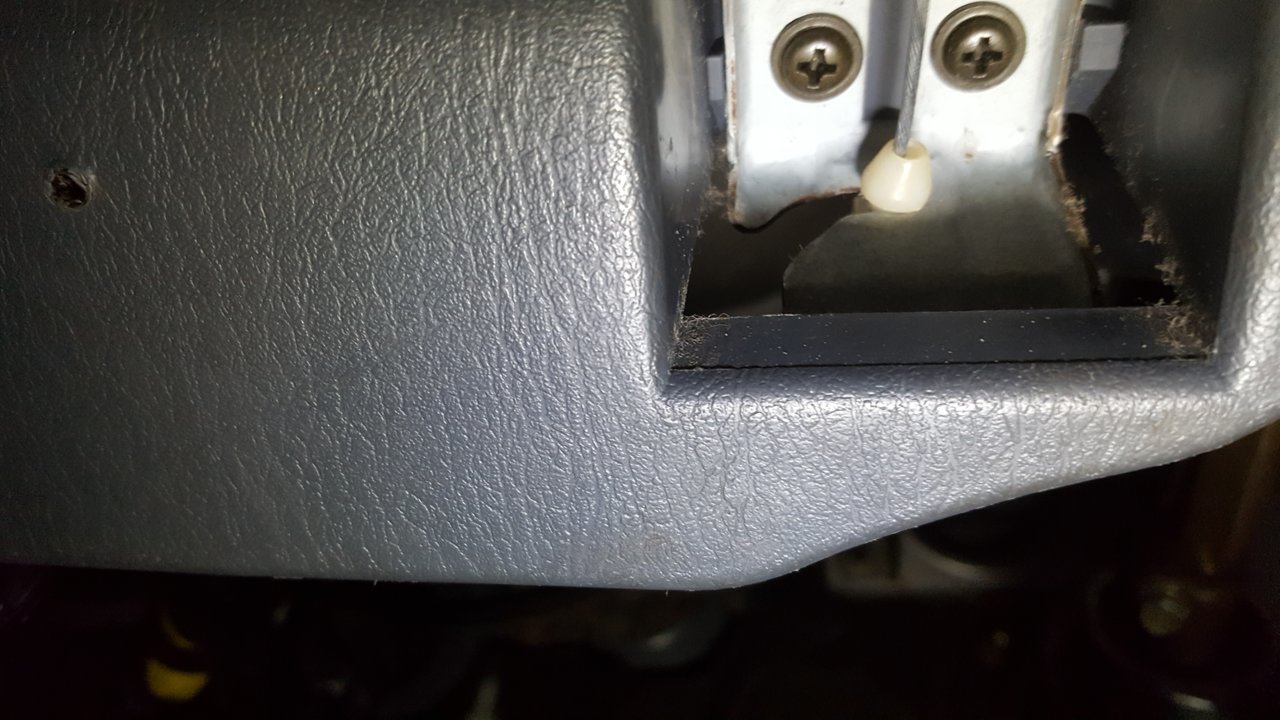

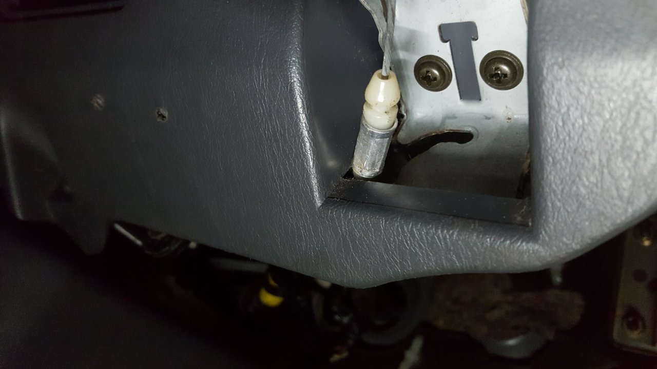

  11. Nov 6, 2018 at 6:03 PM
    Wsidr1
    Wsidr1 Well-Known Member
    Jul 11, 2018
    #259004
    3,079
    Indiana
    2 x 95.5 Ext 2.7L & 3.4L A/T 4x4
    @OilTruck
    Just went out and popped mine out. Cable came out of the handle too. I was able to get it back in easily with the white cable end loose.
    Cable end snapped into place
    Cable end popped out
    Easiest way I found is to insert the barrel end into the lever and hold pressure on it with my index finger. Then as I slowly begin to let the lever go back in, I use my middle finger to guide the cable back into place while maintaining pressure against the barrel end with my index finger.
    Then maintain a pull on the cable from rear side of the cable while snapping the white end back into it's slot. Once you get the hang of it, its a 3-5 second fix.
