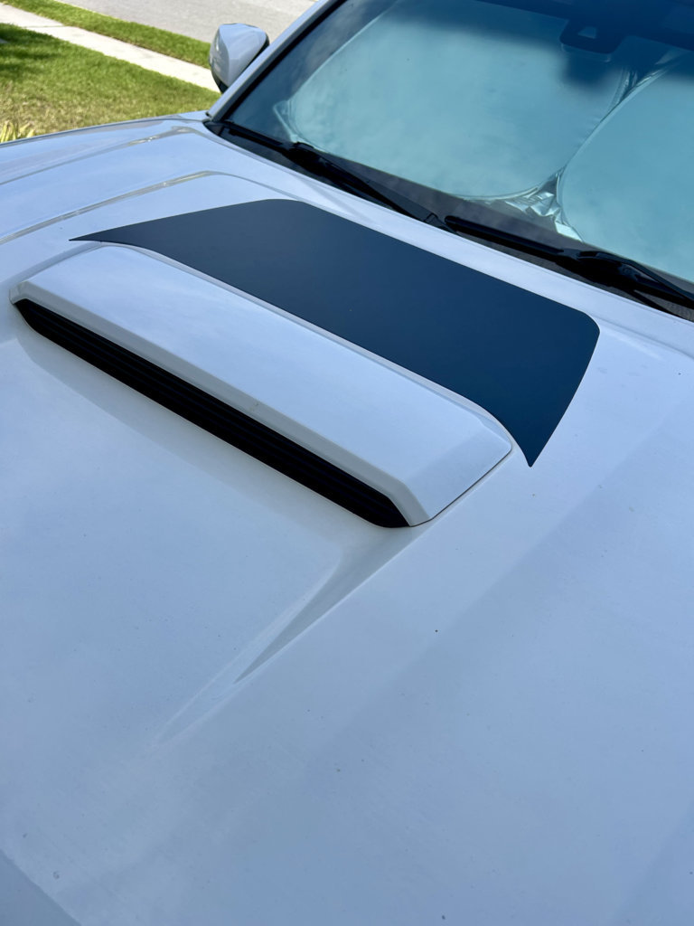

    So I put a decal on my hood to reduce glare about six months ago. Straightforward enough, right? Well, in my haste to install it, I didn't realize I'd purchased a decal for a 4Runner until it was partially adhered. Figured I'd live with it for a bit, but I'm ready for it to go. Anyone have tips for removing one of these?

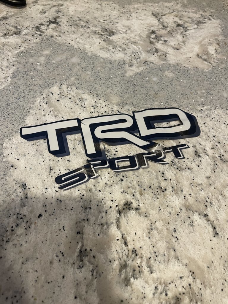

    Everyone botched their trd sticker removal on their 24's, while mine came right off...
    Wait for a hot day & let the hood bake in the sun majority of the day...
    When it has peaked & the metal of the hood in nice & baked, then go for it with the help of a blow dryer or heat gun if needed.
    If the corner doesnt Easily start peeling up, its not ready...
    That was key, everyone else, picked & picked, I was able to pull my stickers in one piece cuz I waited & knew what I was looking for & doing...
    ILL SAY IT AGAIN DONT DO ANYTHING TILL THE HOOD HAS BAKED IN THE HOT SUN FOR HOURS...
    THAT IS KEY
    NICE HOT 85-90+ DEGREE DAY...
