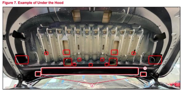

    I did notice that in addition to the 2024+ Tacomas having hood flutter (especially Pros and Sports), that the 2024 GX550s and 2024 Grand Highlanders had hood flutter issues. Both of those vehicles have TSBs to correct the problem. If you look at the underside of those hoods, they look a lot like the Tacoma hood.
    GX550: https://forum.ih8mud.com/attachments/l-sb-0013-25-pdf.3837747/
    Highlander: https://drive.google.com/file/d/1cVBJJGgQu5cJP4A59g7IBoeOlzoYFlXL/view

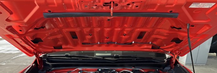

    Pretty sure I have read about non Pro/Sport owners commenting about hood flutter. GX550s and Grand Highlanders don't have scoops and they got a TSB. All came out in 2024, all are made of aluminum.
    GX550 Hood Grand Highlander Hood Tacoma Hood
    upload_2025-4-2_9-41-54.jpg upload_2025-4-2_9-43-40.png upload_2025-4-2_9-45-33.png
