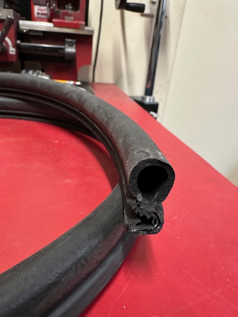

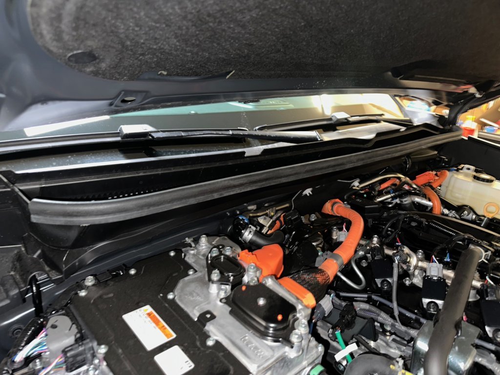

    I added some weatherstripping to put some pressure on the back of the hood. Didn't solve the flutter but lessened it.
