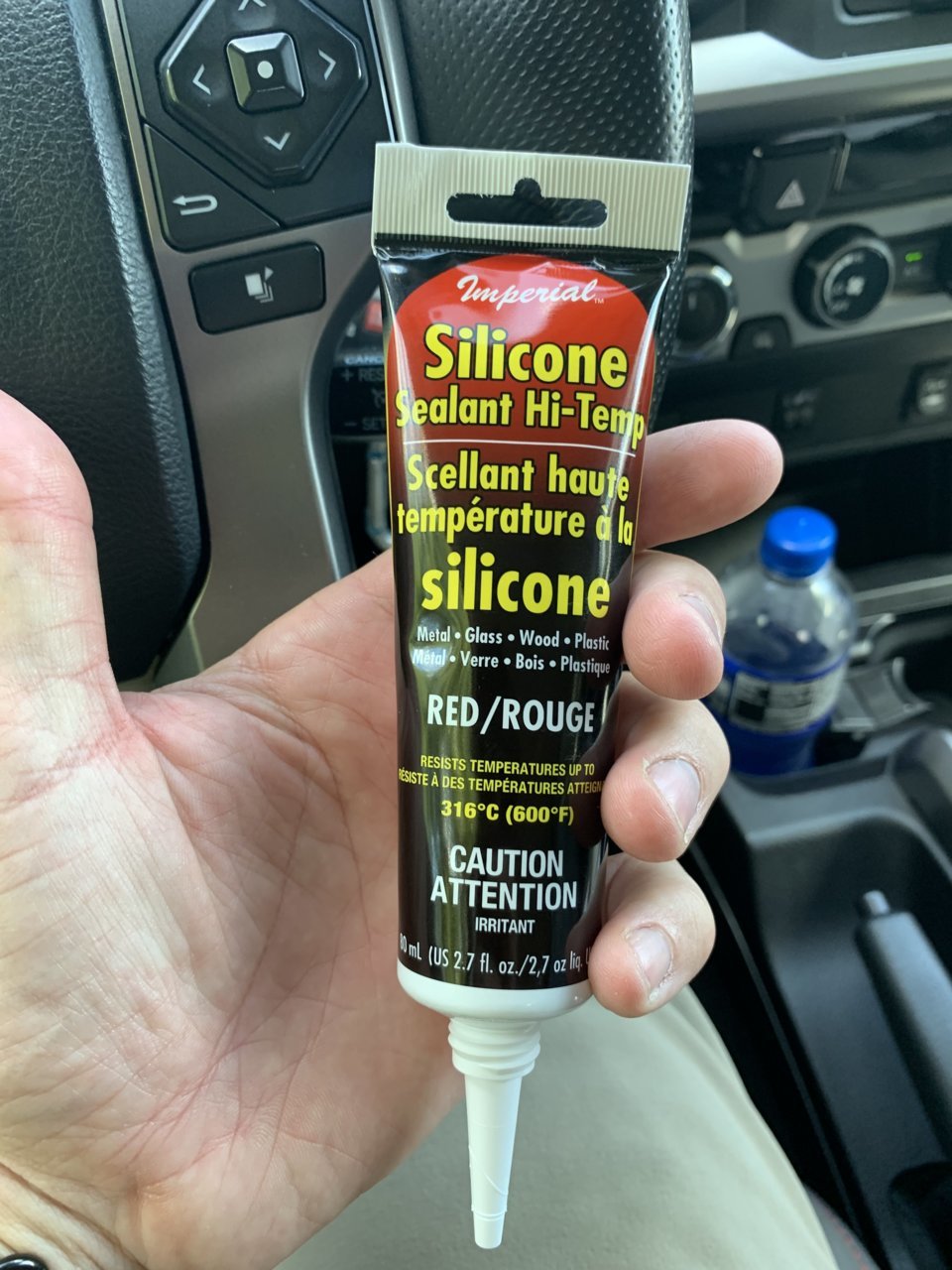

    Like a ton on you, my hood flutters going down the road. when the truck is dirty, not so bad. Clean, that bastard flickers light in my face like a strobe. (it’s just the way light hits it coming home from work)
    so i saw some threads about fixes
    , and i saw one poster used silicone with good results. So i had the idea of using silicone used for a wood stove. it’s red, so it sorta blends with my hood. but- it’s rated for 500 degree constant heat. (if it got that hot under the hood my shits on fire)
    it bonded awesome, no more flutter. rock solid.
    got it at lowe’s.

    Wasn’t there a recall for the early third gens for the hood doing this

    yup, there is. i’m well out of warranty, and when it was- i forgot to get it done.
