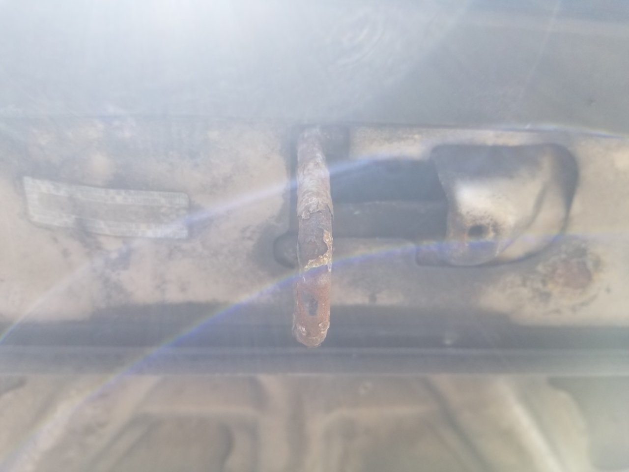

    Remove hood
    Assess damage; he said it's on its last leg so unsure if it needs cutting off and replacing

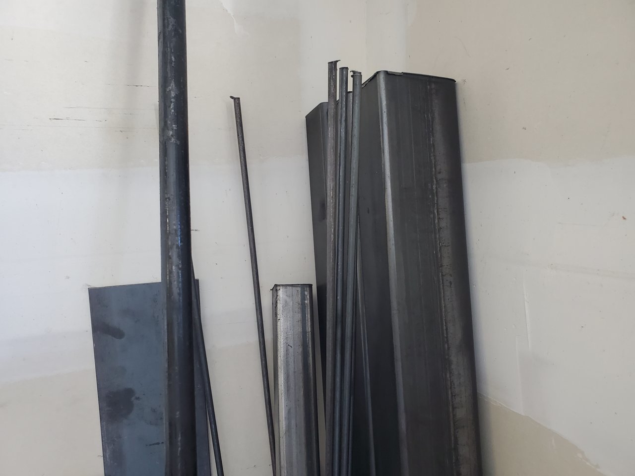

    I have plenty of rod to cut and bend to replace (over 30')
    Cut and remove old hook (if needed)
    Clean metal of any paint and contaminants
    Clean with acetone
    And from there figure using plate and said rod to weld it into place. Would drill out the backside of the new plate I use to weld the rod on the backside as well
    My only concern would be wanting to heat treat the rod before welding it in place but I've never heat treated anything before
    Maybe just use stainless steel rod since it's harder

    Removing the hood after you factor in your labor I venture a used hood one be much cheaper.
    I understand you would work Gratis but sadly I live in the real world with bills to pay.
    I wish I still had my old text book from the strength and materials course I was
    talked into teaching years ago.
    I would send it to you! loose leaf format from real world experiences.
    There is a very big difference between strength and hardness when talking material they are not interchangeable .
    Do some checking into as rolled or formed material strength I think you will find it interesting .

    So how does your frame test out?
    I mean if the hood latch has rotted off, I'd sure be very concerned about other bits........

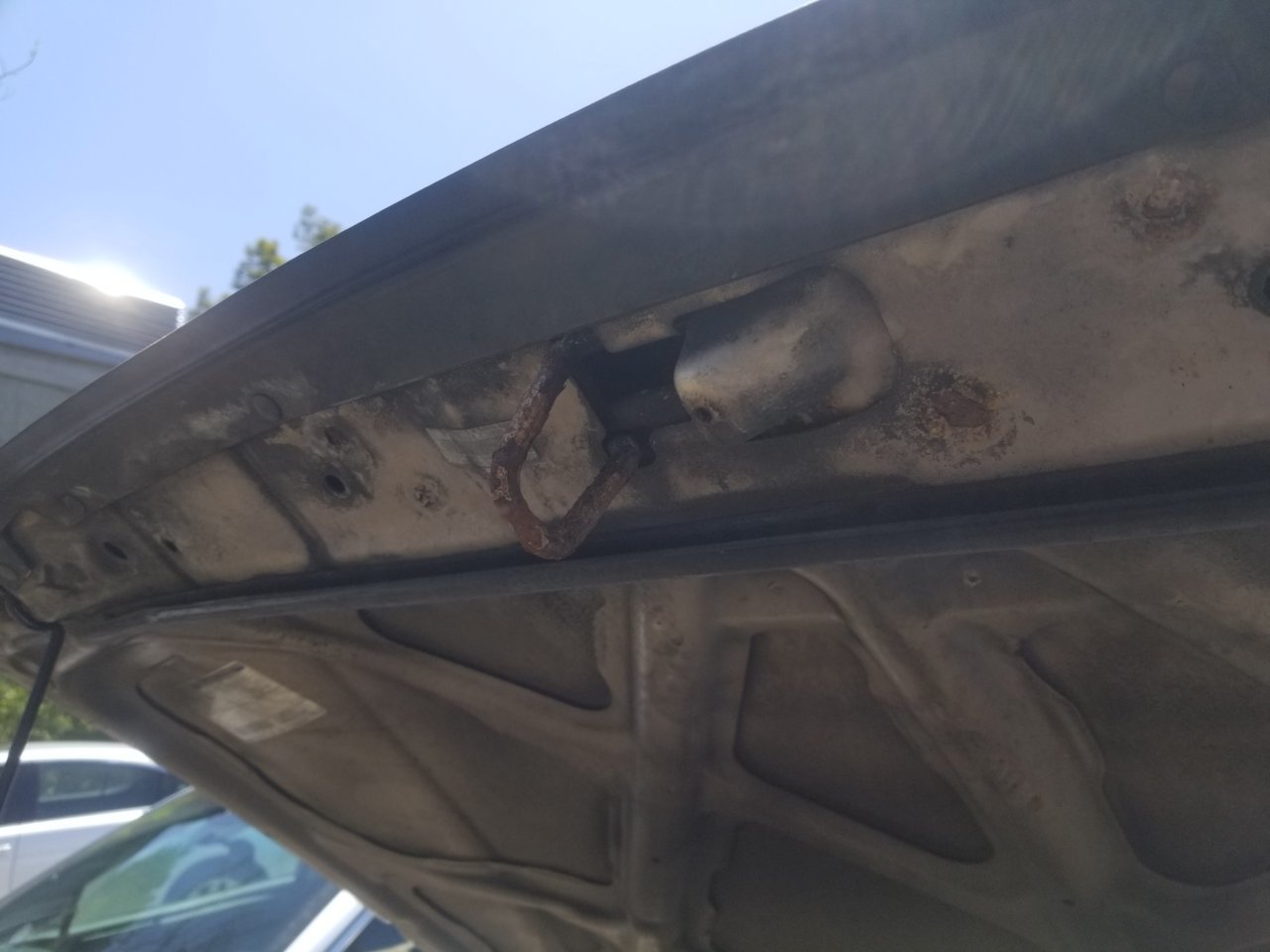

    Here are a couple of pics on my truck.
    It isn't as bad as I thought and maybe I can wizzy wheel off the rust and treat with POR 15

    The paint was rubbed off all you have is surface rust!!
    Clean and Paint you will be fine.
    If it was at the point of failure you could grab hold and yank it off the truck quite easy.

    You said last leg, I thought it was cracked and rusted through about to fall apart.
    Hit it with a wire wheel and paint it.
    Worst case, you bring it out this way like I mentioned.
