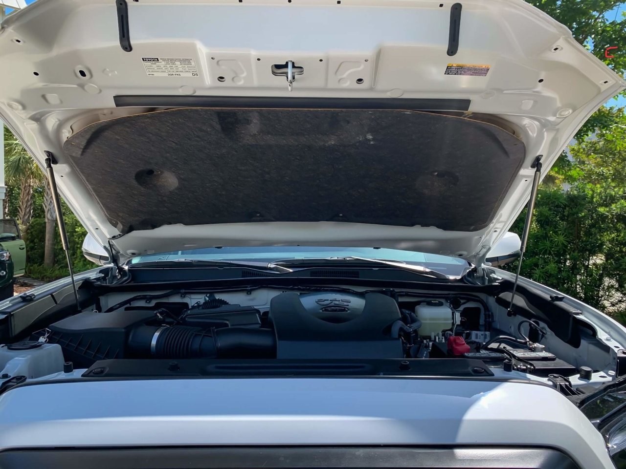

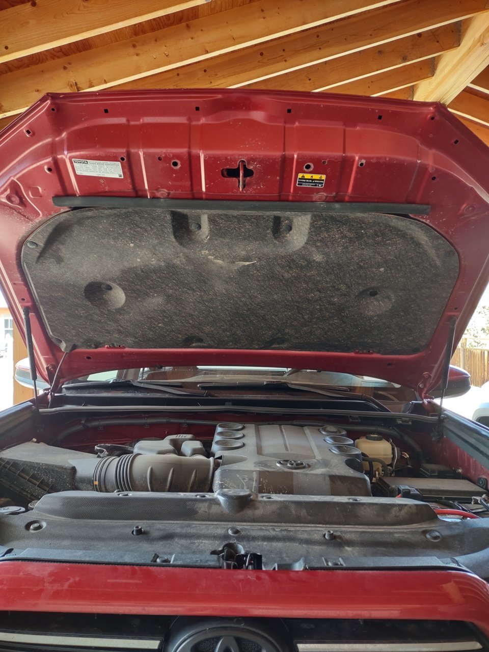

    Like Rainoffire said it does indeed fit shape-wise, but not all of the tabs line up. You can easily drill out more holes where necessary if you want more than 4 points for the buttons to hold.
    So its nots a perfect fit but works fine. For sure reduces noise a bit and shows no sign of wear after 3 years.
    part # 5334135161
    DO NOT USE DYNAMAT OR ANY BUTYL SOUND INSULATION. IT MELTS AND FALLS OFF FROM ENGINE HEAT.

    FYI. 4Runner hood insulation did very very little to reduce engine noise on my 20 Sport. Would probably help in the winter if I still lived in Calgary.

    I actually have Dynamite Hood Insulator and some Butyl Sound Deadener on my hood, and has been there for 4 years now. They are pretty stuck there and I live in a constant 89.6F environment.

    What color is you truck? I tried two types and both melted. (Black)

    Quicksand.
    I live at an apartment complex, so it is always out in the sun.
    I made sure to clean the surface with isopropyl alcohol, then used a roller to really pressed in the sound deadener.
    The Butyl Sound Deadener is Noico.

    I was short on time, I was looking at an old thread and found some pics to post before heading out this am.

    The hood blanket from a 5th Generation 4Runner is a perfect fit for the 3rd Generation Tacoma, with one exception. The holes for the clips at the extreme corners are not drilled. You could drill the holes, or secure the corners with Velcro.
    I decided not to add the hood blanket because (a) it's expensive, and (b) it's specifically not recommended by Toyota. They must have their reasons.
