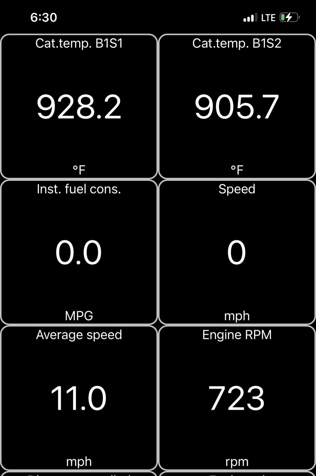

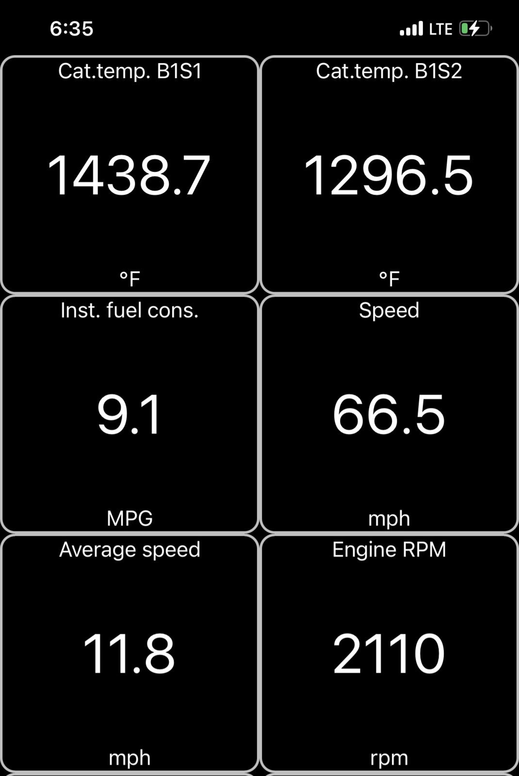

  12. Jun 18, 2024 at 3:52 PM
    #32
    Newwt
    Newwt Well-Known Member
    Apr 28, 2017
    #217553
    1,000
    Tampa, FL
    21 SUPER WHITE TRD OR 4X4 , 24 BCM TRD OR
    Maybe, diesel EGTs will be lower than gas engines, I wasn’t able to find a manifold temp but was able to see the 2 cat temp sensors
    This was idle at a light
    This was light acceleration ~8-10psi boost
