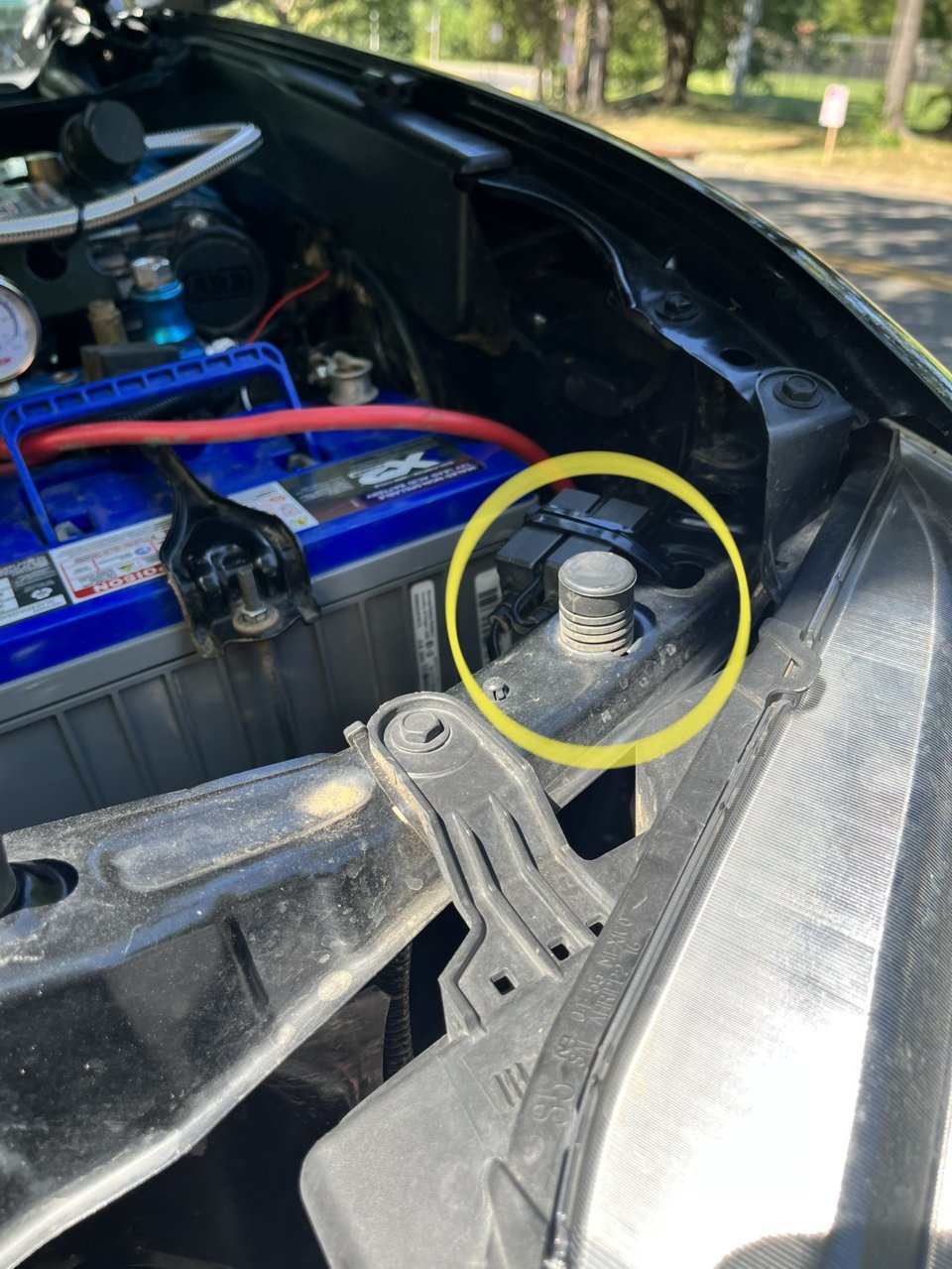

    Has anyone had experience with their hood latches / releases not working properly?
    Mine doesn't pop the hood open anymore, but it will release it. You just need to get your fingers under the gaps around the hood and open it.
    Doesn't make the audible release noise either.
    When you pull the release inside the truck, there's no wall of force to overcome, it's linear all the way.
    I've seen a few posts of this but no solutions. Figured I'd revisit before just buying a new latch mechanism.

    You need to adjust these guys. I backed mine all the way out and then re-tightened one rotation…that did the trick for me. Good luck

    So backing out the adjustment stops didn't fix it.
    Tightening them did not fix it. Trying every other position with the hood stops didn't work.
    Asked my buddy, who is a Toyota Master Mechanic. He says they usually just liberally spray with silicone and cycle the hood latch 20 times. I used a half can of silicone, cycled a ton, it will "pop" up about one out of every 5 times, but the hood release still has no resistance and makes no audible click.
    Guess I will buy a new latch.
