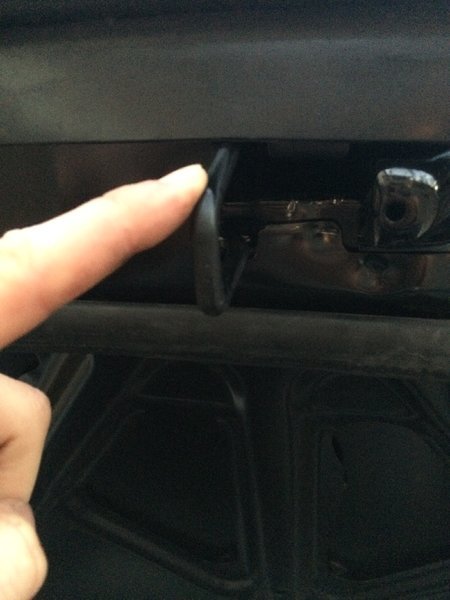

    My hood latch is not cooperating. The little hoop will go into the spot where the lock is, but the lock won't move so my hood won't lock.
    Please help.

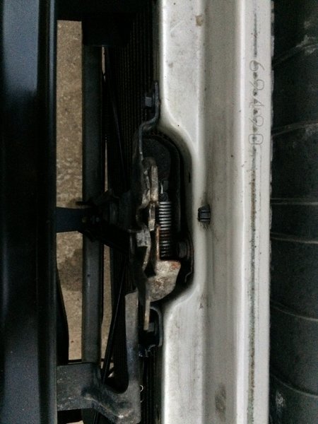

    If this helps

    Something is either seized (cable/hinge), or maybe the springfell out?

    Well I just had it bathing in WD40 for a half hour, and all the springs are there...

    First, give it a few good soakings in WD-40, Liquid Wrench, or whatever your preferred penetrating oil is. Next, work the action with a screwdriver. Push the side of the screwedriver down into the mechanism. Make a note of any parts are catching. Once fully engaged, spray again with some penetrating oil. Then release (using the release switch inside the cab) and keep working it/releasing it while lightly spraying it at different parts of the movement.
    Try it and get back to us.

    Just checked. It moves the spring but it does not pull the lever/lock

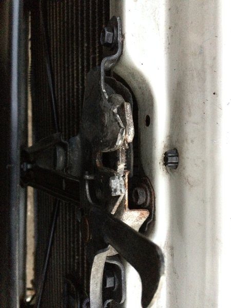

    I don't know how you guys are doing this, but it's damn near impossible for me to push this latch down with a screwdriver

    Actually. The little hoop is ending up just in front the lock.

    I bent the mechanism so the hoop will go in there now, but now the lock won't go over the hoop. It's pressing it down but it won't snap over. ?

    somehow you got to manually pop the latch at the mechanism with a screwdriver to get it to operate this happened to me but I cant remember exactly where you pop it at, I know I used a screwdriver to reach in the mechanism, once u pop it the hood will then close and lock and the release latch in the cab will work, but you have to have the screwdriver to pop the mechanism everytime. I finally found out the cable was bound up and shot some oil into the wire casing and it became ok from then on.

    no you got to manually pop that spring mechanism where the cable attachs with a screw driver then the hood will lock, the cable gets bound up in the protection sleeve and will not unlock mechanism
