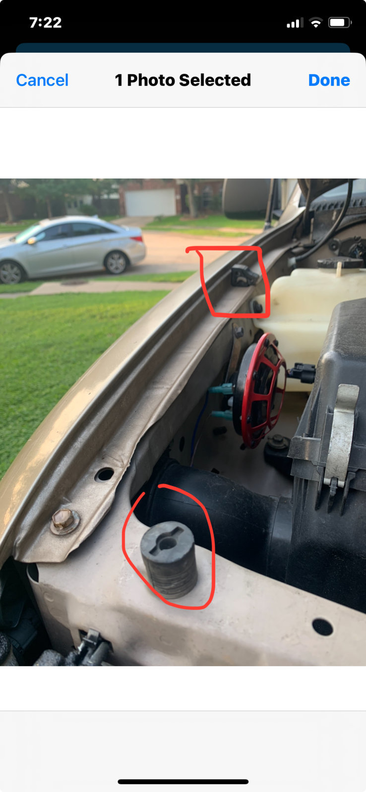

    There are some screw in/adjustable grommets on each front corner
    Usually on upper tie bar of radiator core
    lube cable
    Adjust/lube latch
    Final adjustment are those grommets
    once hood shuts firmly AND hood to fender gaps are leveled…..you done!

    Here:
    The circle is the one that adjusts
    The square helps with hood vibration/hood flex (not adjustable)
    Have to buy
    Too much from dealer for my blood, I just lubed/adjusted cable/latch
    Working fine…..no noise/up and down movement of hood
