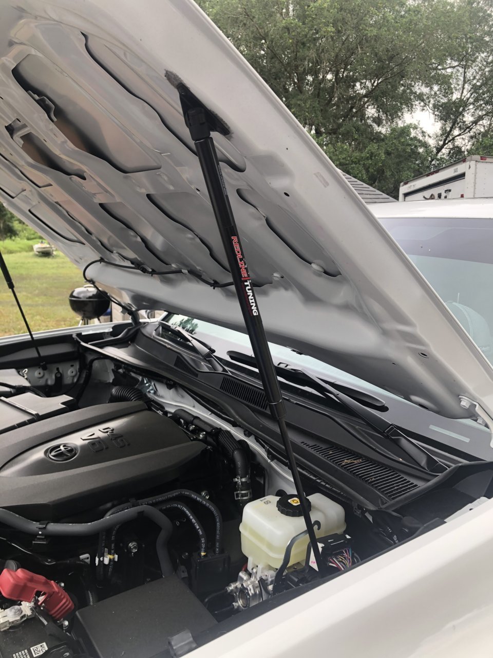

    Just installed Redline Tuning hood struts on my Tacoma. Wow. What a difference. From Amazon. 100 bucks.

    Keep an eye out for corrosion at rivet points.

    Thanks. I painted it pretty good. Fingers crossed

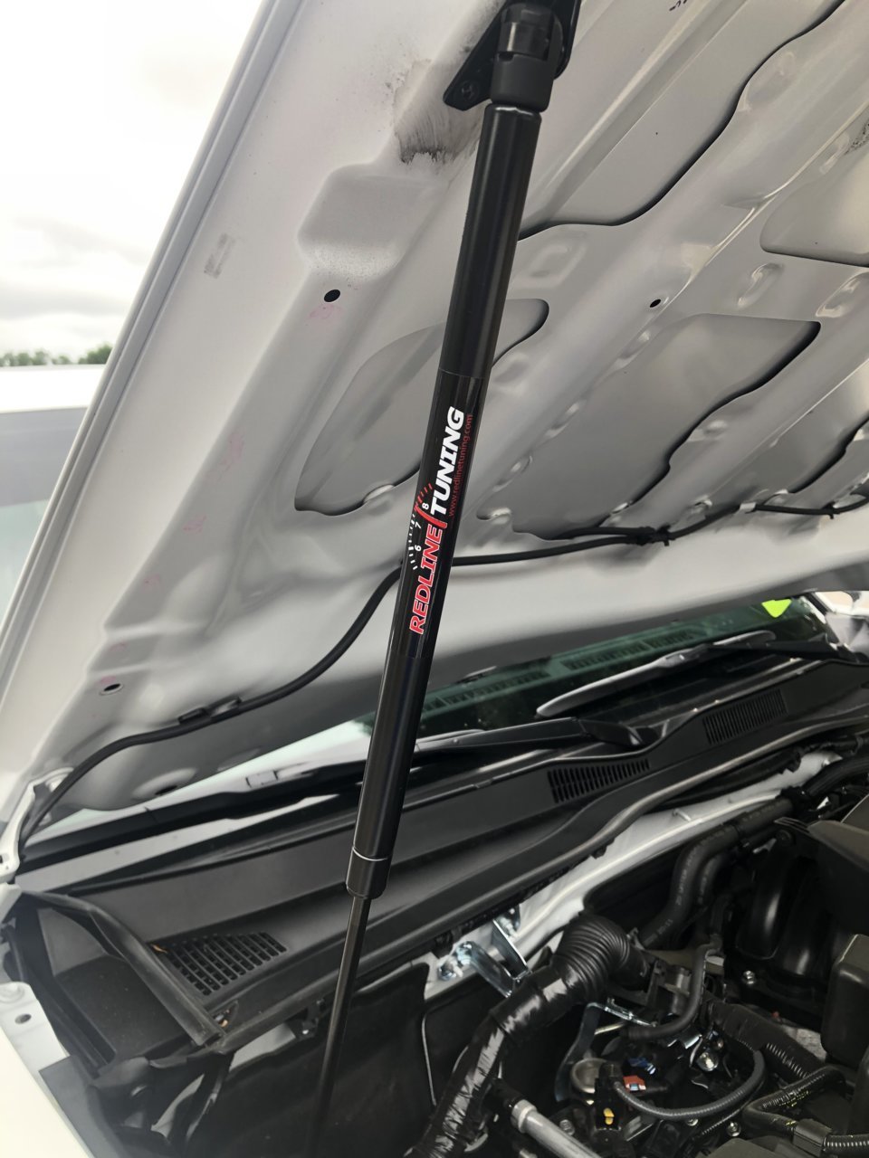

    When I ffirst installed them I noticed that the hood was under pressure when closed. Then I realized I got the measurements wrong. 4 extra holes in the hood later and I love the struts!

    I was a little apprehensive about drilling in my new truck. But. That all went away after the first hole. I really like them. Everyone is correct. Should be an item from the factory. Or at least an option. Painted the holes with black paint. Only one I had. Except white appliance paint. Measure measure measure. Word for today. During this install

    First mod I did to my truck. Fairly easy install, I did rivet one bracket the wrong way but was lucky the kit I got had 1 extra rivet.

    I drilled and riveted the passenger side, upper bracket and realized I had it 180 degrees wrong. Luckily I caught it before I popped the 2nd rivet. Figured maybe RedLine includes 1 extra, for dummies like me, but others have said they only got the 8 required.
