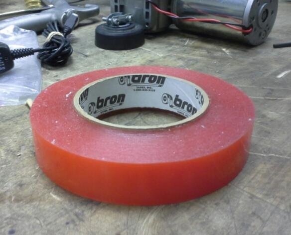

    I use this BT-3854 Killer Red double sided tape at work, It sticks to everything no problem. If all BeeRadd is doing is changing the adhesive tape form the manufacturer to a stronger brand maybe this tape might work better. Quote below with specs from a Seller of this tape.
    Killer Red" heavy duty, double coated industrial tape is 8 mil thick. High-tech, pressure-sensitive, acrylic-based permanently bonds many materials, but is best for plastic-to-metal and metal-to-metal applications. Great double stick tape for adhering acrylic, Plexiglas, ABS plastics, and low energy substrates to a wide variety of substrates. UV and temperature resistant from -30 degrees F up to 350 degrees F. Crystal clear, permanent, weatherproof tape tested to be flawlessly powerful; nasty strong. 3" core. 180-foot (60 yard) rolls in widths shown below. - See more at: http://www.cutting-mats.net/double-stick-fabric-tape.html#sthash.zWpT90MO.dpuf

    I guess 1/2" looks wide enough? I like the temperature specs. The existing adhesive needs to be removed.

    I have not tried it yet, I just got caught up on all this today. I currently use 1 inch at work which i will have to cut down to fit perfectly.

    Thank y'all for the suggestions. I actually have a supplier I've used before that I'm quite happy with. I have something like 500 feet of the stuff enroute, just waiting on the mailman. In the meantime, I'm using my personal stash to fulfil repair orders. They should be leaving momentarily.
