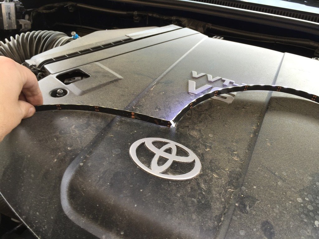

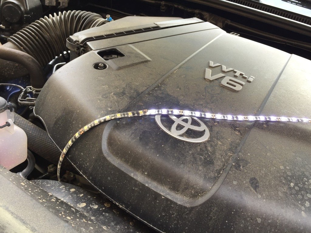

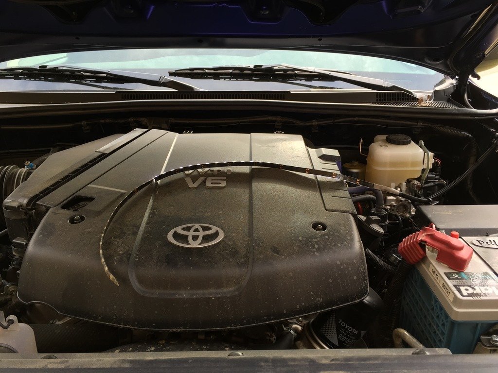

    So, I opened my hood yesterday to start on my bumper install and found this.
    I installed my kit back in December, checked it a few times/dates later and all was good. This is the first time I've opened my hood since then. :(

    Did the adhesive let go of the light strip or from the hood? I can't really tell from the pic.

    Adhesive let go from the hood.
    Best I can tell, the right side (towards the battery) let go first and snapped the LED chain, then the left side let go at some poi tabs it all fell onto the engine.
    This is a 3-1/2 month install, and the truck sits in the garage when not being used (I work from home) so it's not seen temps over 70 degrees F. The hood underside was washed and wiped with isopropyl alcohol before install.

    Inventor and builder of the kits here to answer a few questions and issues.
    The strips draw about a half an amp. That means that you should be able to leave your hood open for three months and still start your truck. If not, then you have a weak battery, or some other drain.
    The very first, original Hood Light is on my truck. It is going on three years, without ANY problem of any kind. I have put 50,000 miles on it. 90% of my trips (which totals over half the total miles on my truck) are in the desert, mostly Death Valley, mostly pushing my truck hard (sustained engine temps of over 200*), many in the summertime with air temps never going below 90* (usually over 100*). So any concerns about heat are moot.
    The recent failure pics, and explanation of prep procedures, tells me there was an installation/preparation problem, which places the fault with the installer. The bad batches leave the adhesive on the hood, not affecting the zip-tie tabs at all; because both the strip adhesive and the tabs came off, this tells me the surface was not completely clean.
    We will be happy to ship you replacement adhesive for a nominal charge (Brad has the pricing worked out, not me). However, I see you also need a new strip. Contact Brad and discuss with him -- he will decide how to proceed.
    NOTE! Not all kits built from the defective supplier are defective kits. Many hold up fine and have no issues, assuming installation was done properly.
