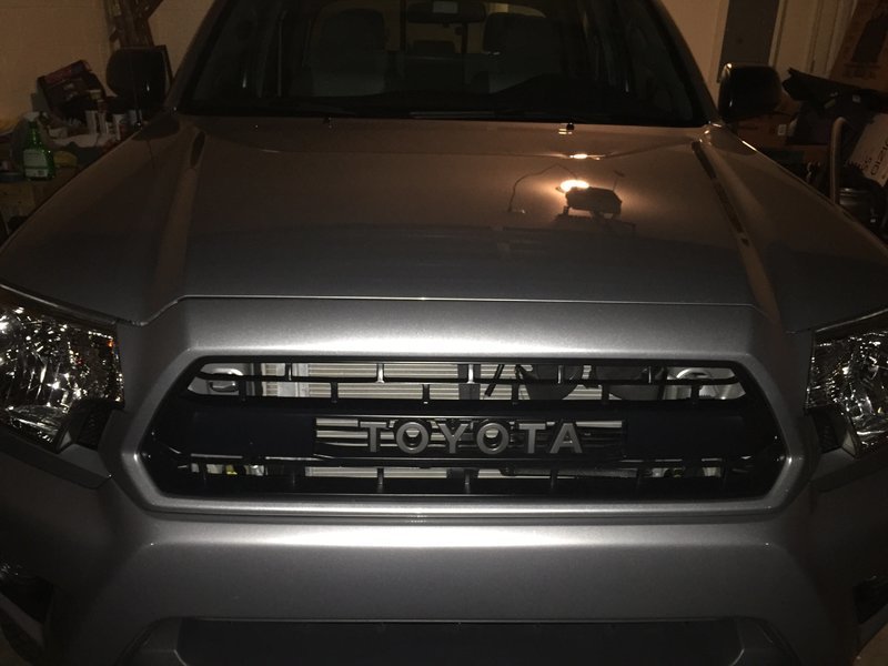

    Hey TW, I stalled a new color matched grille recently and noticed that there is a larger gap where the hood meets the headlight on one side than the other side. Is my hood not aligned correctly ? Does anyone else have this problem?

    Was the hood fine before you swapped out the grille? Maybe the grille is the problem

    Yea that's what I thought, I never noticed it before with the chrome grille. I checked to see if the grille wasn't level but it seems to be fine.

    You probably need to adjust the little bumpers that set the height of the hood when it's closed.

    Did not know that was even something I could do. Let me check that out. Here is a pic for reference image.jpg

    That was def the problem, thanks so much guys. That was bothering me for weeks
