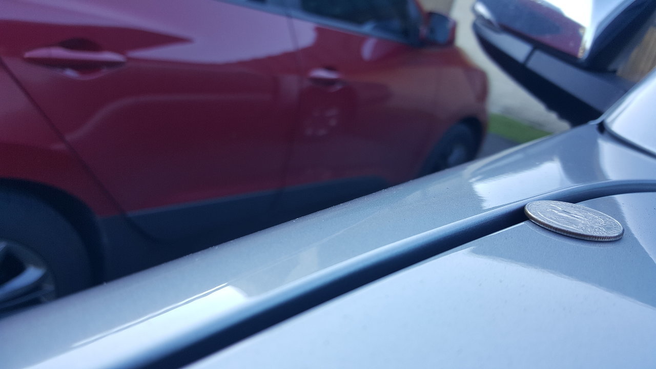

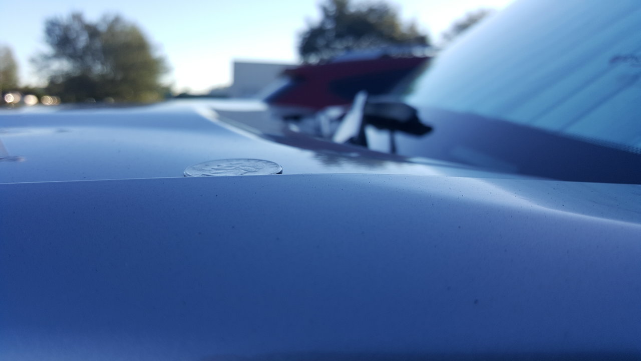

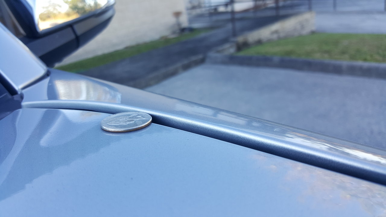

    OK. Got to the office a few minutes early; took some pics to show the issue.
    I am not sure if it is a hood mounting issue or a fender mount issue, either way hood adjustment can fix it.
    For reference, I put a quarter on the hood near the cab on each side and near the front on the driver's side, here are the pics:
    Driver's side hood is lower than fender by a bit more than the quarter's thickness at the cab a bit less at the front, I can run the bumper up a bit more in the front.
    Passenger side, no gap at front but there is near the cab, a bit less than the thickness of a quarter.

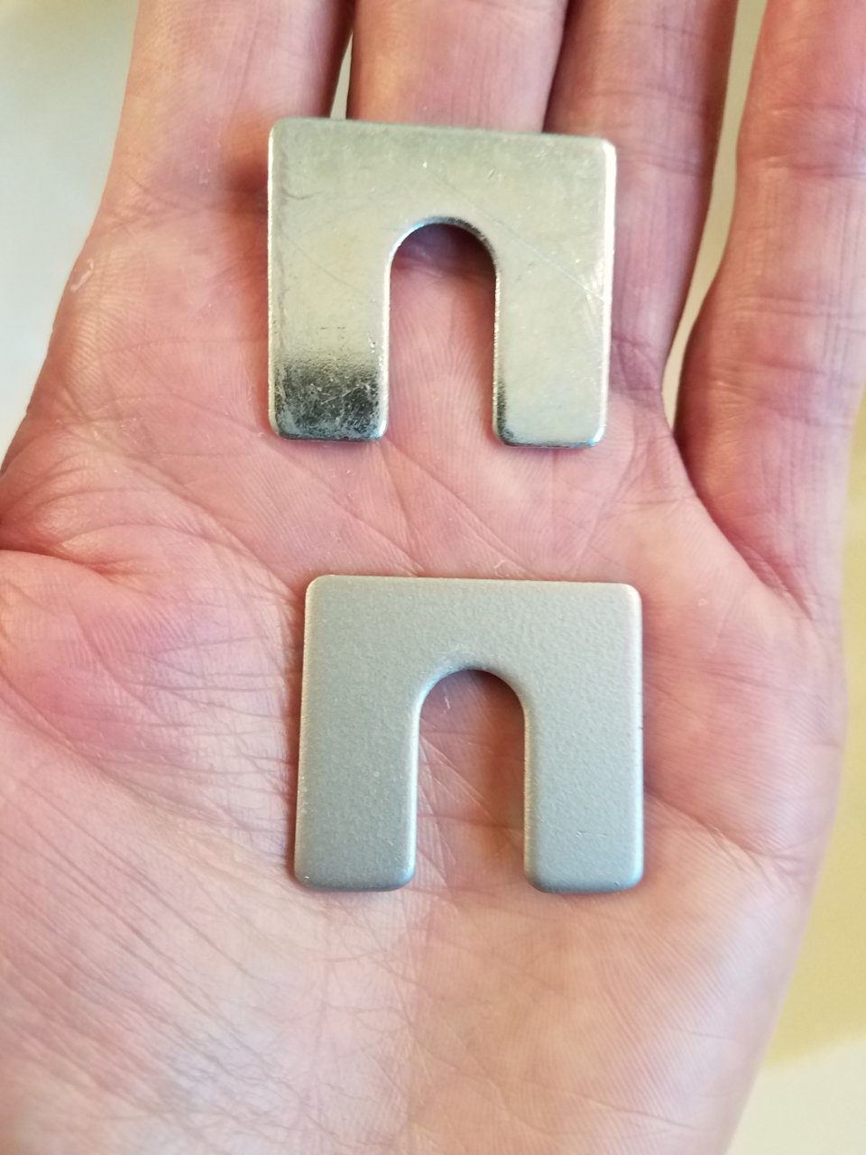

    They actually make Shims for adjusting body panels, picked these up at a parts store.1536683716965144053522114342649.jpg

    Should work perfectly. I did not think about it at the time, but I actually had a few of those that came with my power steps that were not needed.
