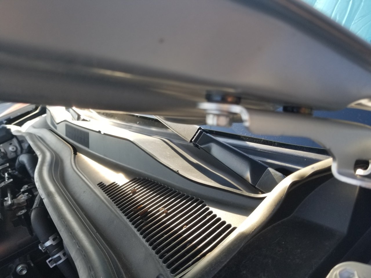

    TC_Mic
    TC_Mic Well-Known Member
    Mar 28, 2017
    #214625
    1,273
    State of confusion, aka Flori-duh
    2017 Silver Sky 2x4 Limited
    AMP Powerstep, UC Flex, bed lights, Opt7 Tailgate bar, black tailgate lettering Pending: re-configure tail light,s custom storage pocket bags, pinch weld painting, blackout badges, ......
    I will go out and take a few pics at the edges of the cab and inside the hood. I will post with the pics later today.
    I did the adjustment myself in the driveway. It took me less than 30 minutes as I recall and the biggest problem I had was dropping the spacers I was using into the fender. I had to stop and go to the back of the house to get a couple more, I have several in my "junk" parts bucket. If you look at my before pics (post #24 of this thread) you see one side was a bit more than the thickness of the quarter and ther other slightly less.

    TC_Mic, Thanks for your help. I assume you used the hood support to hold the hood up while you were working on it. How unsteady did the hood become. I don't want to take the chance of twisting the hood, dropping the edge on the cowl or possibly stripping one of the bolts.

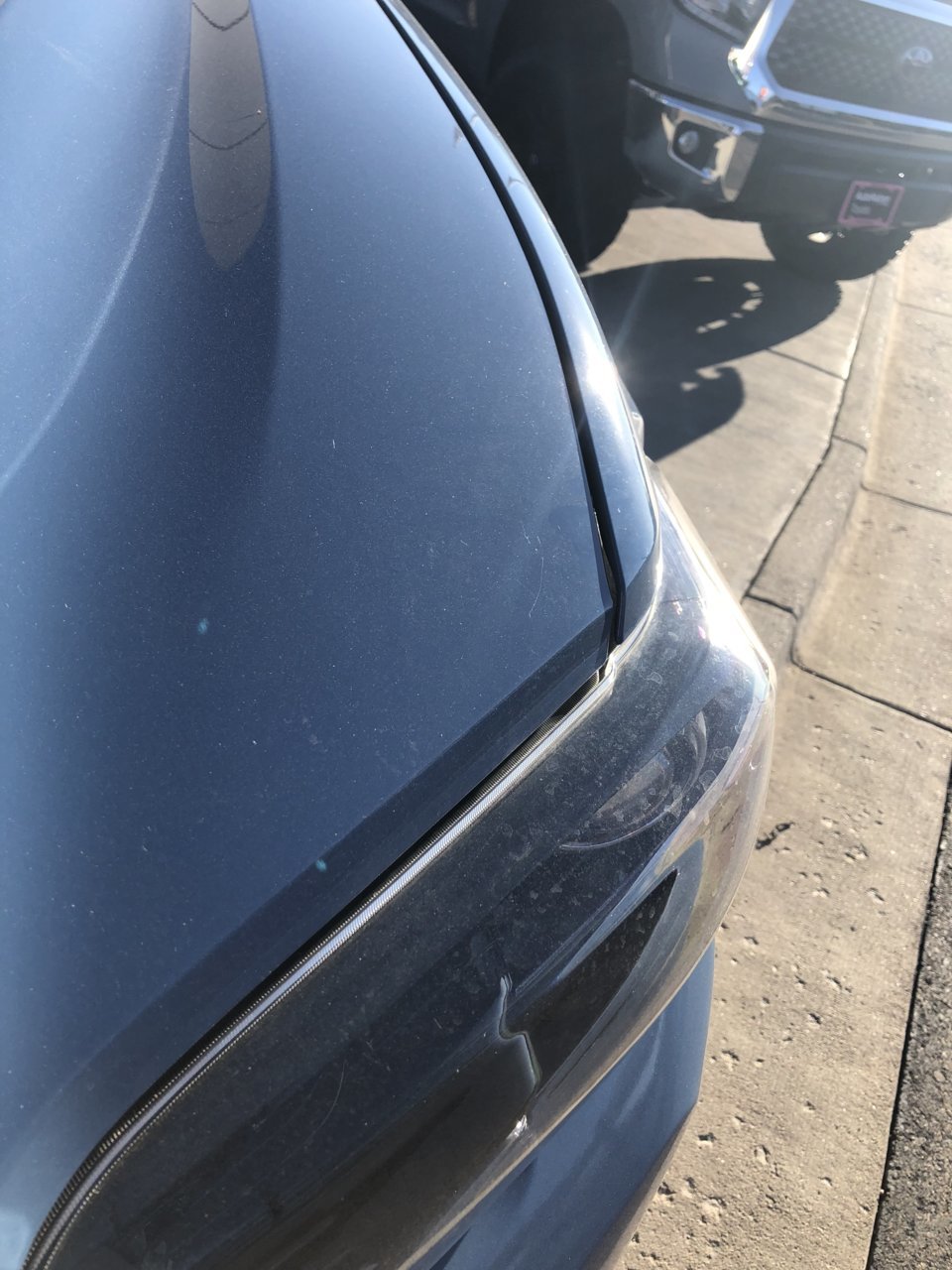

    My 2018 has exactly the same problem, on the drivers side. I opened the hood, twisted the hood strike on the drivers side out about 3/4 of a full rotation, closed the hood. The front is now even, by the windshield it’s still low by maybe 1/16 of an inch. Good enough.
    If I was buying a 2018 and noticed it on driving they would get to fix it before I drove it off of the lot.

    TC_Mic
    Mar 28, 2017
    #214625
    1,273
    I did use the prop. I worked 1 hinge at a time, loosened both bolts but only removed 1 at a time. I really had no trouble each bolt has a "seat" on it. Much like this :[​IMG]
    I believe this type of bolt is called a shoulder bolt, but I may be incorrect. As long as you have the shoulder/seat of 1 bolt partially within the hinge hole it will give you 0 problems. It really sounds a LOT more complex than it is.

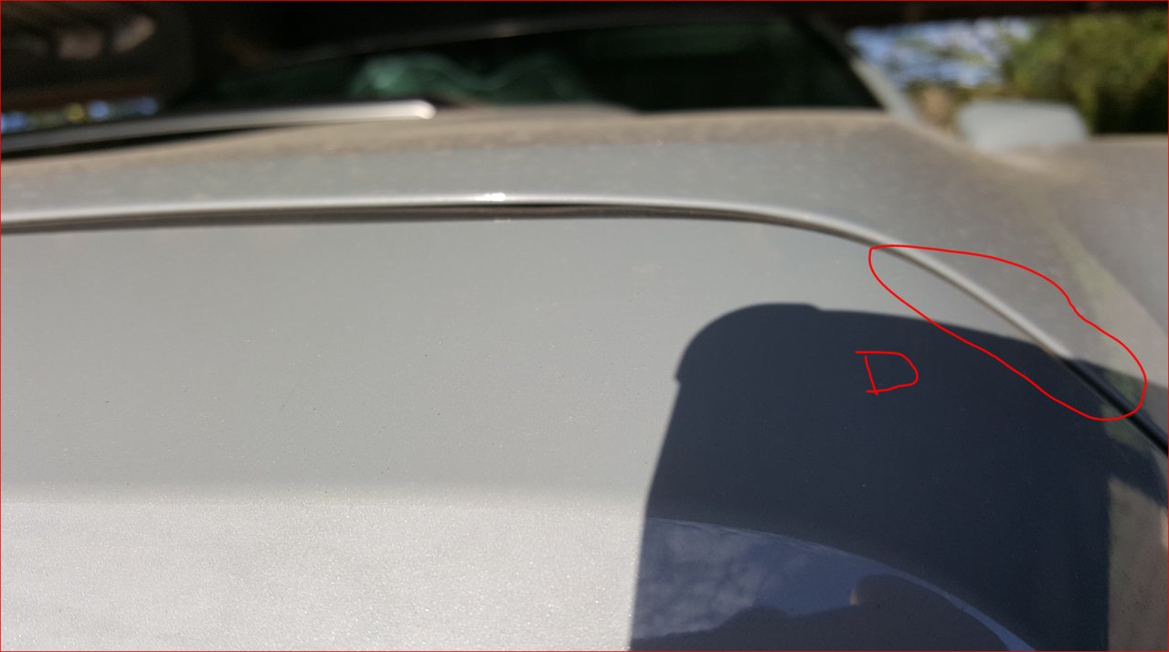

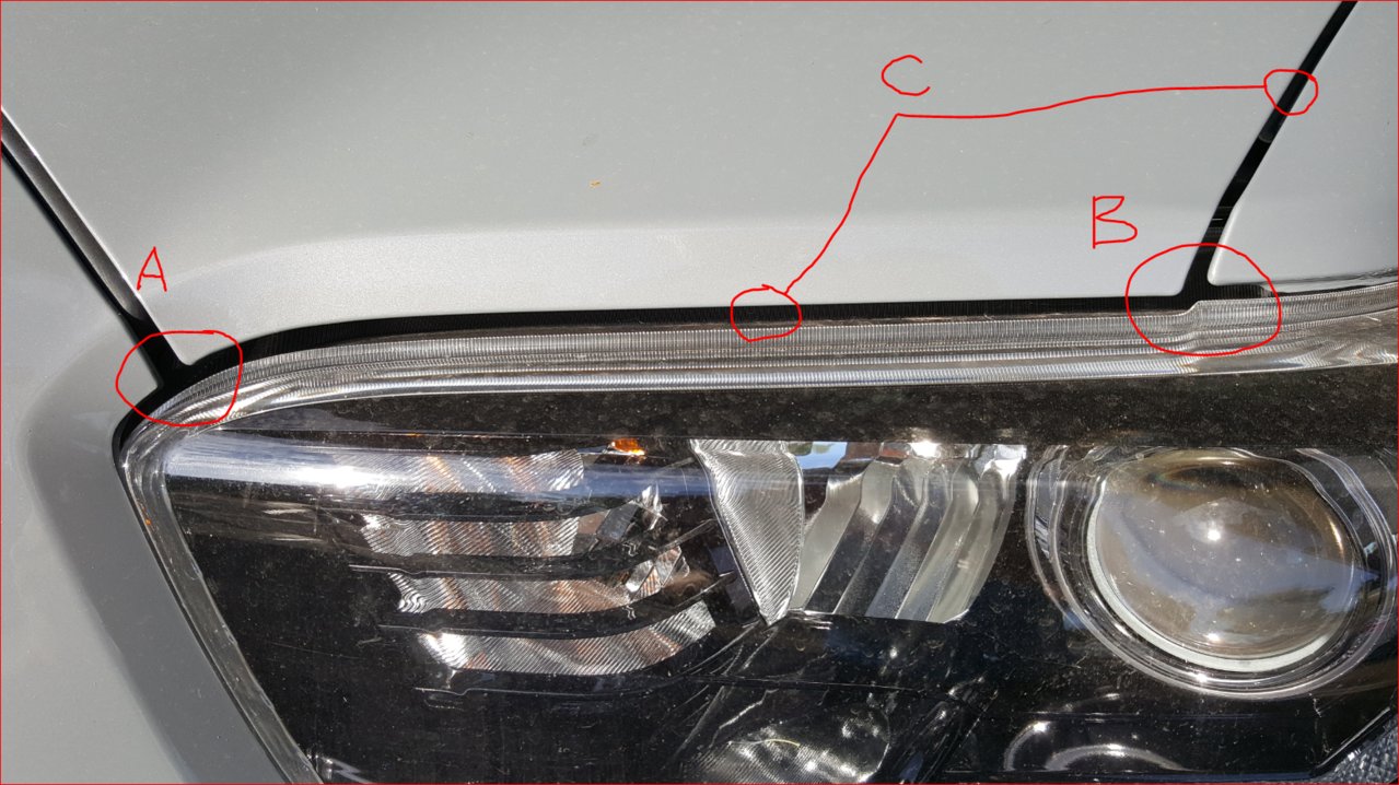

    I would NOT mess with the hood to line it up to the fender for the reasons:
    A - a raised hood would miss-align the hood to the nose grille bezel
    B - would increase the gap between the hood and the head light
    C - also would screw up the fender/hood/head light gaps
    D - would raise the hood line over the front bezel and look weird
    But is your truck and do as you please.

    TC_Mic

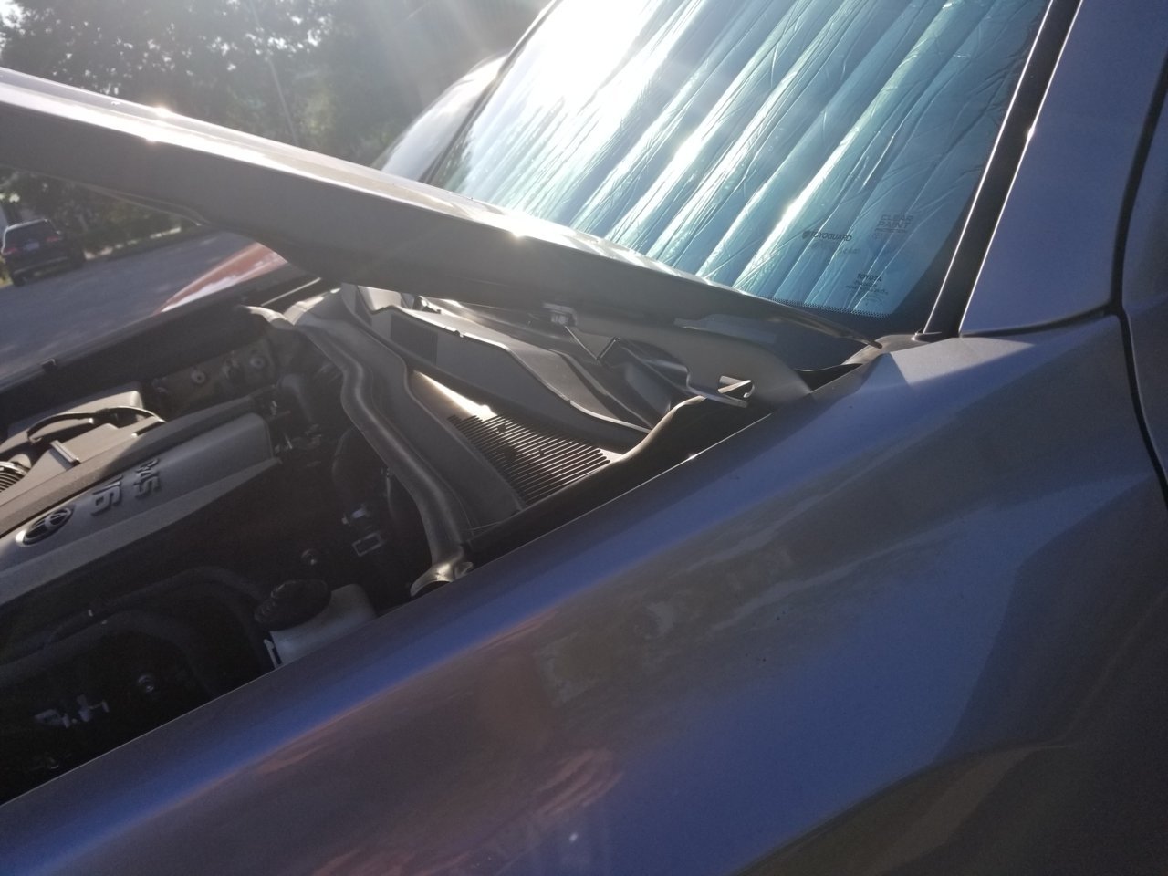

    TC_Mic
    Mar 28, 2017
    #214625
    1,273

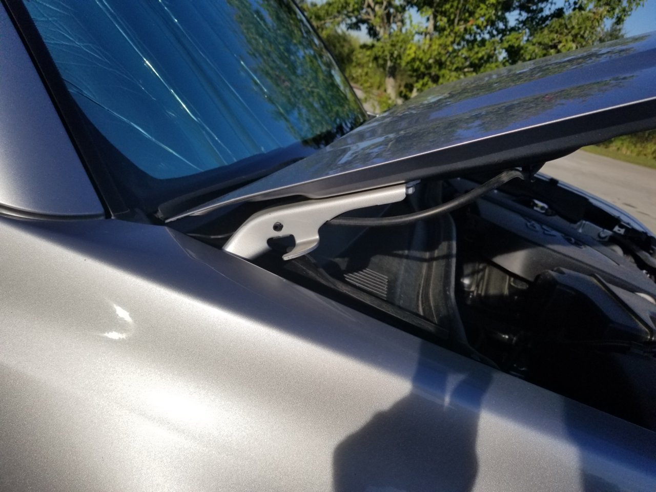

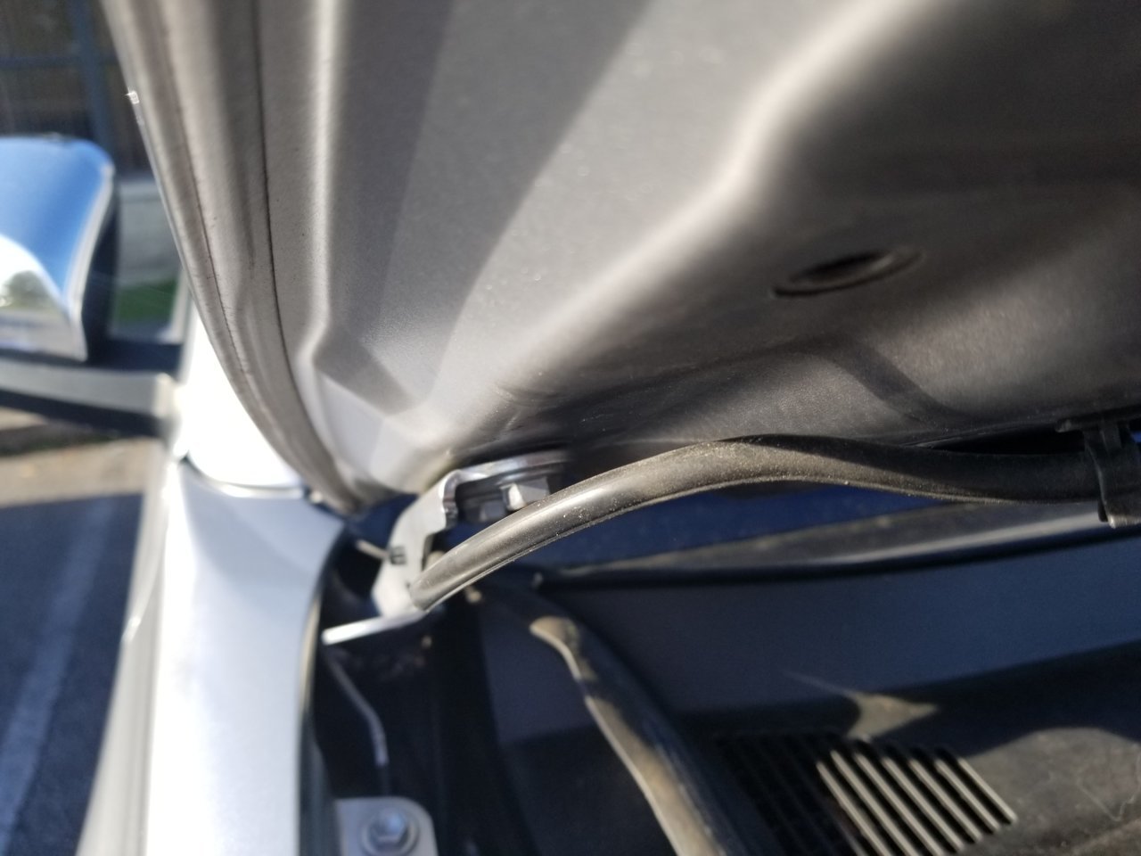

    Caution: Pic heavy post... as requested here are pics of my truck's hood after adjustment. I chose to do the adjustment myself because I knew it was not a difficult job. I did not want to take it back to the dealership and wait for hours for them to complete a few minutes work, and/or have to drop it off and go pick it up again later.
    Sorry for the delay, had a week full of Mondays at the office and at home. Here are the adjustment pics.
    And since @Dacon requested pics as well next post will have pics showing exterior.
