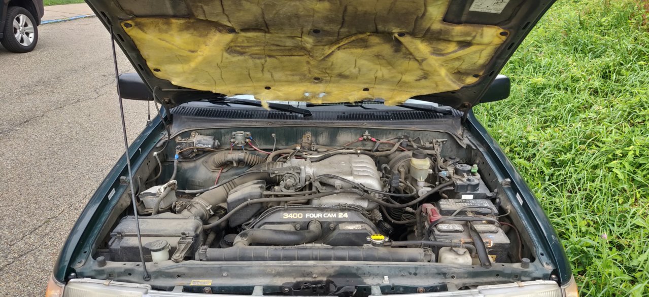

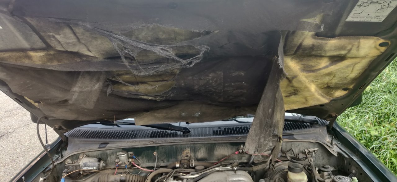

    I know this is unrelated but I also have this hanging cloth under the hood. I know it doesn't look great but is there any reason not to just remove it?

    That's what I thought. Thanks again!

    I removed it. Would you recommend taking the yellow part off as well?

    The yellow stuff is a sound deadening material and it helps kill hood vibrations.
    I'd leave it alone. When it begins to fall off, then address the problem.

    Yep. Just remove those plastic pins holding it in.
    If you don't remove it, it will start coming undone very soon. Amplified by any moisture that gets on it.
    When removed, it will be much easier to keep the engine bay tidy.
