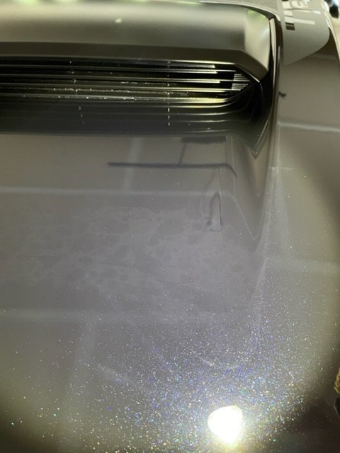

    It not under the clear. The clear milked out from water being trapped under the shipping protective wrap. Heat gun or hot sun will correct it. My brother in law owns a body shop, that services a lot of dealer. He get quite a few of theses in from the dealers. Heat guns them, or if there's a lot of areas. He pulls in spray booth a turn on bake mode.

    IMG_0989.jpg Resized_20220413_152017.jpg IMG_0989.jpgHere is a Brand new Mercedes EQS 580 he just did. Buffing doesn't do anything to correct it.

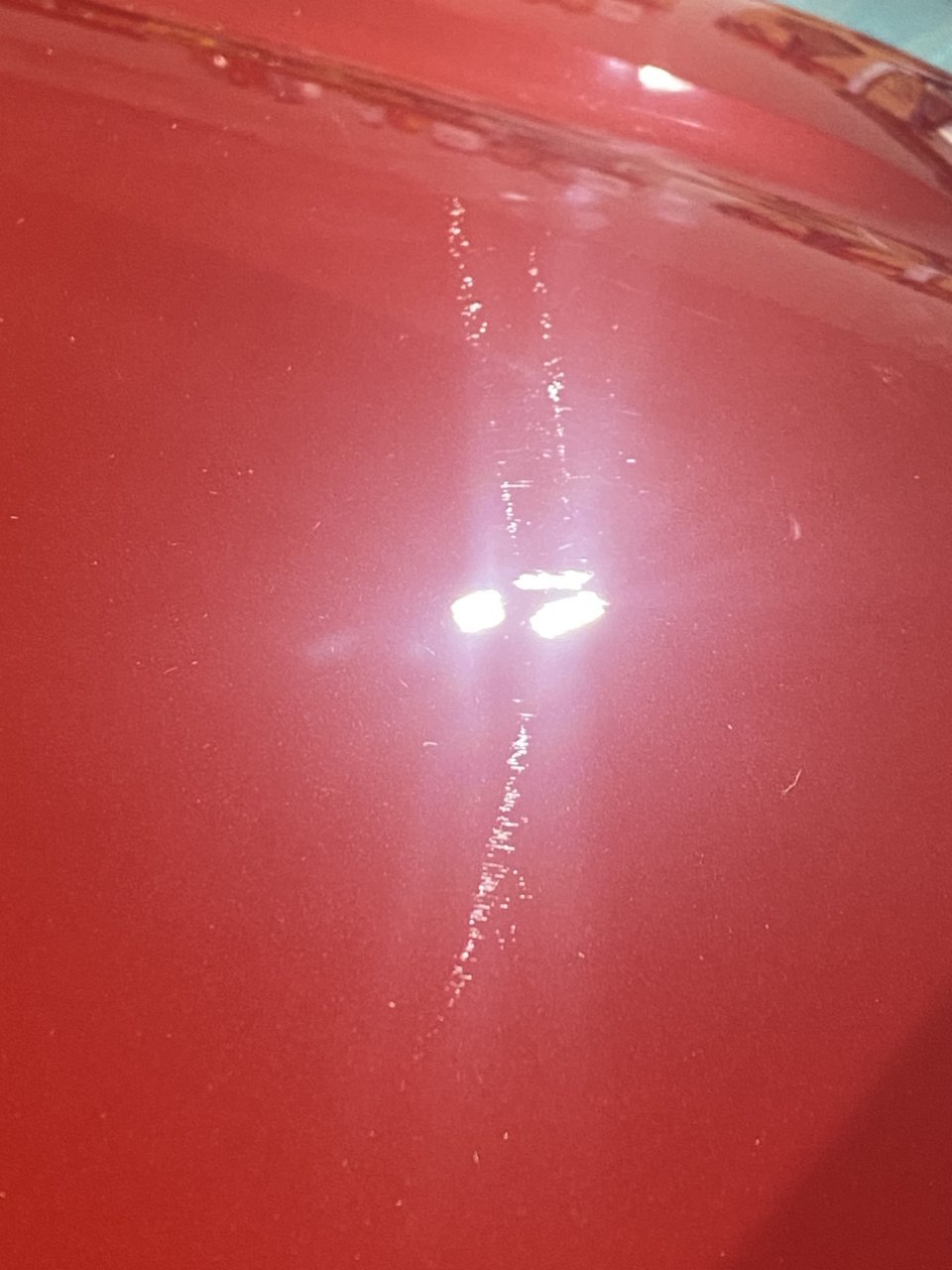

    Yea my hood doesn’t look like that it’s more like a clear scuff mark couple lines about two feet long sweeping across the front right corner of the hood. It’ll try to get a picture. It’s hard to see straight on. But it’s there.

    Here’s a picture of it on the low across angle and one directly over top of it. You can’t see on the over head view.

    Well the after looking at the hood dealer determined they have to wet sand out and repaint/clear coat my hood... That being said by doing do my 3/36 factory paint warranty is void. the body shop will back it up through those years... I said no way,,, what can we do? well they have a exact Tacoma coming in this week they agreed to back out the first sale and let me but this one... I may have been to obsessive over this but i wasn't crazy getting a new truck zI waited for 4 months repainted...
    so in the end it all worked out...
