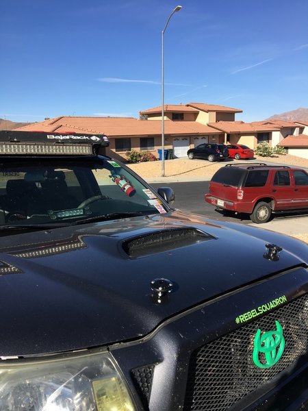

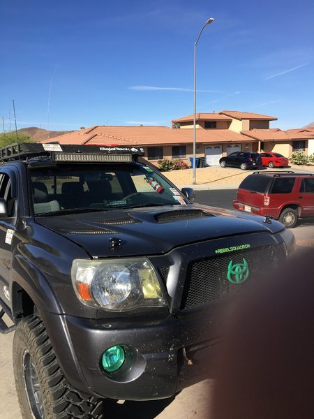

    i live in the High Desert area of SoCal. The wind is stupid and I'd like my hood to stay where it is when I'm driving. I just bought a set of AutoFab hood pins and I'm not sure where to locate them.
    Location 1
    Location 2
    Or Location 3
    I'm thinking 3 is my favorite, but let's see.
  2. May 2, 2017 at 5:27 PM

    #1 will give you the best functional results. The hood latch is holding the center of the hood. If you're having vibrations, then it is most likely coming from the sides of the hood where there is nothing to support it but the rubber spacers. I've done 2 hood repairs in the past week resulting from hood flutter. Go for what works, not what "looks better". Even though IMO, the pins look better off to the sides.

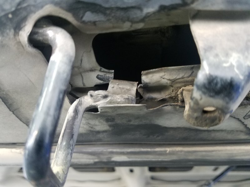

    my hood latch thingy broke a few weeks ago

    Location 1

    Location 1 for sure

    I'm certain that the hood latch threw in the towel on the washboards on Race Track road in DV a fwe weeks ago. I replaced the core support bushings with the poly ones last year this month.

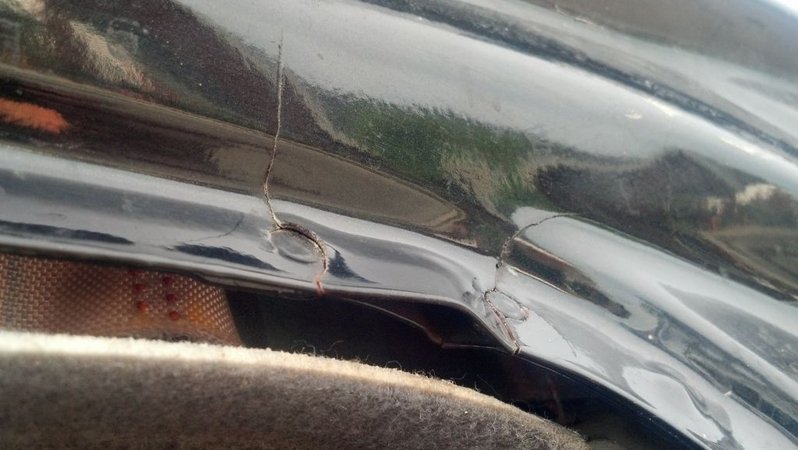

    my driver side inner core is cracked in 3 separate places.. I also have cracks in my rear passenger door jambs in the upper corners
