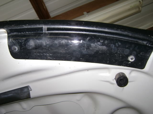

    Hope these are the pics you are looking for.
    Hood down and the bug guard only rest on the rubber, not on the grille itself.
    Extreme close up.
    On the inside I am able to fit my hand in there to clean. Even when it flexes in the wind it doesn't touch the hood.
    It mounts to the underside of the hood, using exhisting holes.

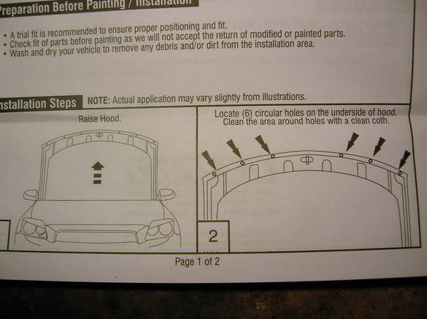

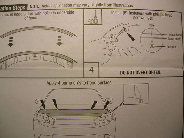

    1. Easy to install: uses spread-type screw in existing holes.
    2.Actually looks pretty-good...
    3.Feels durable w/ a bit of flex.
    4.Again, not as bad as I thought (looks)
    ...and now, a tip or two...

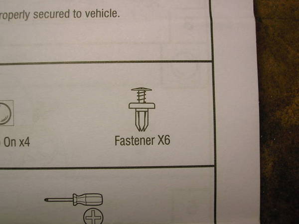

    the connectors have a shallow Phillips-head screw (I mean the cutout in the head is shallow, not the screw length) so, flatten the tip of your screwdriver w/ a file to get full contact (so as not to strip the head). Also, work from the center out b/c, you might have to flex the shield a little to get it to match up w/ the holes. Sorry no pics tonight, I'll try to post some tomorrow. All in all, I'm very pleased so far. I'll also let you guys know how it is under driving conditions.

    Sorry for the dark pics I was racing the sun...
    Oh, and these are the fasteners I was talking about...

    Finally got mine installed..fit great no issues but it is a snug fit on the grill.. like Bones said there is no shake rattle or roll . but be careful with those plastic moly plugs I broke three... but AVS/LUND sent me new ones.. I'm a Happy Camper with my hood shield :)

    No holes to drill, right? That's what I want to make sure of.
  18. Feb 18, 2009 at 10:54 PM
    #38
    BONES
    BONES Well-Known Member
    Jun 14, 2008
    #7320
    75
    SoCal
    06 PreRunner SR5 w/TRD Offroad pkg
    AFE 'Pro-Dry S' OE air filter, Westin bull-nose guard & side steps, TSB leaf pack, TSB intake-hose, rubber bed mat, Bridgestone Dueler A/T Revos, Stubbie 21" antenna, Goodridge G-Stop s/s brake lines
    It uses the existing holes on the underside of the hood.
