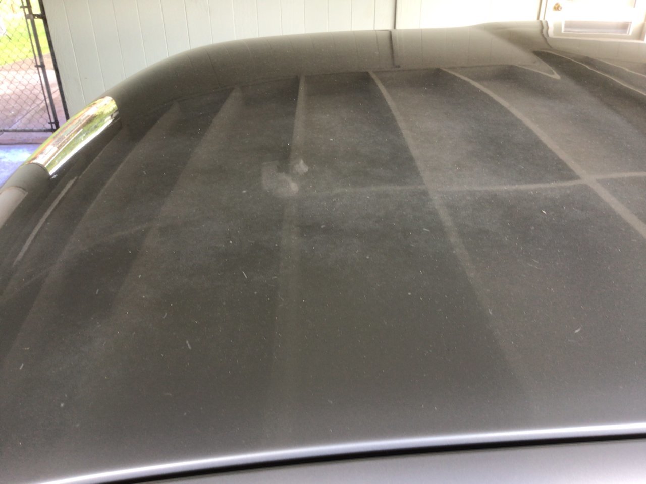

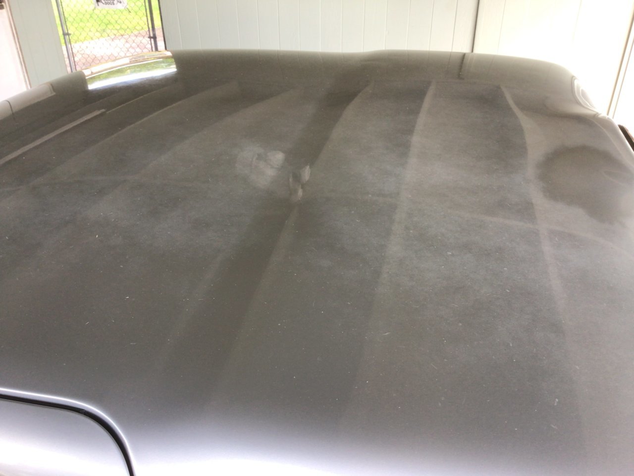

    I know the truck is old. Original paint . There is clouded look on the roof and hood sure if it’s the clear coat fade or something under the clear coat . I tried buffing,sanding, compound . But, only making the clear coat shines . I am starting to to see the base coat paint coming out. Any ideas…..try many different things with no change. Picture is not greatest but, you get the point…..thanks guys

    My 2013 is doing this but worse, if it’s what I think is happening that is. It’s Hard to judge by your photos, but I believe your clear coat is flaking off or has separated from base coat which will in turn lead to flaking/pealing off. I wouldn’t do any more rubbing up there, of any sort. The only thing I do to my hood and roof is spray down with a hose as any sort of wiping, even with a wet soapy microfiber, only makes things worse. Repainting is most likely your only option, which I what I’m going to do in time.

    Yes, you’re right it’s under the clear coat. The best thing to do is sand off the old clear coat and respray the base coat. Need to find a body shop willing to do it. Many won’t …..thanks

    Common clearcoat failure.
    There are options, depending on your desired result and what you want to do with the truck.
    High-ish end professional repaint. $$$$
    Budget repaint (Macco, etc., ok for a couple years) $$
    Smooth up the existing surface and wrap it. $$$ for a pro, bit less if you prep and they apply
    Smooth up the existing surface and treat it to something like www.monstaliner.com. $
    Let it go till it gets rusty, clean it good, spray with clear coat and join the 'patina crowd'. :D
