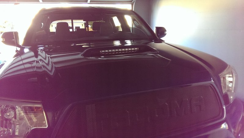

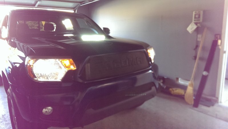

    Were you able to adjust the light to close up that gap on the backside of hood scoop? I've run into the same issue.

    Finally got around to installing this great bracket and light....really, as long as you take some time while cutting out what needs to be cut, you'll be fine. I've NEVER wired anything into any vehicle, and I was able to figure it out. So yeah. Thanks again to C4 Fabrication, and Avec Lighting!
    Forgive the sketchy photos, my phone is not cooperating!

    The supplied washers are supposed to help hold the scoop up from sagging and high enough to close the small gap between scoop and hood. Im sure not all installs will fit exactly the same on each truck, but I didn't end up with a gap on the setup I did. That is the unfortunate part about the plastic scoop on the 12+ Tacoma's. Once you cut out the opening in the scoop, there isn't much strength left in the plastic to hold itself up. I have not come up with a different way other than a couple washers to help hold it up. Some people probly wont notice or even care about the possible small gap where the scoop meets hood, but for those who this might bother, im not sure how to completely remedy the issue.
    And thanks for posting pics grdgz97!
