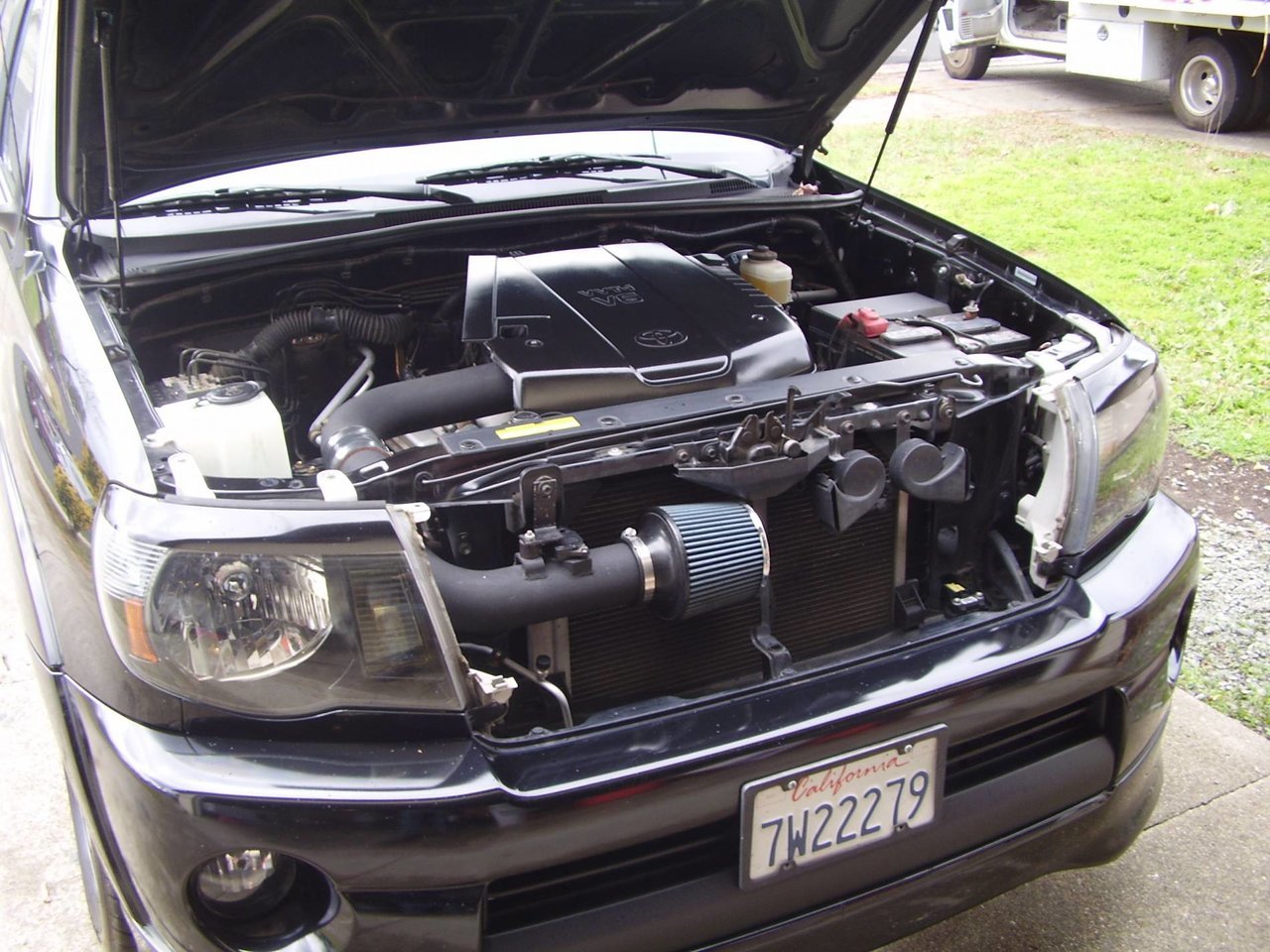

    I wonder if it would lower the overall temp of the engine bay and whatnot. That could be beneficial...

    There was a guy on TN who did it. He actually made sealed ducts direct to the air intake box so the Neg. pressure from the Grill air coming in didn't have any effect on the intake.
    Since the stock intake sucks air from the right fender, he needed to close off that port.
    IMHO, it's not worth the hassle.

    Actually, the air comming from the gril is high pressure, when the vehicle is in motion. By doing what he did, his engine is now working harder to suck the air from the scoop, as the scoop lies in a low pressure area of the hood. The factory location is actually a high pressure, and a cold air location. The only intakes that have shown a dyno gain over the factory location, have been the TRD, and the URD. Everyone else I have tested has shown the same (or within the margine of error of the dyno) or less.

    Different hoods with scoops in different positions.
    There have been several threads about this topic with photos and full research studies about pick up truck air flow. There is a low pressure point there.
