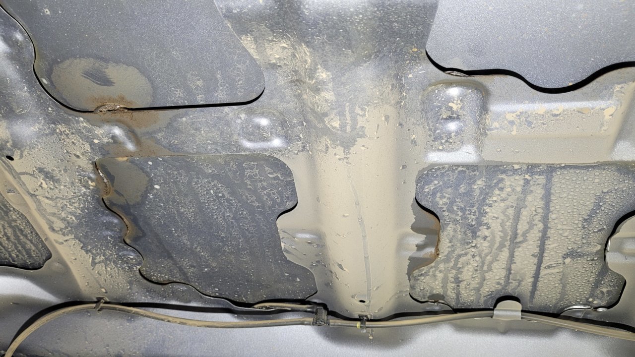

    noticed that this foam that spaces the support longerons from the outside skin which also appears to be painted over is deteriorating and seems to be excreting an oily substance that causes dust to cake (yes i know my hood is dirty). what should i replace it with?

    So to actually answer your question. That is foam glue they use from the factory to stick the hood skin to the frame. Its shit glue and it fails causing the hood to flap at highway speeds. Toyotas fix is to put more glue in and make it look like a 3rd grade art project.
    Leaving it the way it is has no downside except your hood will vibrate a bit (no sound, just the skin moves a bit) on the highway.

    Yeah what @5nahalf said. I was aware of the issue and had the dealer fix it straight away, but they did a good job on mine. If u get the dealer to fix it, make sure they use a flexible glue, or it'll dent where ever the glue flexes.

    preferably id like to just get my own and apply it myself. it appears to be like those insulation foam for houses but way softer

    It flutters ever so slightly, its not a ton, but due to angle and gloss of the hood it becomes annoying. I doubt the hood skin is going to fail at any point due to this otherwise they probably would of issued a recall for it.
