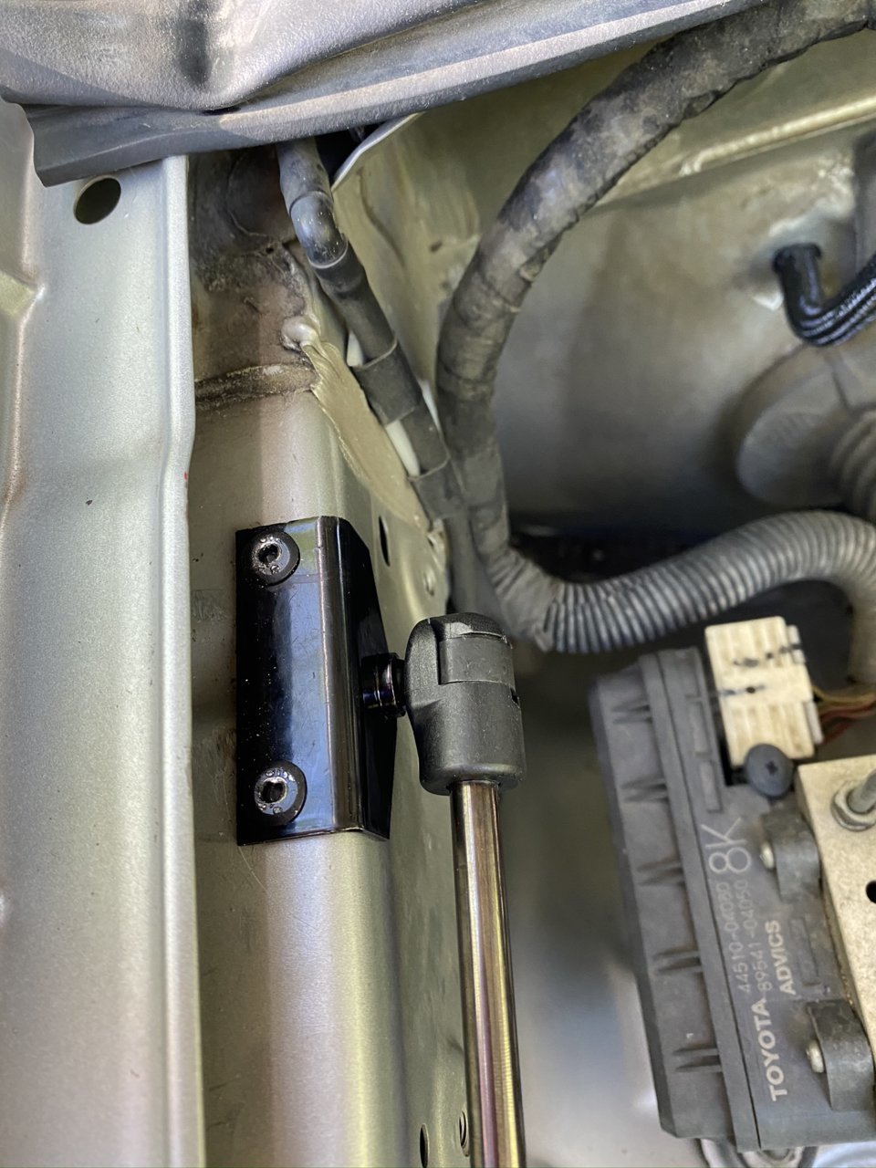

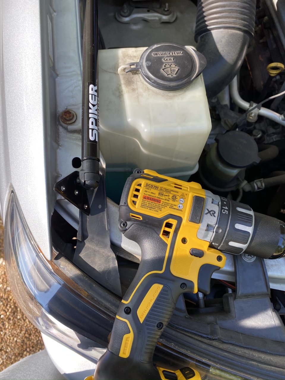

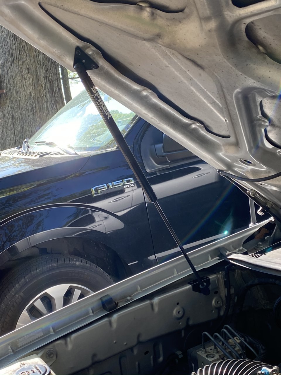

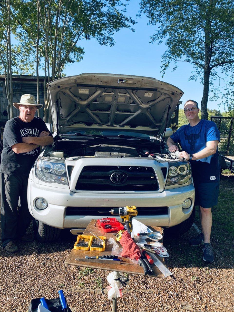

    Got em installed. For anyone with a 2nd gen, you will have to either have a small enough head/nose of the rivet gun to clear the fender bottom bracket or do what I did. I loosened the brackets holding in the fender and my dad pulled them back some while I gave the rivet gun hell to get these installed! It was a JOB. Also, the instruction manual does not have great pics. Taco Twonz’ video was the best for me. I just went with the stock height for the struts as it was easiest, and that’s high enough for me. The video by that Timmy guy is not very accurate and he doesn’t give good reference points for the brackets like Taco Twonz does. For me, a video is worth a thousand pictures. Either way. They are installed without incident and they are working and boy is that hood light now! I wasn’t able to get the spiker engineering logos facing outwards but oh wells. And I also kinda didn’t apply the touch up paint on the first bracket but oh wells. Even when I applied it I’m not sure I let it dry much. Showing pictures that hopefully show u some location points if you have a 2nd gen ! Made in the USA baby.

    Guy on the left looks like my twin - Tilly Hat - glasses !

    @george3 Ha really? That’s my dad. Providing supervision. Post a pic to compare !
