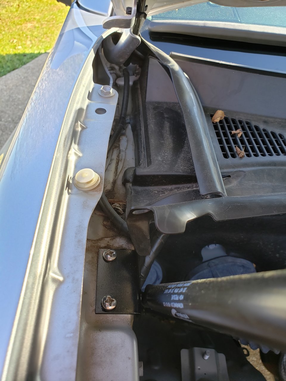

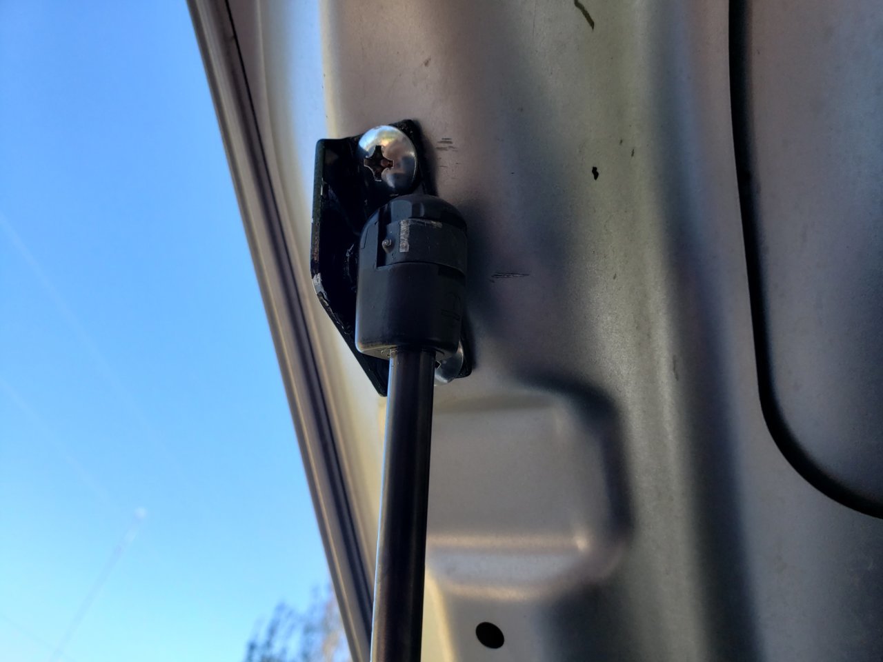

    Cannot find the original thread about hood support to bypass the hood prop stick.
    Noticed many looking at the Red Line setup but I found the parts for a lot less and was surprised at 60% less.
    Austin Hardware had everything.
    Previous posts has this site below siraweb but they sukc!
    Don't use https://www.siraweb.com/gas-props#/pageSize=100&viewMode=grid&orderBy=0&pageNumber=1
    I could not get anyone to return phone calls when I had questions about parts.
    I called and had to leave msgs with an answering service even spoke with Alona the manager or owner and she didn't call me back either! They have problems, if you have an issue who is going to fix it and take care of your order. NO ONE! Bad first impression.
    Austin hardware had a small issue, sent me out replacement bracket right away!
    https://www.austinhardware.com/
    Part list:
    They only had the AH 16340 in stainless steel, I would have bought all ss for the GSH bracket too.
    2 x GSH-851 - Small mounting brackets 10mm ball - Go on hood. $4.92
    2 x AH 16340 ss - Mounting bracket 10mm ball, 90 degree bend 2"
    holes 1.5" center to center. $6.46
    2 x GSS 6306UK - 49 lbs force, 23" extended. $25.90
    Shipping - $12
    $49.28 and 30 mins of time.
    I sprayed the brackets up in black so they wouldn't look shabby after they are weathered.
    I used stainless flat button sheet metal screws but will change these out for rivets
    but I didn't have a rivet set at the time of installation.
    It lined up nice and works great.
    This solution is a lot less than the Red Line option and provides the same function.
    Hood bracket is 11" up from the edge of the hood support. You can place it in front or past the indent notch.
    Now you can place the brackets where you like to have the hood open lower or taller. I chose open more to have room if needed. Some may not be able to reach the hood on a 4x4 so lower may be your choice.
    Base bracket is 4" from the firewall seam. Line up and mark.

    Pictures and measurements added.
