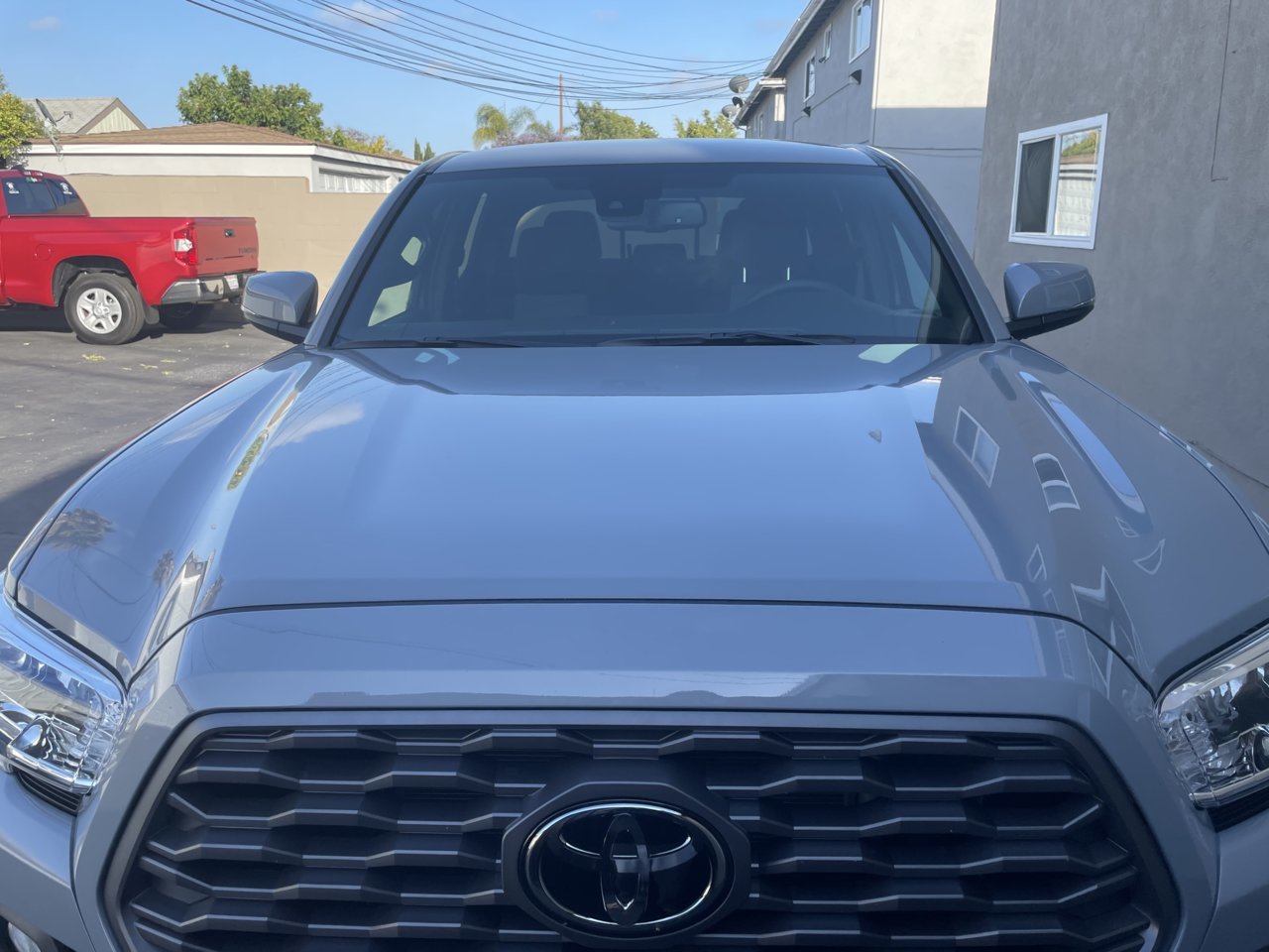

    I purchased a new off road in cement. Im looking to trade with someone with a hood scoop. Im located in Orange, CA. Also can we purchase the hood scoop from Toyota dealership? If so does anyone know how much? I called one yesterday and they said they dont sell it. Thanks

    You need a whole hood. The scoop is not a separate part.

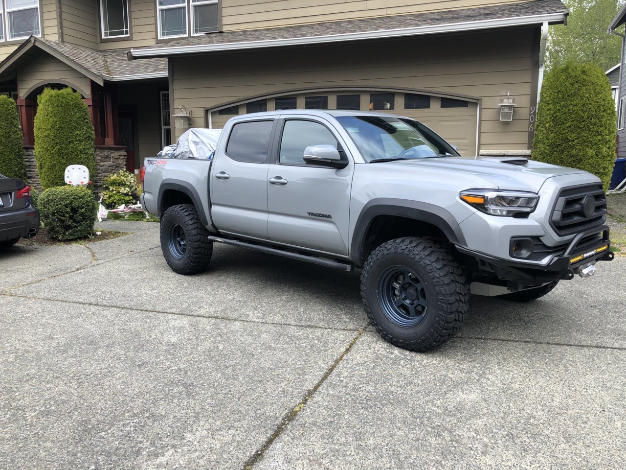

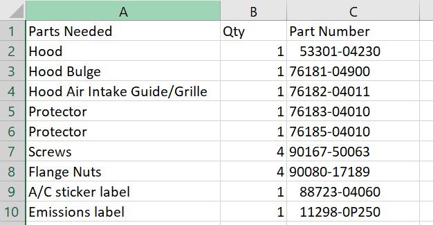

    Here is the parts I purchase from Toyota and then paint/install from the body shop
    was around $700.

    Yes, but you cannot just mount those parts to a off-road hood and be done. So essentially you need the whole hood.
