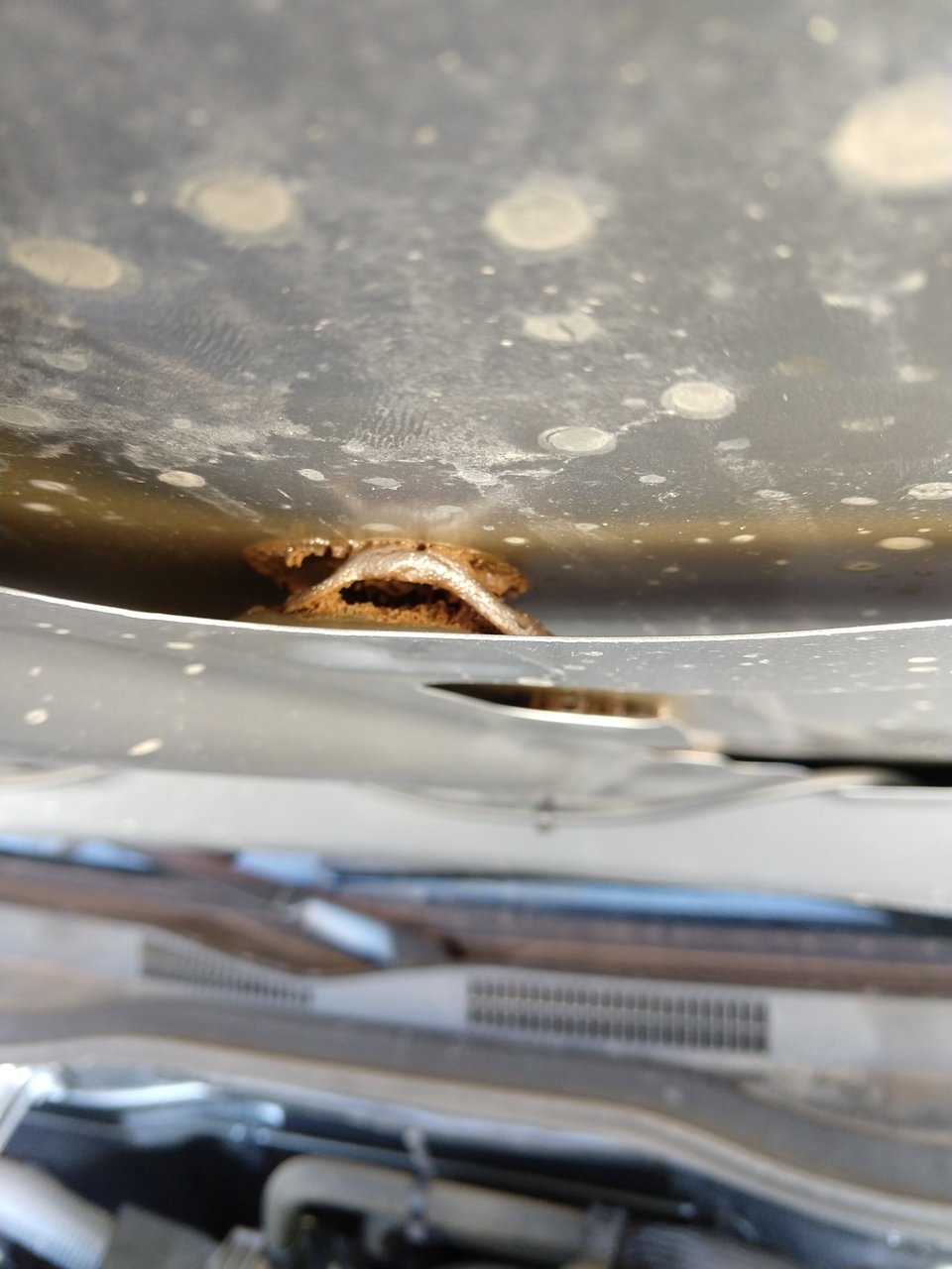

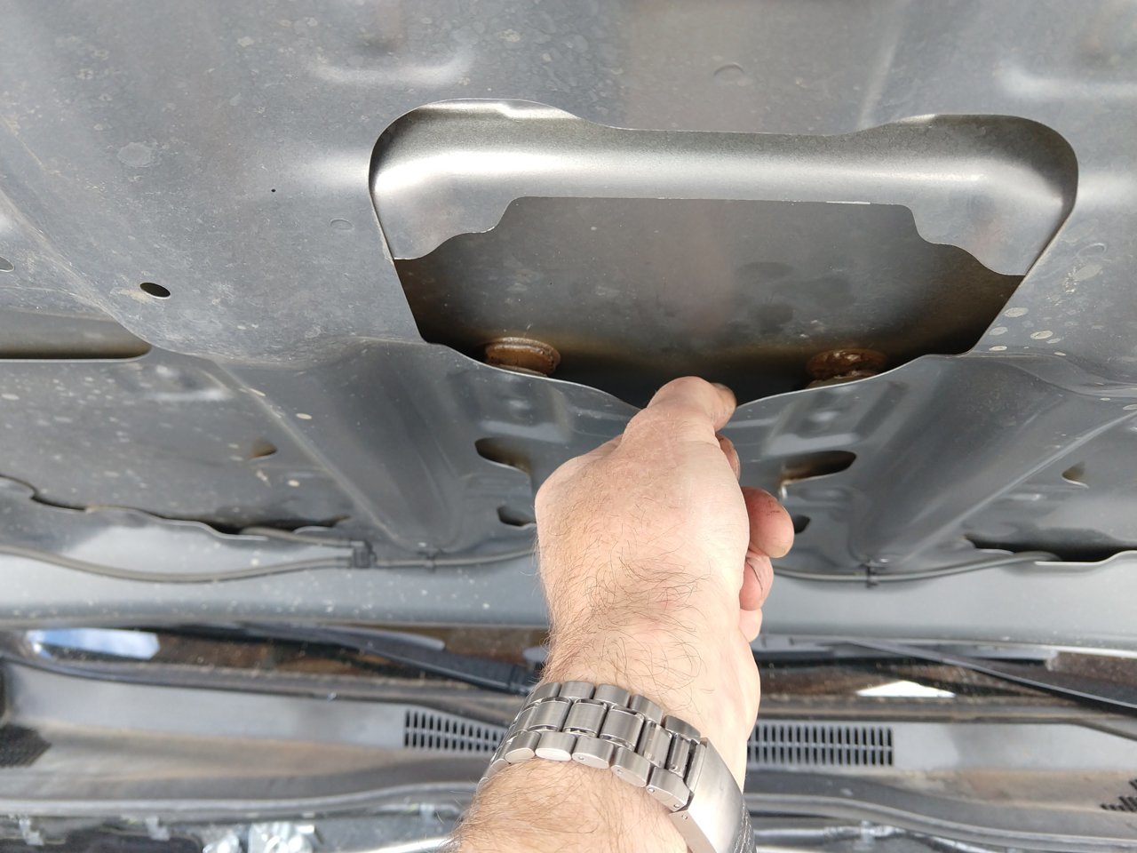

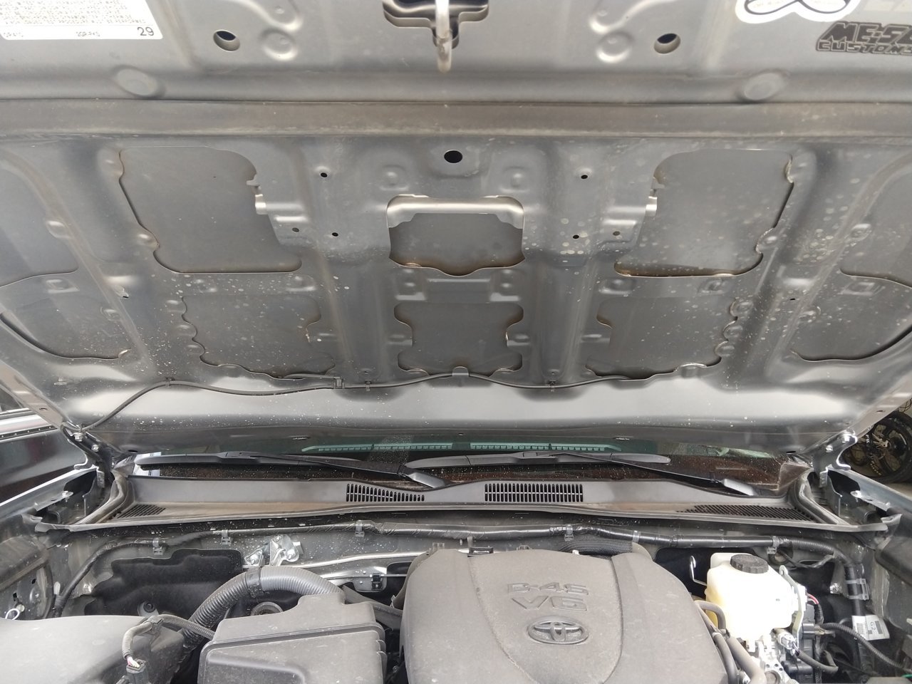

    Hello everybody!
    I hope that yall shook your trees already this morning!
    Has any of you 3rd Gen owners had a problem with the hood un-bonding? How was your specific dealer action? Here is my hood after 25k now and the factory glue is separating and the hood flutters more than it ever has now.
    My local dealer is Pueblo Toyota, which is 1.5 hours one way.
    Thanks!

    The support in the inside is pulling away from the hood skin. Not yet, though I have more hood flutter than before.

    I got the OK to go to my local body shop and get an estimate to have more NVH sealant installed, and we found more places that have the OEM sealant failing. The guy I talked with has a 2nd Gen, so that's a plus.
