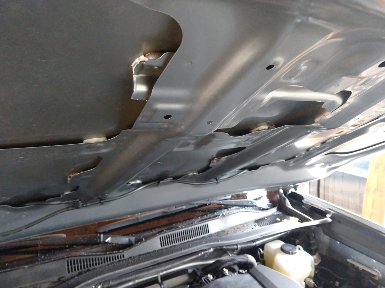

    We know that this a 2nd Gen problem and now infecting the 3rd Gen. I know 3rd Gen TW members have installed sealant under Toyota warranty with and without painting the hood, some have got a new hood under warranty, and some did the sealant themselves.
    My specific question on my first post was if any Co 3rd Gen owners have had their local Co dealer do the repair. A friend wth a '18 3rd Gen SR5 has the stock sealant already failing.
    The person I talked with at Pueblo had not heard of the situation before, not her fault, and asked her fellow employees. Yet she emailed me Friday asking for my local body shop to email her the quote to seal the hood. The guy at the body shop knew about the correct sealant and this is a situation with other makes, not just the Tacoma.

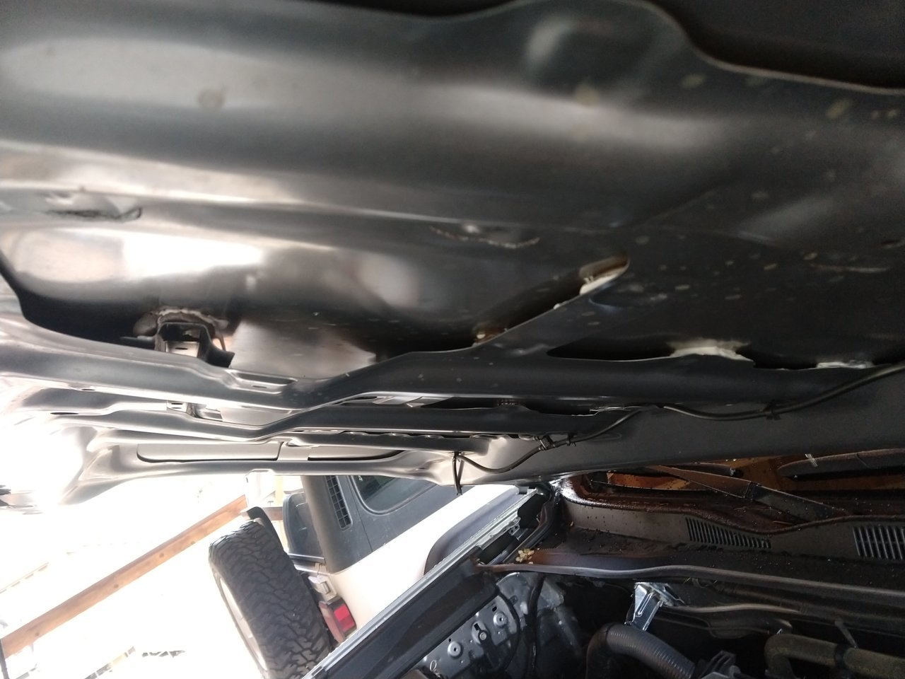

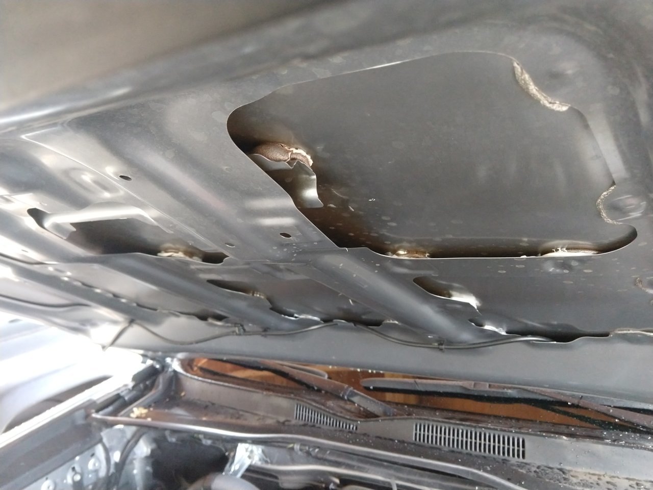

    I'll see how long this repair lasts, they added sealant in between the failed stuff.

    Did you do that or was that the dealer repair?

    Dealer request, post 22, to bring the truck to my local body shop for the repair. I live 1.5 hours one way from Pueblo Toyota.

    I'm not an adhesives engineer but I would be suspect of squirting glue in between already failed spots of adhesive to fix it. My truck is in getting the hood "fixed" and I am going to come unglued if they do the same thing to mine. Toyota is really falling down on the initial quality
    Check any adhesive you have and see if any of them say to squirt a glob right onto a failed substrate. :facepalm:

    This is the first step through Pueblo Toyota warranty. If it does not hold up, then its between the body shop and PT.
