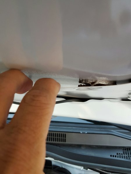

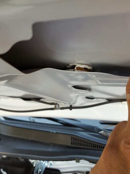

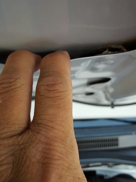

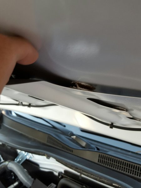

    Mine as well. Hood has vibrated on the freeway since day 1. DCSB TRDOR AT 4wd
    20151120_153703_resized.jpg 20151120_153712_resized.jpg 20151120_153716_resized.jpg 20151120_153652_resized.jpg
