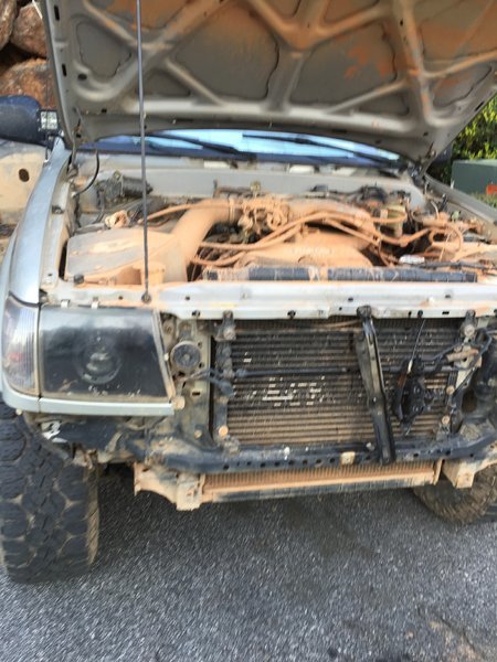

    I had to take everything off so I could take the grill off. Once everything was off the grill came off in 2 seconds.
    I think my spring on the mechanism had some stuff on it that wouldn't make it keep tension (poor choice of words haha). I cleaned up the mechanism and the spring and it's been working fine. So I just think mud got in there and messed stuff up

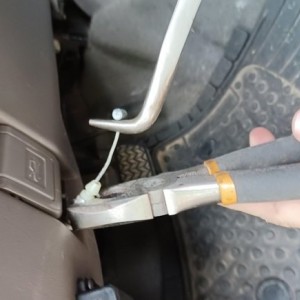

    Pulled cable off the flip-hinge and pulled using two pliers. (need both or you will just yank the entire cable - pull both directions)
    Cable slack was huge. Cable needs to be replaced. This worked for me.

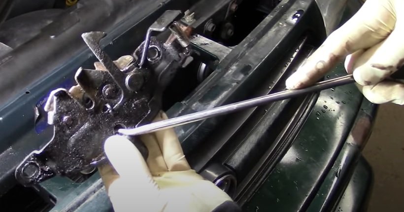

    You can use this crazy awesome trick: https://www.youtube.com/watch?v=WOzUAfmDi6o
    Drill a hole above the bump, and use a pry to unlatch the hood. No need to disassemble anything.
