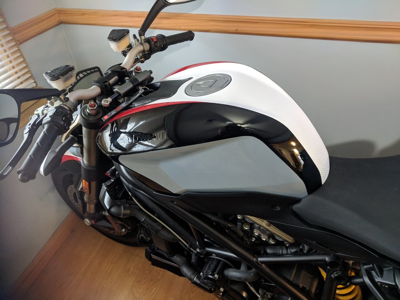

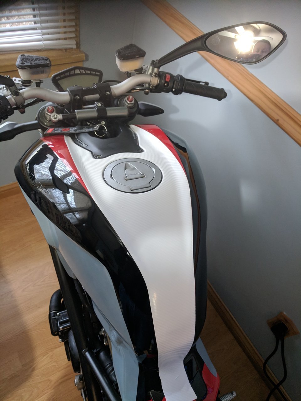

    Wrapped a few car, trucks and my motorcycle. These newer vinyls don't really need soapy water. They do not really stick down until you press them down with a squeegee. So you can place and lift, place and lift a few times.
    Don't stretch the vinyl very much. They tend to thin out and then you wind up with the sun burst wrinkles you were talking about. Yes heat is a friend, but like stretching, it thins it out. I have been able to shrink slightly over stretched vinyl back with heat. But it only works for small areas....like 2"x2".
    The knifeless tape from 3M is great stuff. Lay it first. But leave 6" hang out each end. Sometimes the line breaks before you can cut the vinyl, and your left with a very tiny amount to make a clean cut. Very hard to do. When it comes time to cut it. Split the cutting tape line, and fold the string over the top of the line still under the vinyl, with about 1" of loop hanging out... Like a loop for you shoot laces. Then place a finger over the edge of the vinyl where the cut is to start. Then pull, and don't lift your finger. Makes the vinyl stay in place, and not cut jagged.
    Hope this helps some. I don't think that some of these hood scallop vinyls that others are showing are any easier to put on. They would need the soapy water treatment.
    Here is a pic of the motorcycle tank I did. Took me 4 hours to do just this.
    So it can be done. Just take your time!

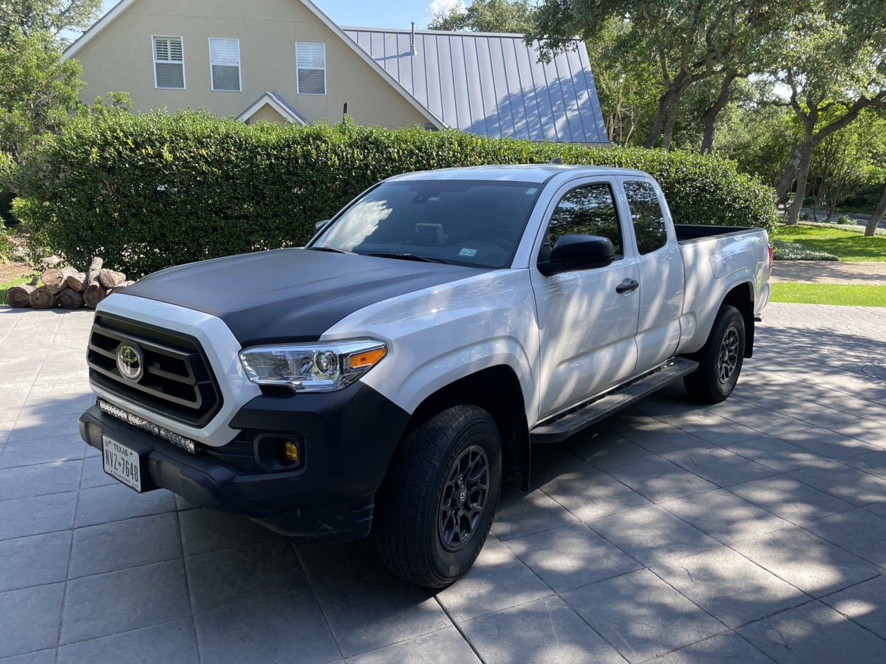

    Just had the hood on my utility SR done to cut the glare. Seems to flow well with my unpainted bumper. Might even help shed the pool-boy look.

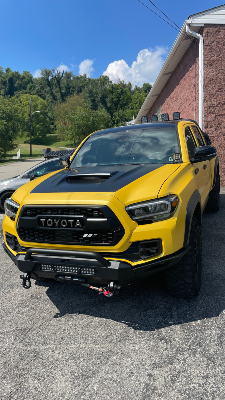

    Not sure exactly how they did mine, but here's my hood.

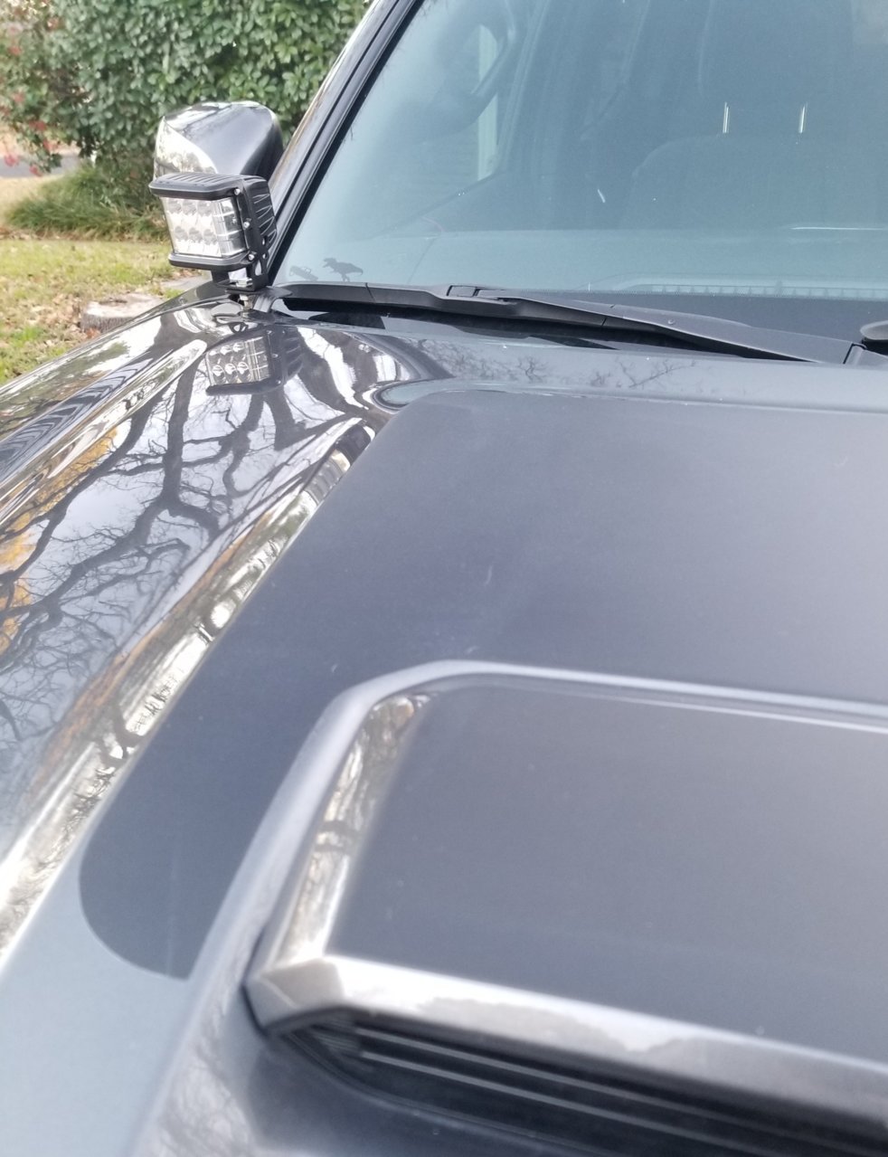

    i went with a company i found called supdec online. they have an ebay store, an etsy store, and a website. i emailed them about and existing design and i got what you asee in my thumbnail. i will say, it lasted 2 years. i recently removed it. i'm going to have it redone locally with some higher quality material.
